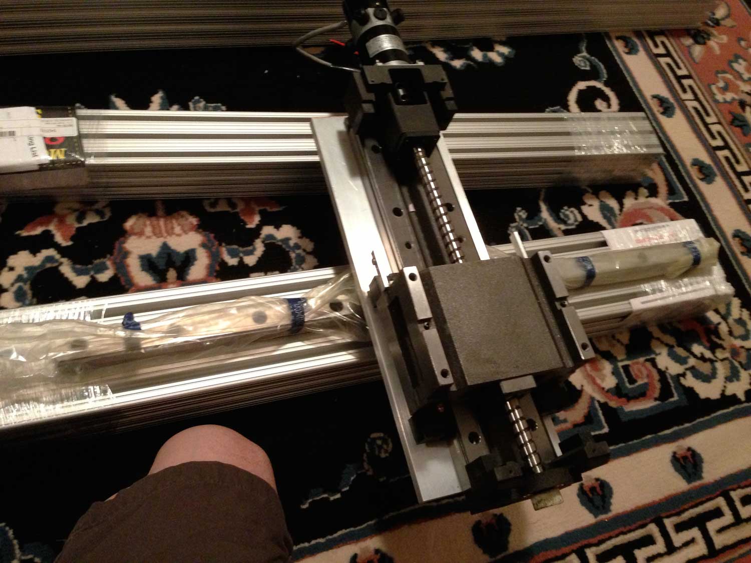

    Combine both below, add anti collision torch holder and you have a winner.
    This floating head looks good. But only the floating head.
    thats good looking wide linear rail and block single rail Z axis.
