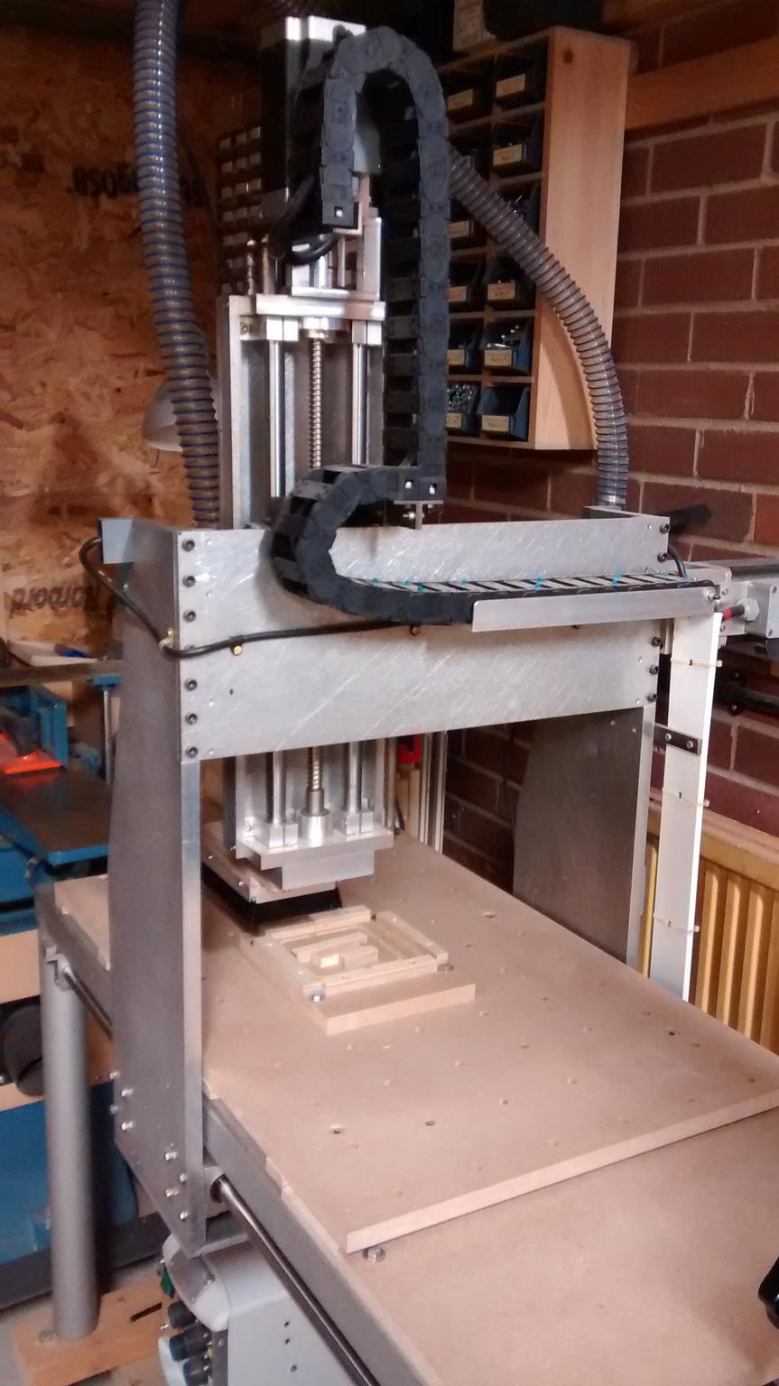

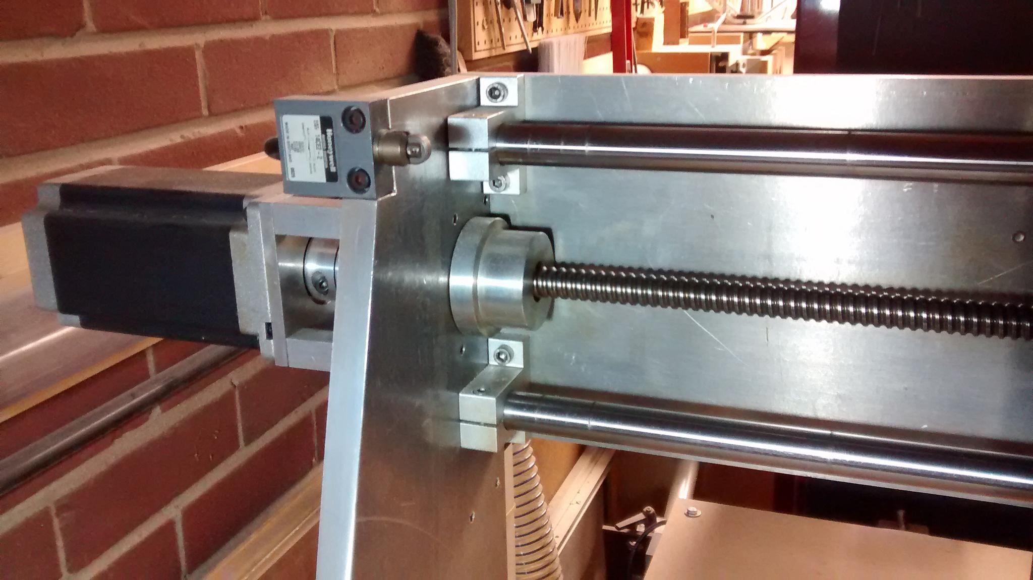

    In terms of the machine, I have some rather poor pictures - see below - which hopefully at least show you how each axis is made up. It is an unwieldy thing, with a too-high gantry and uses unsupported rails throughout. I could make many excuses for this - but the one I'm sticking to is that it wasn't designed nor made by me - I took it on as an unfinished project. And it wasn't originally supposed to be a router - it was a welding machine! Hence not ideal, but hopefully I can do something with it, which doesn't involve starting again....
    As for how the errors have come in - I measured a circular item I made right after commissioning a year back, and it turned out to have the same error in it. So it was only when my application required accuracy, that I noticed this sub-millimetre error - it has always been in there.
    Graeme

    Hi Again,
    If you have any twist in those gantry rails it will be magnified by your lanky gantry. If you clamp a large engineers square to the gantry side, you will see by running a DTI fixed to the Z, along the edge of the square whether there is any twist you could shim out.
