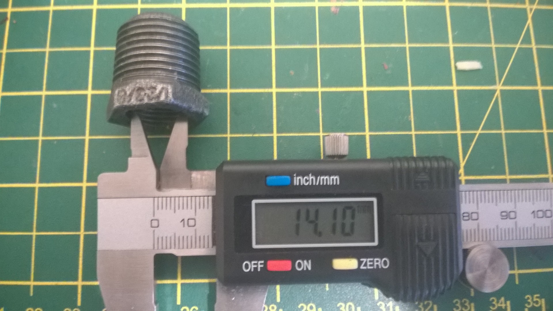

    I bought some :
    BLACK MALLEABLE IRON REDUCING PIPE FITTINGS BSP - SOCKET, BUSH, TEE, HEX NIPPLE
    ( 111520014759 )
    Fitting Type: REDUCING BUSH
    Size: 1/2" x 3/8"
    When they arrived I was surprised my 3/8" male threaded pipe didn't fit ?
    So I emailed the vendor and said although you have 1/2" to 3/8" stamped on the Bush its actually measures 14.1 which I think is 9/16 0.5625 or 14.2875mm well near enough.
    Anyway I emailed the guy and this was his reply
    hi David, there is no such size as 9/16" , the fitting is correct just check . (there is sizes cast on fitting one side of hex part)
    1/2" X 1/4" bushes have a inside 11mm if any better for you.
    Here's me thinking 1/4" was 6.35mm ?
    I'm confused
    Pic attached

    Hi there,
    they have sent you a 3/8 fitting, the fractional inch number refers to the inner diameter of tube that would have once screwed in the fitting(back when pipe was made slightly thicker)
    confusing isnt it!

    Just figured that out before u posted lol thanks anyway :)
    Now I need to reduce again from BSP 3/8 to a normal everyday 3/8 thread ..any suggestions well more like what the hell do I buy ??

    *** ok no need to answer ... I now realise that BSP has nothing to do with normal sizes ..WHY CANT THINGS BE SIMPLE !!!

    Could you clarify what you are trying to fit to what? Somehow from what you've said you I don't think that you will find an off-the-shelf fitting but if we know what's needed it will be easier to advise. For example, is your "normal everyday 3/8" thread" UNC, UNF, BSF, BSW? Not to mention the finer threads in the ME series... Or maybe nearest metric size? It's all a bit of a rat's nest
    BTW, I don't know of any thread where measuring the inside of the thread (as per your picture) will give you a recognisable dimension. Usually threads are measured over the outside - in effect, the diameter of the rod that an external thread was cut on. You can use internal diameter to find actual thread size but you will need to know what you are looking for in thread tables (possibly core size, give or take a bit of clearance).

    Ok Neale thanks for the reply, I'm trying to get to a point where I can screw in a 3/8" bolt to the bush after I've ground the head off and fit it into a chuck capable of taking up to 13mm. if that makes sense ?

    Have a look at https://www.bes.co.uk/products/160.asp. You might find something like an end plug you can drill and tap to your 3/8 bolt. Maybe you could just weld or braze the bolt on.
    Oh the joy of BSPP BSPT and NPT. You can learn more at http://www.newmantools.com/taps/bsp.htm

    Hi Rob yep thought about these methods but if it out of center it would cause problems, I might take them into the local iron mongers find the right bolt and then find some kind person with a lathe to turn one end down to 10mm.. path of least resistance etc.
