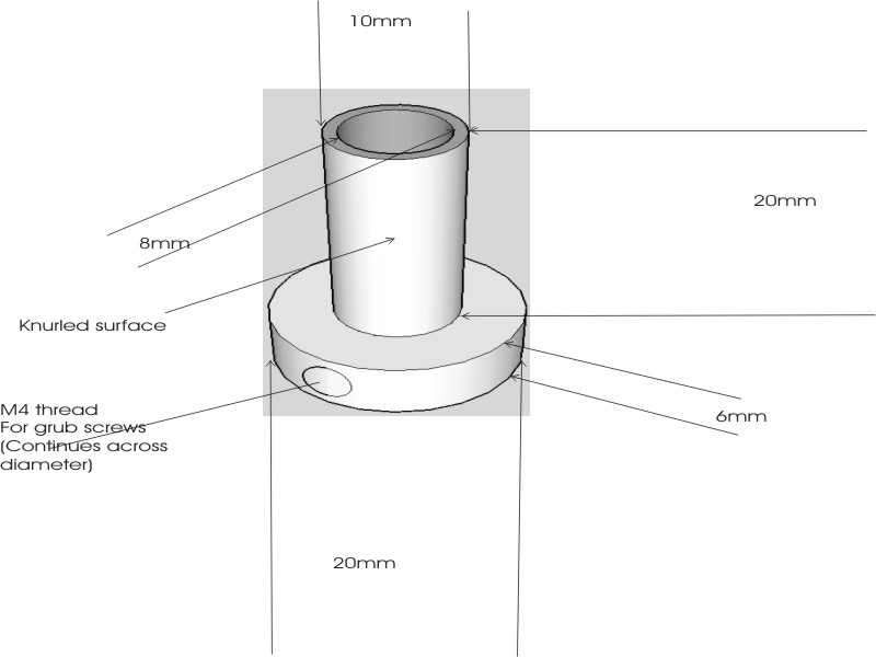

The piece is made in brass and is to be bonded into a small glass sculpture so that it can be mounted to a wall by a single point.
What would be even better if anybody knows of any fitting that would do the job and can be purchased. I will need about 100 of them.
