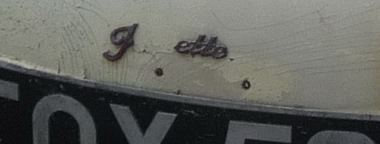

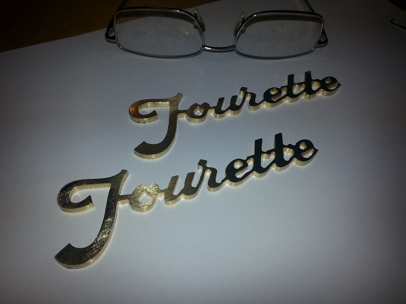

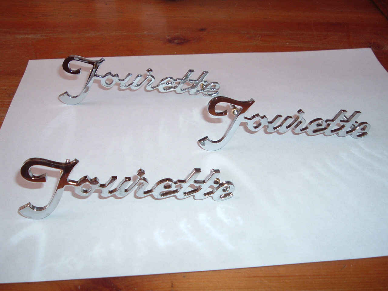

    This is a car badge that I struggled a little with pick up on the tool, it seemed difficult to get enough feed rate. I have no coolant set up which is probably the route cause. I was thinking it would be easier to swap the Makita palm router when needed than introduce adequate coolant.

    The badge was a repair for a friends Micro car.
