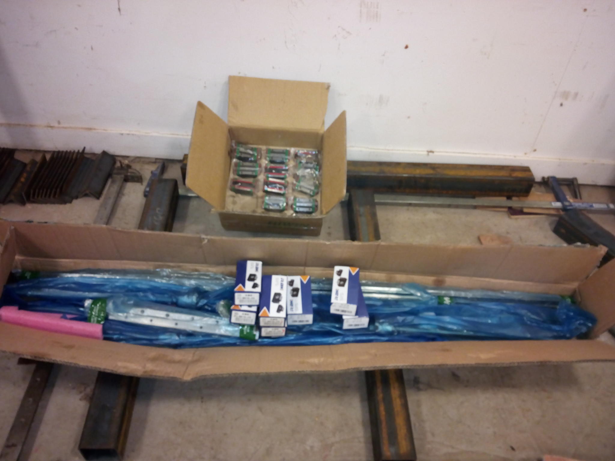

    Some progress to report. I have ordered the Rails and carriages, ball screws and bearings for the XYZ Axis from BST Automation. They say 7 Days to deliver - that's a bit frightening!
    I have ordered the steel for the frame, all cut to size. (I have trouble getting 7.5 meter lengths down my lane, it has a sharp bend on it and hostile neighbours).
    I think I'm ready to order some 20mm aluminium tooling plate which I think I will have cut to size. (extra £20) I have large bandsaw and TCT saw and cut off saw but I think first time I'll get them to do it. (They say +/- 0.2mm accuracy).
