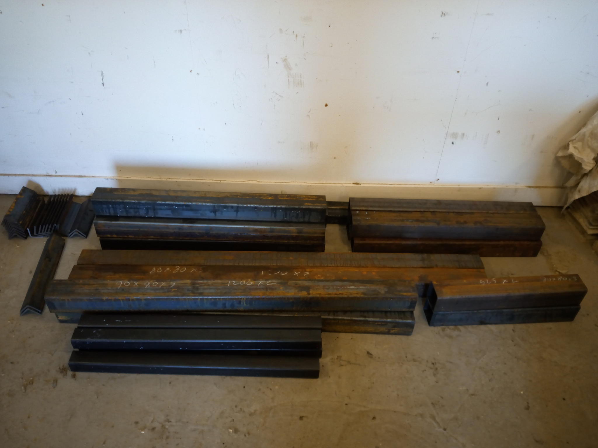

    Steel arrived today, all cut to size, so drilling and tapping first, then brackets, then welding.

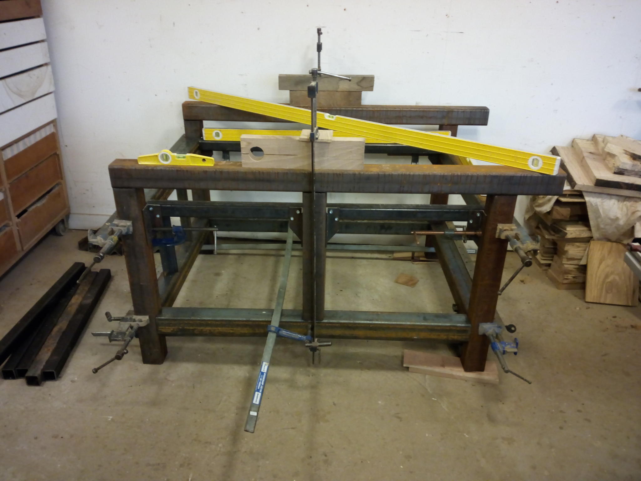

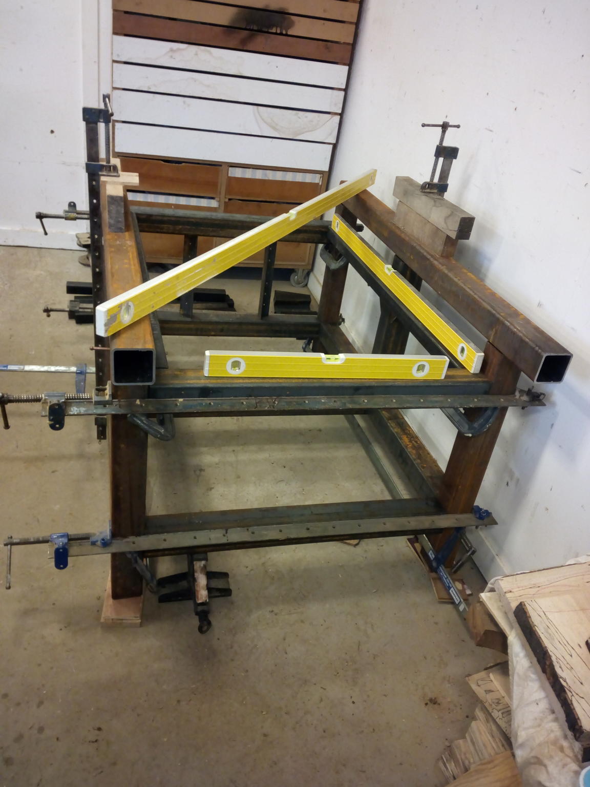

    Progress today, trial assembly, finding the the workshop floor slopes about 30mm over the length of the machine so good job fitting levelling feet.
    Cheeking and marking out the moving bed and brackets. Its going to move down by 100mm amounts. I can not think I would want to move it in lesser amounts than multiples of 100mm, unless you people out there no better? (Z axis should have about 220mm travel.)
    Just ordered 1500 screws which sounds a lot but I've worked out I need 340 so far and given that they come in 100's or 200's multiplied by the size and length combinations you end up with 1500. I think I will still need more yet.

  3. I'd give yourself a bit more room against the wall if you can... I have built mine too close as I have maxed out the size of machine for my tiny workshop - it's a pain in the ass not being able to get to all sides!
  4. Looking good though - are you planning on including any bracing or haunches?

    Yes Joe, I will be giving it a bit more room, I have more clearing and moving to do to make space, you will see as the build progresses where it will end up. Plus you need room to role the frame over to carry out the welding. I'll be moving it around on a pallet truck as well until it ends up its final position as I expect I will have to take a break from building it, to do some work in the workshop.
    Quote Originally Posted by JoeHarris View Post
    Thanks, yes as per the drawing, today was just a trial clamp it all together and marking out day , its all dismantled again for drilling and tapping and welding ends and feet plates

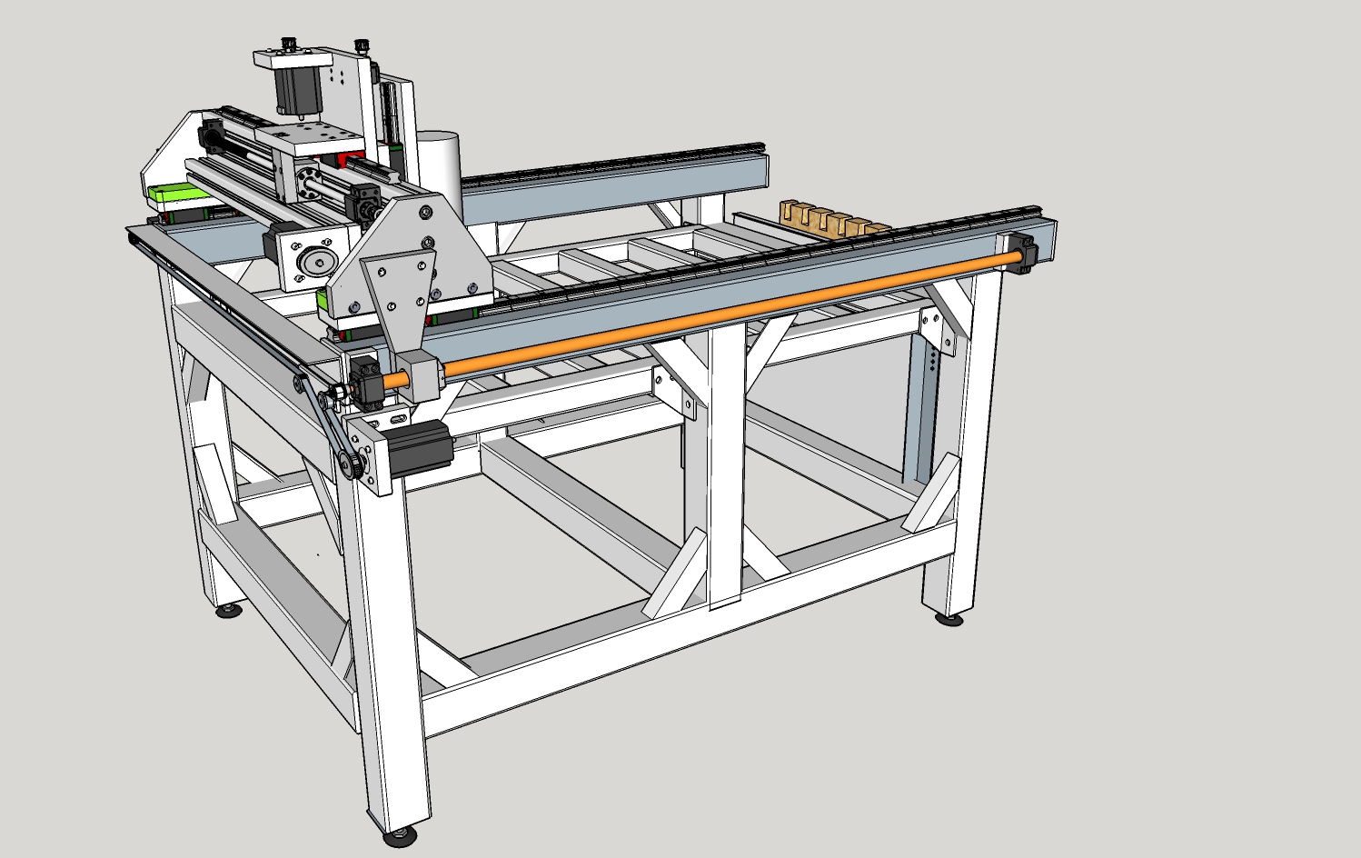

    Bit of a redesign due to cocking up the order for the length of the RM2020 1400mm should have been 1500mm long.
    Hope I can still get 1/4 sheet cutting area (1220mm x 610mm)
