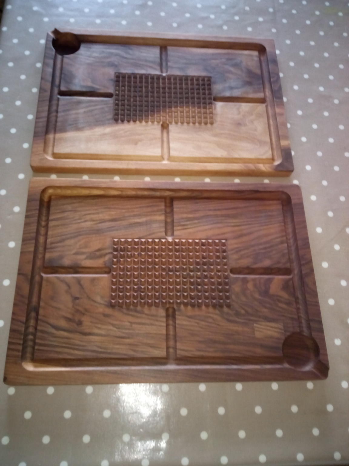

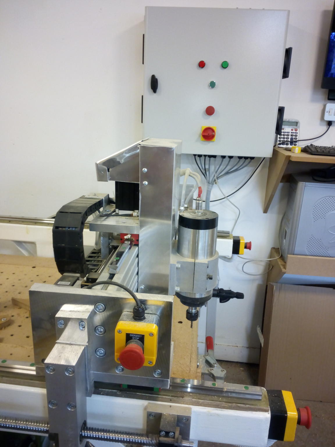

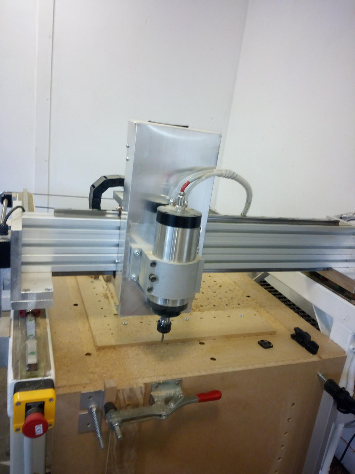

Thanks Nickhofen, yes I have, but been very busy with other things so not had much time on the CNC. I made the dust cover for the machine Z axis in aluminium sheet on the machine but it did not cut great but scored well for folding. I think I should have scored it all out and then cut it with air shears as you get a cleaner cut on thin sheet.
I have also made cam clamps, jigs and fixtures for the machine and first paid commission job was the meat board with wooden spikes in English Walnut. I think it would have been very difficult to do the spikes conventionally with a router.
I've also done some dovetails which is what I built the machine for and will post some pictures when finished.Click image for larger version.
