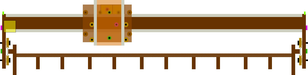

    Real Crap Basic idea of what i'm looking to do.
    In regards to general shape and approx motor placements, bearing guides etc.

    My end goal is to have a vertical sheet sized machine (not any time soon)
    I'm prototyping with ply (had plenty) but have seen them seemingly made from MDF and sold?
    So i'm aiming for some sort of inner repeating pattern to establish rigidity without excess weight.
    I'll keep every comment in mind as i muddle through.
