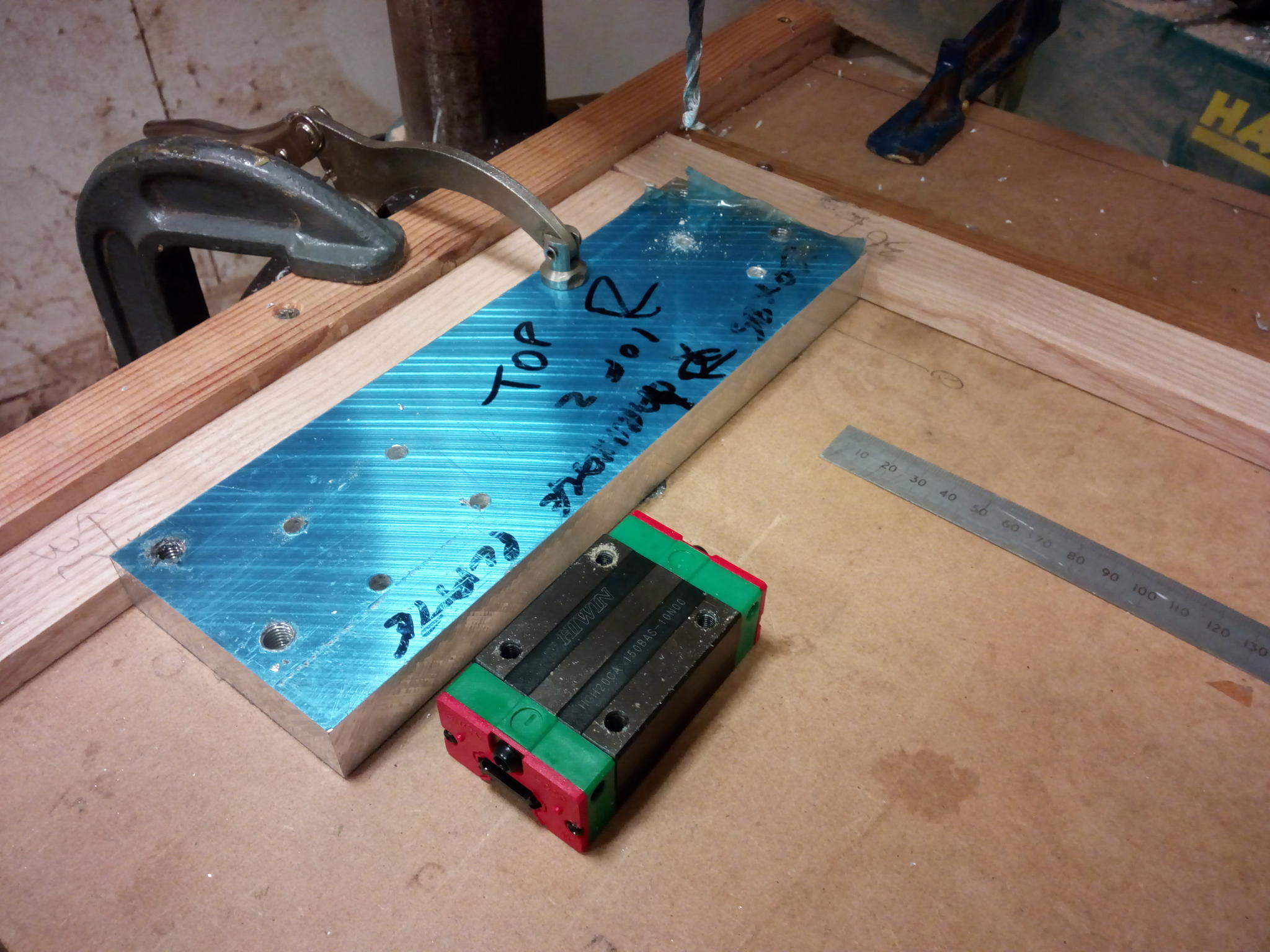

    So while waiting for the resin bed to set I have been making up the gantry, z, y and x carriages etc.
    Not having very good marking out equipment, (surface plate, vernier height gauge etc) I decided on using a wooden indexing type table on my pillar drill. This is because I can plane wood to accurate thickness. Then you mark the first point and drill, then index around this point using accurately planed pieces of wood, adding or subtracting them. Making sure you get all the swarf out of the way. Sorry if this has already been done by someone on the forum but I’ve not seen it. Thought it might be usefull
