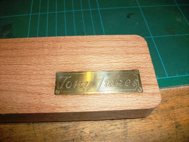

    The problem I get is chewed edges to the cut. This plate, for instance, Click image for larger version.
ID:	20024 had to be sanded and polished back to smooth. Is this ususal ?

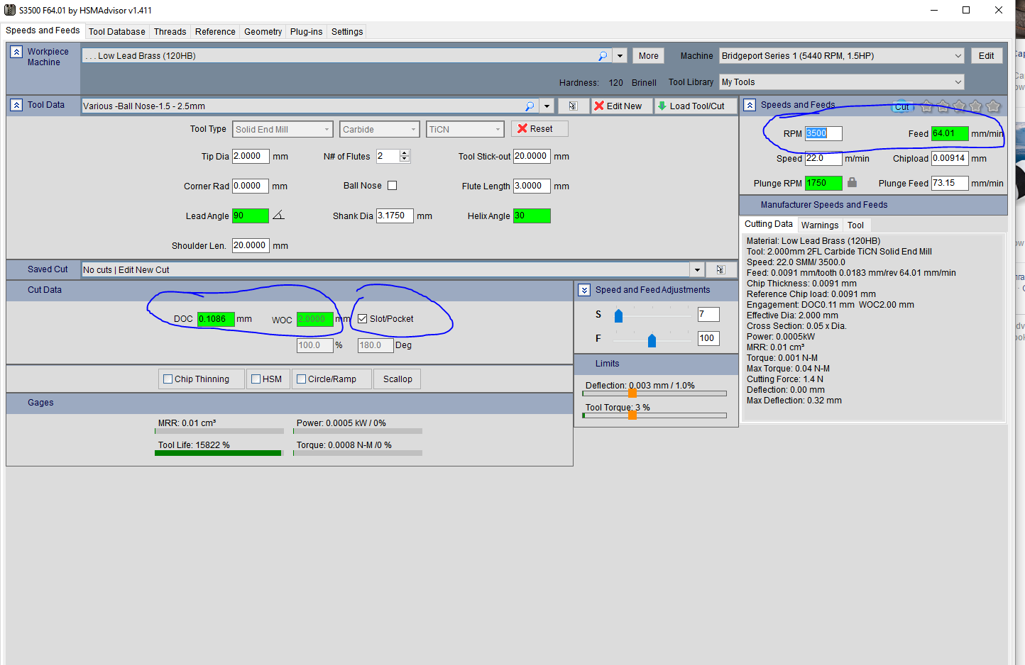

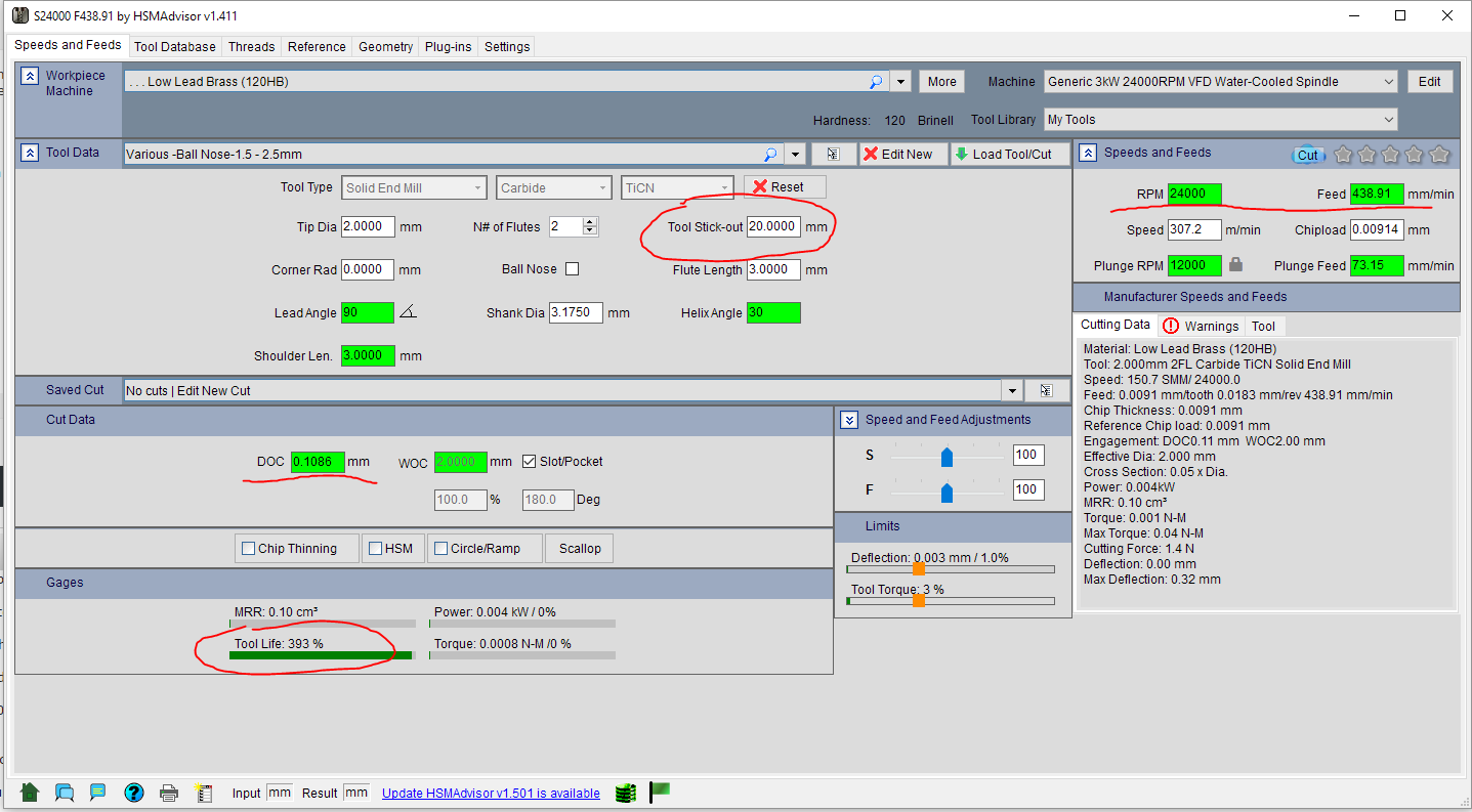

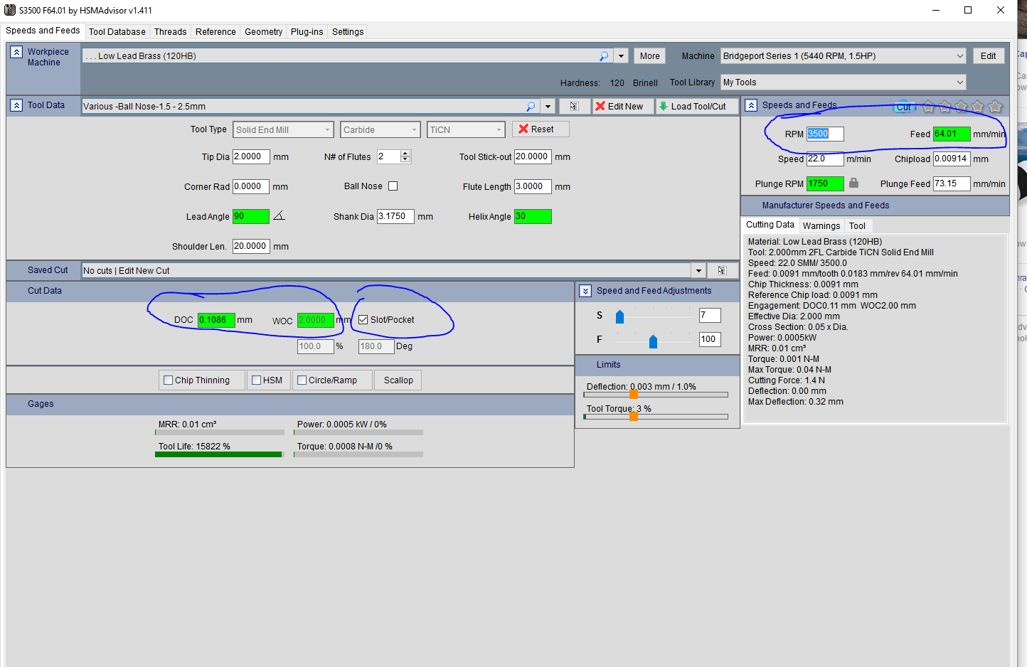

    I dont think we need to make a tool database. HSMAdviser or G-wisard are more than enough so no mistakes are made. I know i repeat my self but HSMAdviser is a Great program which is a must . i know via Exceoll sheet all can be calculated but using the program is such a breeze and flawless process. Believe it or not but 10 times more experienced than me people started to ask me on opinion on feeds and speeds with special and small cutters.
    I dont know what machine and cutters are we talking here but that below is how i do it and it works 100%. Suffice to say that i have in that range tools that each is 50-60 euro and i could rush them 200% faster from that below.
    Anyway, try always to use lower stickout if possible/ not so with the calc below as some clearance was needed due to deep channels. And have in mind i am using TiCn coated cutters so lower that a bit for uncoated carbide cutters.

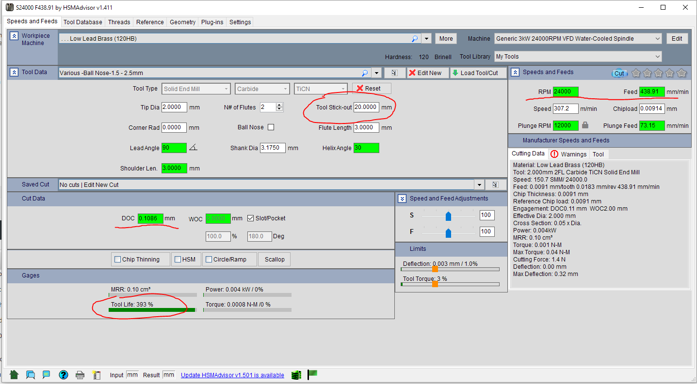

    Now if you have a mill, thats what the same will look like:
Name:	jeff slot cutting 2mm flute in brass.PNG
    PS. Sorry above if you see its for edited ball nose cutters which i have the same size and type. But ball nose box is unchecked so its for straight flat end cutter. if Ball Nose are used, halve the depth of cut and double the feed
    Stiffness of machine plays big part to finish quality. So if you got spaggetti machine then yes this is usual.!!
  5. #15
    not spaghetti - worse MD much wobblier, but I have to live with my mistakes until I get my own build done.
