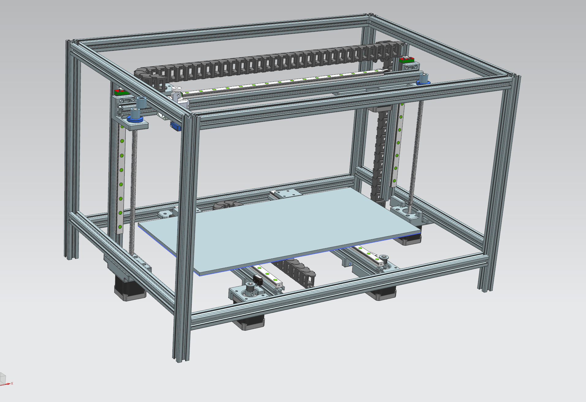

Then i said to my self: but it needs a double side beams for the gantry so its more rigid, does not vibrate and you could lift it and move it without need to adjust it again Then it looked like an almost finished half aquarium. So i said to my self- aluminum profile is not so expensive so better for 20 -30 euros more i make it so that if desired sheets to be bolted to profile and printer enclosed without any further modification or extra box needed.

As you see above at the snip, rail width and especially weight were main consideration as obviously 9, 12, 15 both normal or wide will work . But i believe 12H block and rail 12 size will work best as a compromise between block length, block weight, rail weight for printers up to 500x500x500 cubes.
3. Aluminum profile - 20x20
why:
-price 1/2 than 30x30
-enclosed structure
-rails size and especially the bearing block size is similar
Aluminum profile and linear bearing size and type choice was also influenced by the fact that this printer will be able to move at servo driven speeds and the Bowden type choice.

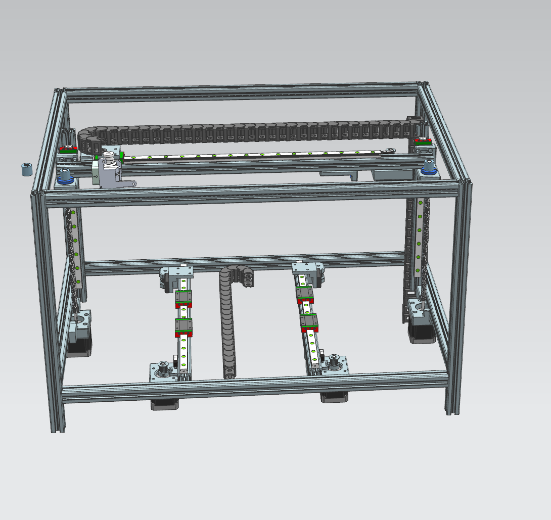

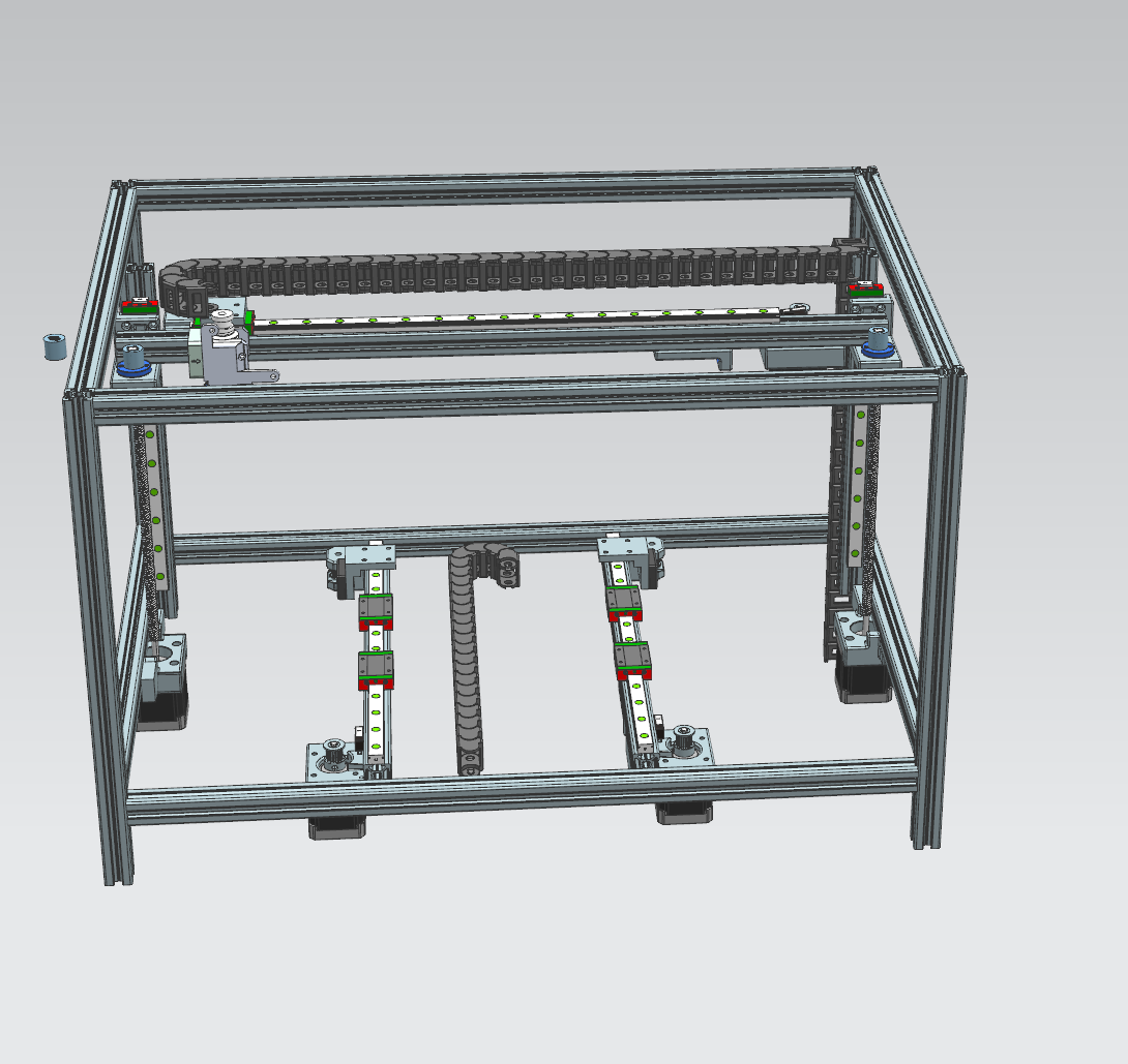

6. All parts must be self aligning to perpendicularity and maintaining same distances without the need of special tools when mounting. At most 1 precision square to be needed.
check pictures bellow.
7. All must be inside the envelope of the frame, no motors outside, etc,. So if one desires to enclose it by himself very easily, and keep warmth, noise, etc. there. Obviously the electronics have to be placed wiselt, so i think for now to be under the bed, isolated from the heat of the enclosure.
8. Bells to be tightened to specifications easily, means each belt has to have screw tensioner. But hey, not tlike the ones i have seen, that are so flimsy and move the belt around when reaching speed.
9. machine will be fully parametric, so design will not change at all up to 600x600x600 cube. Just lengths.
10. last but not least: the type of design. After much consideration Core XY designs, moving Z table and so on. Let me tell you. The simplest is the best for me. Moving table, double gantry z . I am quite happy to argue and explain why. If you have questions. But its a fact and no changes.

So here are some picture of what i have done till now, ignore rail lengths , that will still have to be adjusted so all to fit inside ,all is still in a sketch phase:
