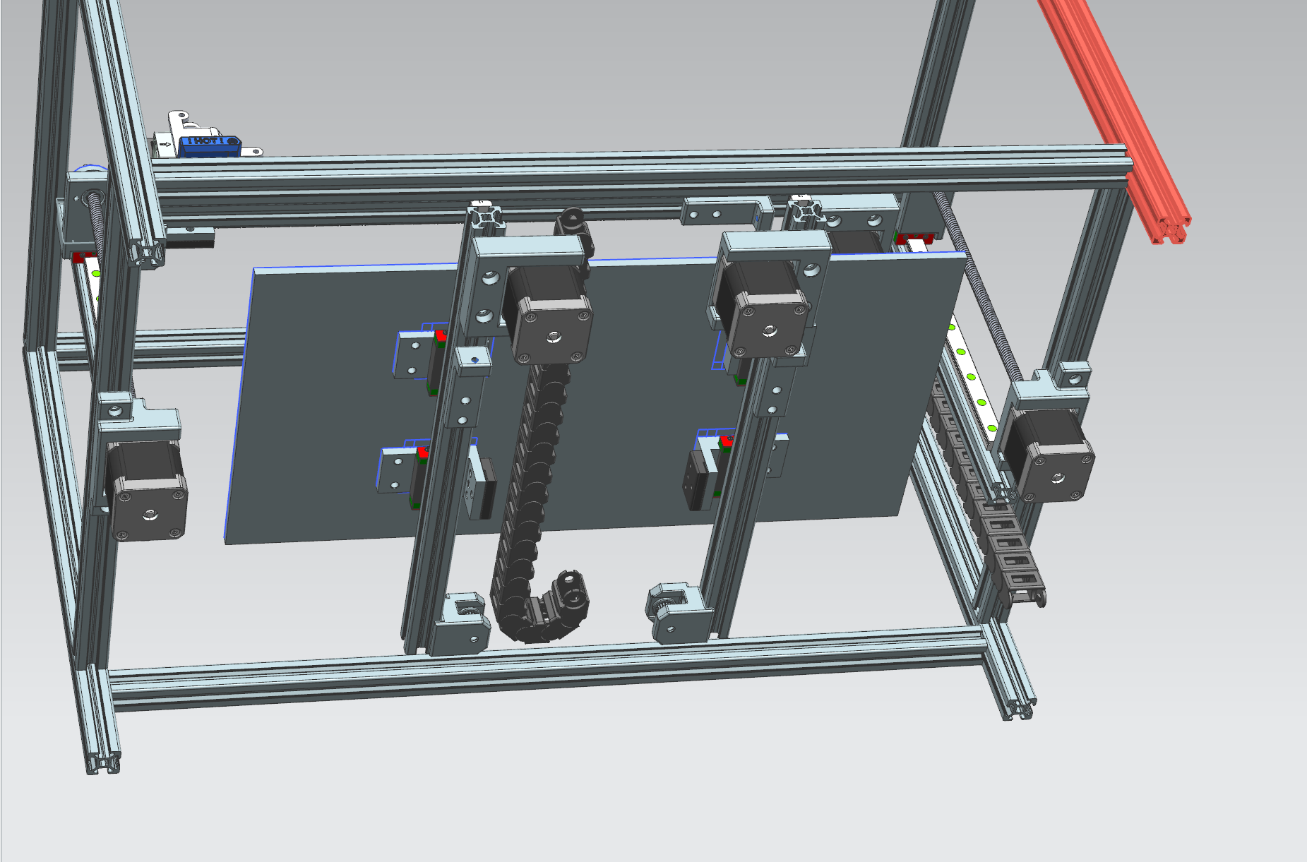

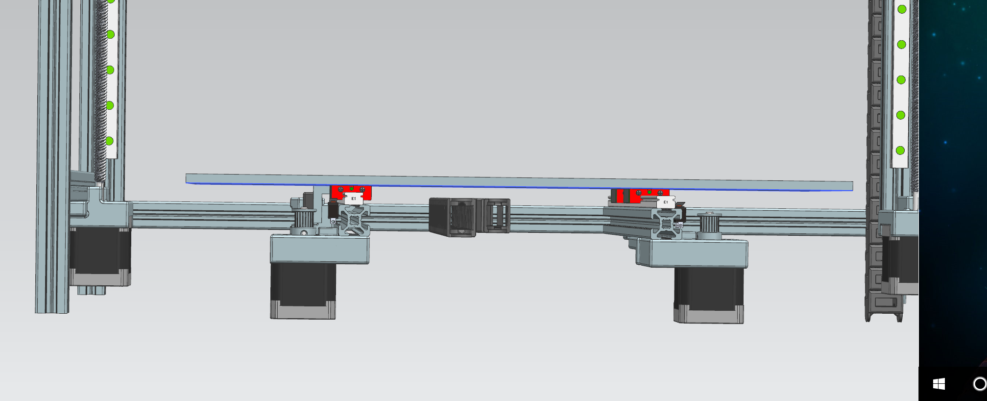

    I will explain why i like this solution below. Mind me that the actual bed in the drawing is 440x220mm, so it will take 2x MK2 heated beds 12/24VDC on top of it bolted, which 1 of these is 7 euro.
    1.The overall design of the machine.
    -The printer must be rigid, fast and able to Scale Up. From that the result will be precision, nice prints and easy to build a second one, which probably most of the people will do, once they have one and are serious into printing.
    I meditated long on the various possible designs and chose this one due to the simplicity to build and later adjust, compared to all of the other designs. Some of them are so ridiculous honestly, that even i can not imagine what hassle will be to straighten it to some acceptable precision. If i that build a 3m machine to some standard, can not be sure how to put together precisely a 50cm machine, then imagine what the result will be for a person that has no idea at all.
    When you start scaling the machine up, the so called Core designs start to loose in moving weight compared to this one, though i dont know why the guys are so confused and praise them so much.
    Thats another story but suffice to say that from what i see scaling the machine up, if i do the custom bed then the bed weight will keep in line with a Core XY design moving mass weight very simple. 20x20 beam is 0.45kg per meter even a 1000x1000mm bed could be done from same 6mm precision aluminum cast sheet and a simple beam bolted from below if it starts deflecting from heat. At the same time Core XY will have very serious lengths belts which will start back slashing/ from stretch/ on high accelerations, or motors have to be moved, which is additional mass...
    And anyway all other design suffer from the problem called twisting the machine out of precision when prying out a printed object from bed Or separate glass bed that is insulator, ... and so on.
    2. The lack of additional under bed carriage that is connected to the bearing blocks on which the bed lies, or whatever they call it. If that thing is made from plastic it bends, if its from aluminum it is heavy. In fact the aim here is to go without it.
    3. Eliminate adjusting the bed once its adjusted when building the machine.
    This practice is absolutely ridiculous to me. From day one i saw a 3d printer. Imagine having to do that on your mill or router every time you start a job
    4. Ability to bolt it and to make bolt holes from bellow where i like. You can not drill PCB heated bed. That will additionally provide support to bed against bending from temperature, though from reports 6mm bed is alright.
    5. If you glue additional silicone plate which is the only viable solution for big beds for now, first you can not drill it-means additional plate from below, second as i said its heavy, expensive and not any safer or cheaper.
    6. I found a nice 230V heated PCB project which also seems stack-able but it will suffer from need of additional glass on top, hence weight, low reliability, loss of precision surface etc.
    7. I think an additional sheet of thicker PEI on top of the aluminum bed will allow things to be removable and exchangeable, without f"""g the precision of bed and machine. Glass i dont like for 2 reasons- first its an insulator, second i dont like one shiny surface and all else different. Anyways i learned to print 100% with rafts.
    I am not in a hurry, i prefer the quality result.
    Here bellow is the latest update on the design. At the end when all is clear, printer will look very simple and clean. Bed will be thermo insulated from bellow. Electronics and motors will be below. Heat flow will be up , so all is ok. After long search at the end i found some people sharing that when bed temp 100C in enclosure temp is around 45C, which is ok for the plastic parts and the motors, so i dont believe they will need additional cooling.
    Meanwhile i looked most of the extruders and hotends. The way i see it- E3d6 plus E3d Titan extruder or i have to make sth similar, which i dont have the time to investigate. One company, great products. No super duper over complicated extruders that cost 200$. These days i printed 24h and many different things, and i found that the weakest place in the 3d printer is the extruder itself and the measurement of the heat in the block- hence the thermistor type, position and especially way of attaching it.
    All else could be Chinese or mediocre and will work more or less, but not feeding reliably the filament and not knowing reliably the temperature of the heating block= bad prints, unreliable prints, messing with adjustments that is not needed to mess with if these 2 are working right.
    And these 2 could make you crazy if they are not perfect.

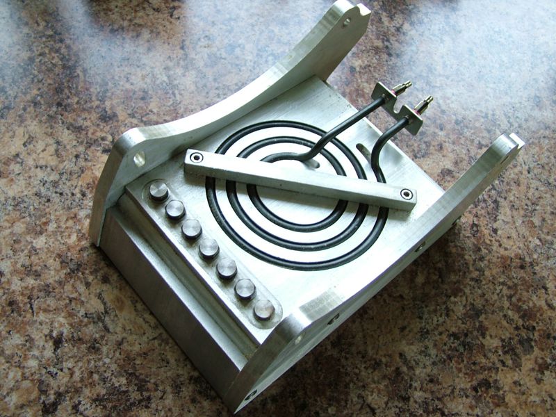

    Totally unsuitable. You need an electric element or elements.
    This was fun to CNC but probably overkill for your application
