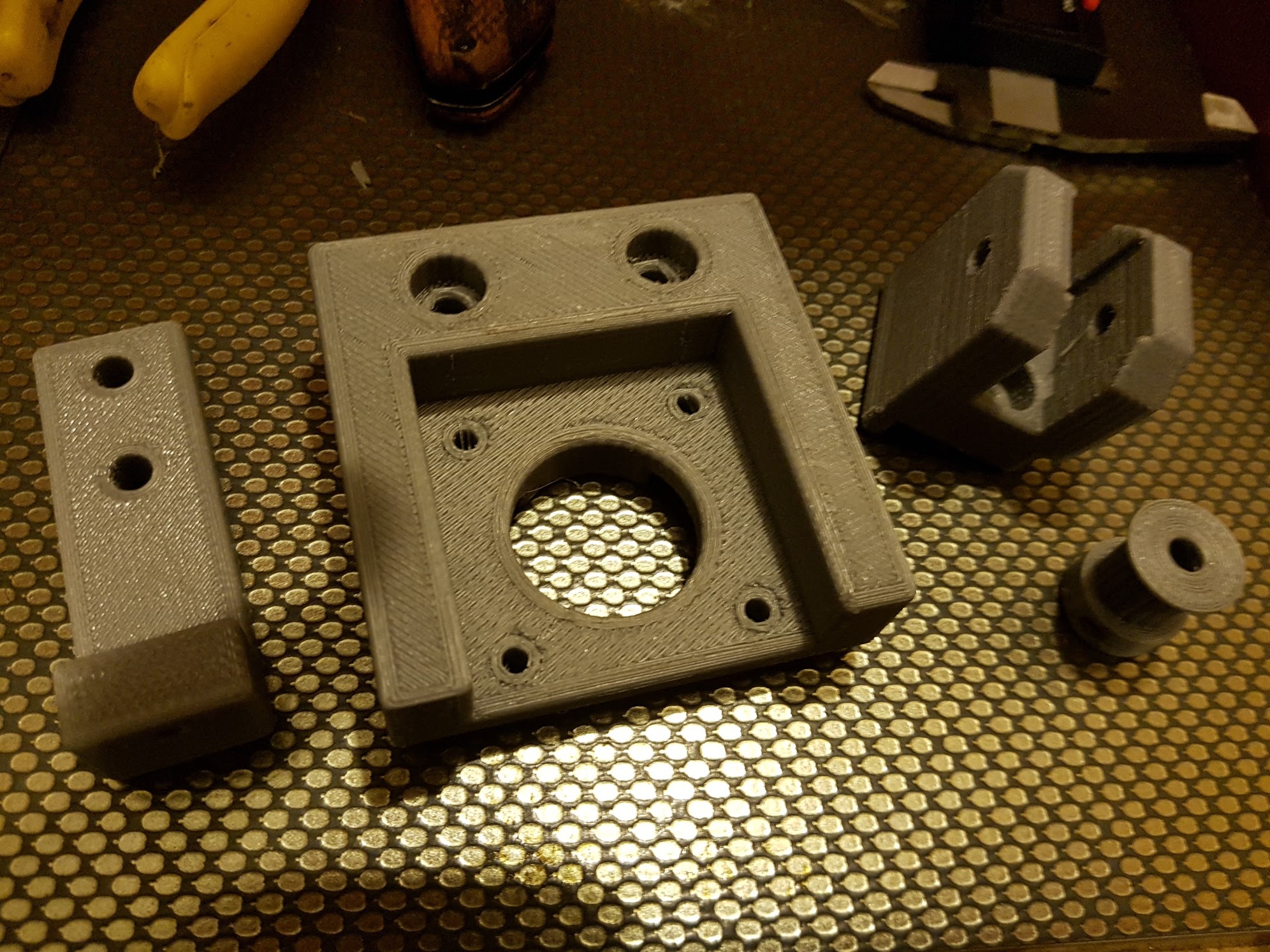

    Finished drawing the Z motors and the mounts. Mounts are designed so that will space precisely the motors in all directions

    Table design include 2x motors and belts..etc. This is due to the whole idea behind that model to be able to scale bigger easily. Without any actual change of design. Apart from lengths of elements. So to be truly parametric design. Plus motors are cheap, Z plate will be cast and trully from what i see / the printer i am testing/ this is where all designs i have seen suffer. I dont see what is the big deal to include second motor and for mere 20-30 euro more to have no problem with acceleration of the plate. There are cheap signal multiplexers? that make one signal for 2 motors / if board will not support it/, etc.
    Anyway most possibly my printer will be at least with closed loop if not with servos. maybe i will build one to see how it goes with cheap motors first.
