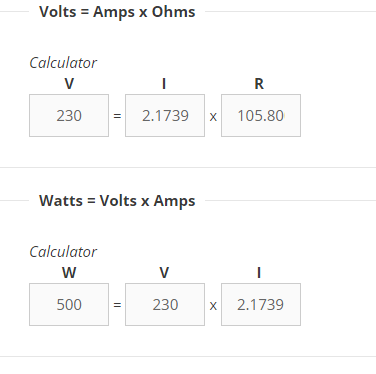

    Now some electricity quiz. I need some advice from sb not electrically challenged like me. As you know I am wondering how to make the printer bed plate as simplest as possible, rigid and cheap.
    After examining many options i came to the conclusion that could be achieved using 6-8mm aluminum plate, routed from bottom with cable channels and insulated heating cable inserted.
    230V, plate connected to Earth, thermal fuse for overheating, current fuse for over current, thermistor integrated, that for safety. Plus SSr and probably Pid controller or just using the boards PID and separate board for the thermocouple signal if i go this way.
    So according to my research ~500W will be right for the power. I used this simple Ohm’s Law calculator
    I looked around and found the so called Minco Heat 12K Carbon Fiber Heating Cable 33 Ohm/m DIY Underfloor Heating Wires at ebay and ali express.
    It sells around 15euro per 20 meters incl shipping which translates into less than 1 euro per meter

    Now from the calculator it seems at 230Vac to achieve ~500w i need a wire with resistance around 100 Ohms more or less :
    Please correct me bellow if i am wrong before i burn sth:
    1.Now as i understand it the wire resists temperature 200C. Obviously if use 3 meters of wire at 33 ohm per meter i will achieve the desired result.
    2.They say :"The product can withstand the power of power: 25W/M" but thats for floor heating, so i assume if wire is connected to a temperature regulating device which does not permit it to go above 130C /+ the thermal and current fuses/ there will be no any problem????
    3. I understand that also i have to push fit the wire in the channel/ 3mm/ so there is not any air gap between plate and wire which could cause overheating due to incorrect temp measurement.
    I plan of: 6/8/mm plate=+ channel+tight fit wire+thermo conductive silicone flush with bottom surface. So no air there art all
    Apart from that i will use some insulator sheet from bellow, still not clear but most possibly Teflon, Silicone, Mica ???
    What do you think?

    Your figures are broadly correct, but there's a bunch of information missing from the cable spec - max current rating (you can guess at 0.8A given the 25W/M - but that's likely derated given the intended installation buried in a concrete scree) - to be honest, I'd just try it and see. Yes, you'll get a bit over 500W heating which should give a respectable amount of heat energy for the 1kg block of ali that you're using. Temperature control you've mentioned, and a thermal fuse (you mention) a necessity in this system; zero-crossing SSR also a good idea as well as a current protection device (fuse). All good stuff, but very little in the data on the cable to give support to your design simply because you're using it for a different purpose. Try it and see - my thoughts are that it should be workable.
    My only reservations are: No indication of the thermal expansion of the cable - if you bed this too tightly in the ali block you could sheer the cable strands - I'd look to a loose fit and infill with thermal paste when you look to productionise.
    Experiment, is the name of the game - you've nothing to lose (provided you keep a fire-extinguisher to hand :) ) In case the cable fails catastrophically I'd certainly use a test bed well away from anything flammable and be able to isolate the supply easily. Once you have your thermal control in place then test worst-case performance with it shoved in a cardboard box crammed full of thermal insulation (cloth sheets) to make sure that the control system still works.
    The one area I'd be concerned about with this cable is making the ends off correctly - looks like you are supplied with copper ferrules to crimp - that to me is the area that you're likely to see failure if not done properly.
    I'm not sure I'd agree that this is a cheap solution, though - in the UK I can source heated beds off ebay for £6 each (214mm x 214mm) and these will be being etched in their hundreds or thousands in china with the precision from decades of investment in PCB manufacture. Only 120W, but two in parallel for the 400mm bed and you're not a million miles from your solution.
    My research on similar setups shows that in real life 500W non insulated bed this size will heat very fast, and insulated will heat probably under a minute, so no worry as you say.
    Good info for the zero crossing SSR, i did not know what that means. Learned something. So are the cheap Chinese SSR relays zero crossing? I have used them for my kiln but they just work, i did not have an idea that they are different types.
    I chose the carbon fiber cable exactly for that reason that the carbon fibre itself is very stable and does not expand or shrink. At least that is what they brag about it. But will look into further info about the whole cable.
    I will do exactly that.
    I briefly looked into that and saw how people connect carbon fibre tape into clothes. More or less they use some kind of silver glue. So i am thinking i have to buy some ferules and test, if needed fit inside some extra silver compound for better conductivity. One thing is clear that everything should ve additionally fixed mechanically to the bed, meaning pressed between plates or sth, and from bed only 3 kevlar teflon double shielded thermo resistat wires will protrude.
    I will explain why i like this solution below. Mind me that the actual bed in the drawing is 440x220mm, so it will take 2x MK2 heated beds 12/24VDC on top of it bolted, which 1 of these is 7 euro.
