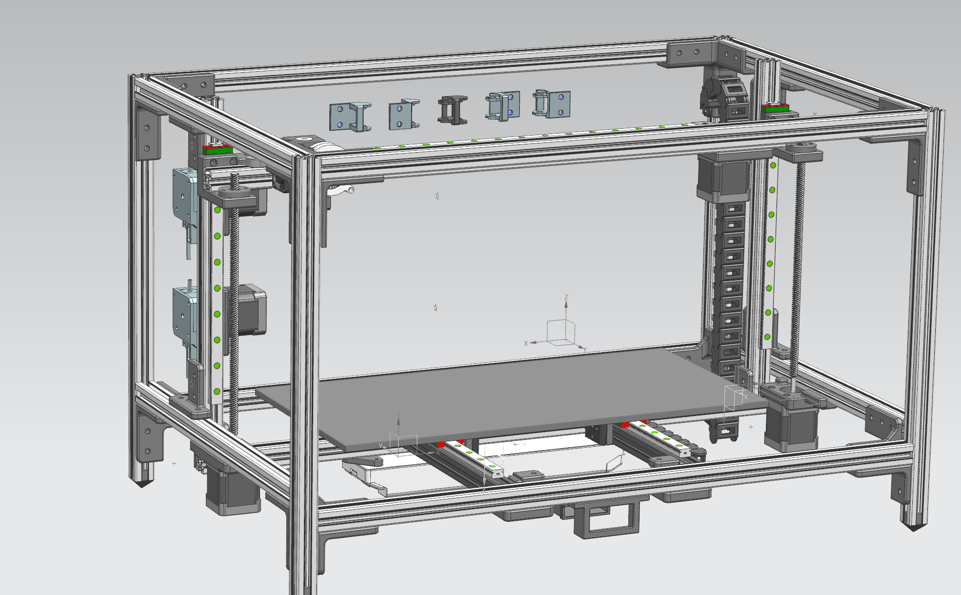

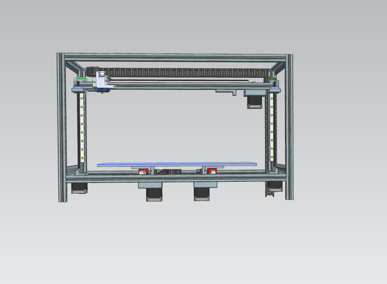

    The cable chain is ready and tested. It had some final adjustments and i am 99% happy with it.. Its printed but i have designed it as a commercial quality chain. So its 2 in 1. What do you think? It seems to me bnetter than the one they use in the printer i have here
    here are the files http://www.thingiverse.com/thing:1963745
