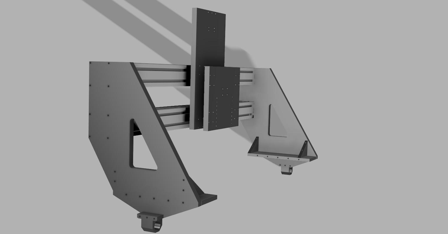

    Thanks mike - 1 question,
    Your gantry sides are 20mm - these are the largest plate connecting the Y and X axis, where did you use the 15mm plate for?
    Any did you use plate for the Z / X axis.
    I have also used high grade extrusion, the bare weight of the aluminium along for me was 76 kg. I think the Y axis was 9 kg/m, and the X axis around 5-6.

    Hi Nick
    I used 15mm plate at either end of the long extrusions (x-axis) (see my build log photos for the bed construction). For the Z axis construction I used 20mm 5083 cast and machined toolplate. It has a very fine and accurate surface finish which is critical for the setup and accuracy of that axis.

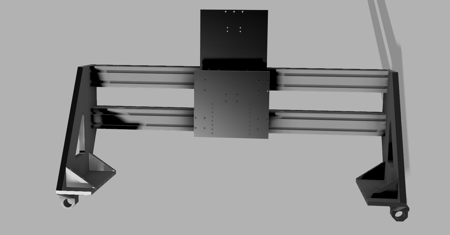

    Ok guys - here is my final design
    20mm thick
    May put gussets over the ballscrew attachment, but Ill wait and see how rigid it is without
    Nick

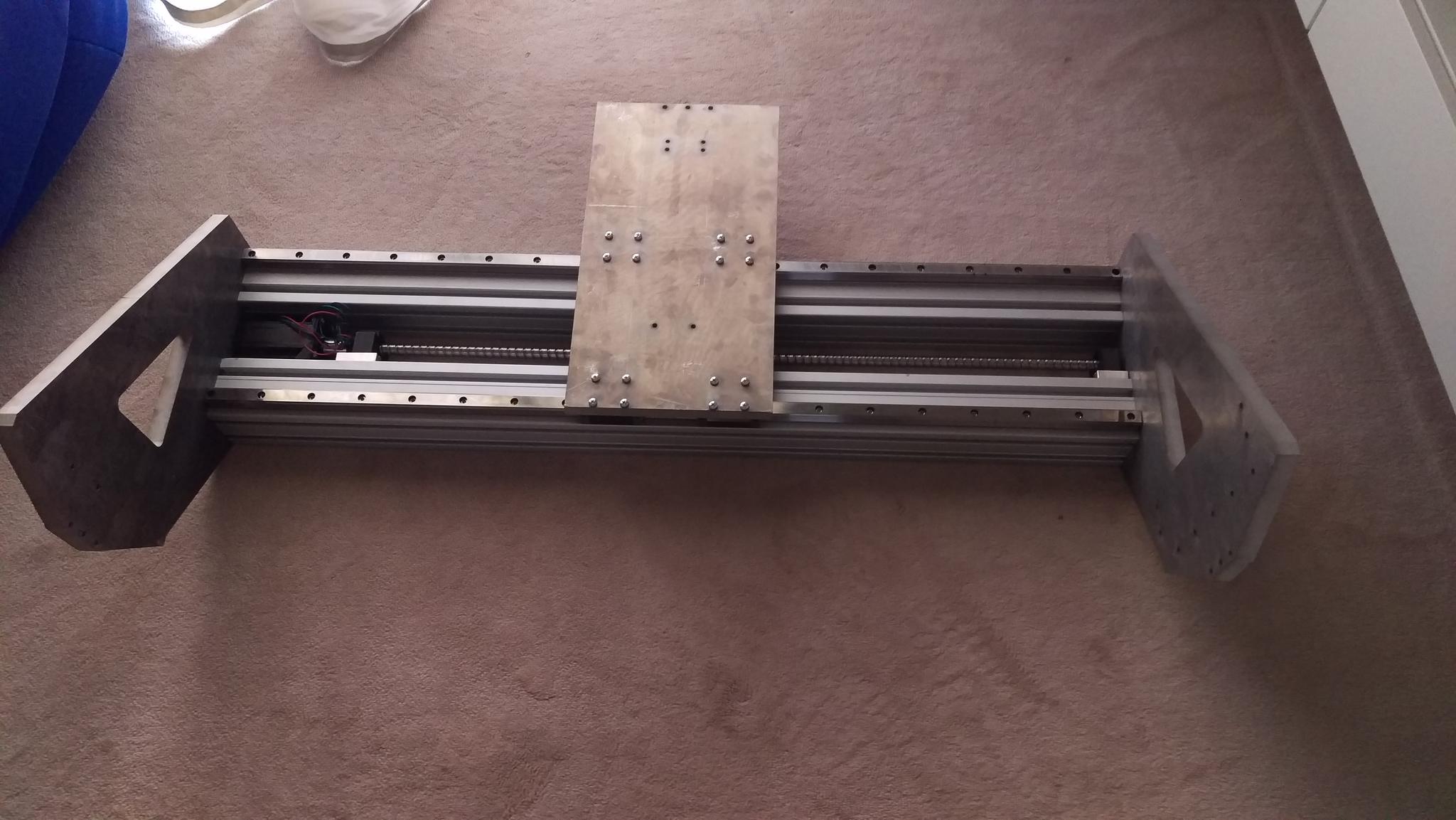

    So it was a busy Christmass
    Went with 20mm thick
    What do you think?

    Hi Nick
    You have been busy! so have I, finally got my machine cutting. Anyway the 20mm plate on the gantry sides will give stiffness in the Y/Z plane. BTW I noticed on your Z-axis plate the bolts are raised. You should counter bore these so that the trucks for your Z axis will have some where to be located. Remember Jazz's comments about mounting the rails on the back of the plate which holds the spindle and the trucks and ballscrew get fitted to the plate as shown in your photo.

    Yeah, thanks for that, I realized this as I was staring at it yesterday, will have to counter bore to even get cart to slide past the bolt head I think.
    I've decided to go the other route and mount the rail on the sides of the plate pictured, and just have the cart on the back of the spindle.
