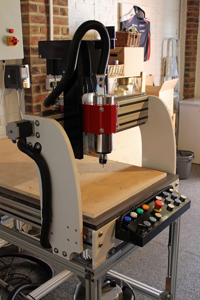

    I build similair design and depending on the Gantry side heights either 15 or 20mm will work. The Red machine uses 15mm sides but as lower sides. White one uses 20mm.
    Like wise the Red machines uses Z axis with Rails on the front plates like has been suggested. However the White one is the other way around.?
    Reason for this is down to usage. The red machine was designed just to cut thinner material upto 75mm. It will happily cut upto aluminium.
    The white machine had requirement to cut deep material with long tools in Clay model board which isn't very hard material. This required the spindle lifting higher to allow for long tool hence rails on back plate.
    Both machines will happily cut aluminium with light cuts, infact the very first Job the customer cut was 4 x aluminium plates for where the machine fastens to the base frame which you can just see on one of pics where machine meets frame.(I only supplied the machine)
    Me personaly I would use 20mm every where, even Z axis. Also with Z axis if don't need long tools or deep cuts then would always go with rails on front plate.
    Regards the frame and gantry then I'd consider a few bracing plates like been suggested. . . . Hey maybe even cut them in triangle shape.!!
    With little bit of bracing then this design will easily do everything you asked about. Aluminium work will require lighter DOC cuts but will still handle it no problem.
    Good luck and keep it up.
