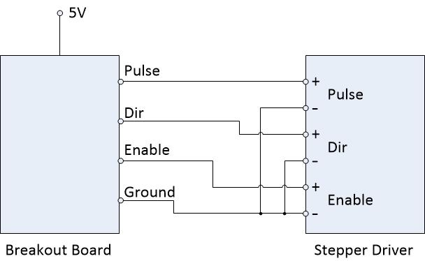

    My other question was with the stepper driver device. I have powered it from the main power supply and then connected the motor. Remaining on the controller was Pul +, Pul -, Dir +, Dir -, and En +, En -. Do you happen to have a good source of info I could look at regarding how to wire this end of the system up? This evening I have ended up reading all about the input signals for a stepper motor but I fear I might be going into more detail that I need. And then you end up feeling lost!
    Can't give source where to look but I can explain it easy enough.
    The Motion control device provides OUTPUTS which it sends out signals and pulses required to tell the drives which direction and how far to move. These OUTPUTS basicly fall into two types MOTOR OUTPUTS for each Axis and General OUTPUTS which provide 5Vdc Signal.
    Each OUTPUT as Positive Negative connection.
    So DIR connection is MOTOR OUTPUT and controls the Direction to travel. This is done by sending 0V or 5v depending on direction.
    PUL Connection is the PULSE MOTOR OUTPUT which gives stream of pulses relating to how far to move.
    The En is Signal to the drive to ENABLE/DISABLE. Often this isn't used and left unconnected.
    If used this would be connected to General OUTPUT or could be controlled by external device like relay by sending 5Vdc.
    So in your case there will be Pins on the BOB which are MOTOR OUTPUTS and Some which are General OUTPUTS. If using the parallel port they tend to stick to standard arrangement. ie: Pin2 =XDir Pin3=Xpul etc.
    There will also be pins for INPUTS.

Name:	BOB stepper wiring diagram.jpg
    If it helps, here's a rough wiring diagram that would suit a lot of break-out boards and stepper drivers. As JazzCNC says, the Enable signal is sometimes considered optional; if you leave it disconnected then the stepper driver defaults to "Enabled" anyway. The "Pulse" connection is sometimes marked "Step"; again, previous post explains why.
    I've just had a quick look at the "manual" for your BOB; not very helpful, is it? However, you should be able to identify step and dir signals for each axis (=stepper driver). Doesn't appear to be an Enable output anyway but I might have misread it. All ground connections (- connections on stepper driver) go to a single common ground terminal on the BOB. The manual then tells you what pin numbers in Mach3 you should configure for each signal (Mach3>Config>Ports and Pins). However, there is still this question about whether you are running on a 32-bit Windows; the parallel port driver will not work on any 64-bit Windows version.
