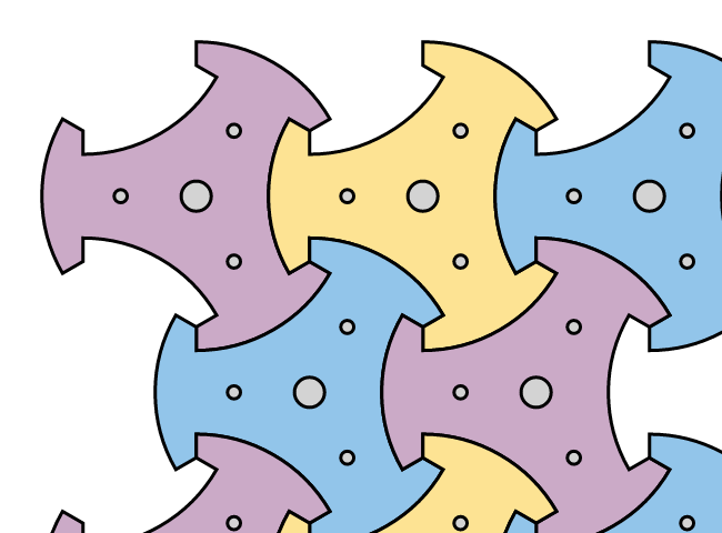

    Quote Originally Posted by Peter Dow View Post
    My method for specifying a particular shape of trispokedovetile is to specify the "CIRCLE" length as a percentage of the "HEXAGON" length, as illustrated in this diagram.
    This image shows trispokedovetiles with CIRCLE = 130% - in other words the length of the diameter of the (partially drawn) circles is 1.3 times the maximal diameter of the (partially drawn) hexagons.
    Attachment 19844

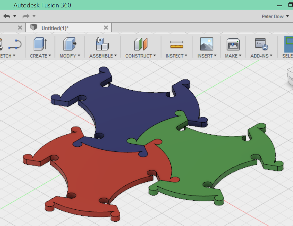

    I'd like to know how to use Fusion 360 in that way, if you care to explain Neale, please?
    I couldn't see the parameters you mentioned - "hex_spacing" or "outer_circle_dia" - I didn't even know where to look for them.
    I found the data object tree obviously enough and had fun clicking through it, finding something new each time.
    OK found the parameters on the pull-down "MODIFY" menu.
    Still finding my way around this software package.
    This was the result of changing one parameter - "Outer_circle_rad" from 65mm to 70mm.
Name:	fusion parameter change.png
    Hmm. Not quite what I hoped for.
    Nope - not quite what I would have hoped for either!
    I've just had a look at what might have happened here, starting with a freshly-downloaded copy of my design. I suspect that what you have shown is not the very first operation that you carried out, and that at some point you changed one of the parameters to something that F360 did not like. If you open a fresh copy of the file and just change Outer_circle_dia to 70, you should see the correct result. I tried changing Hex_spacing to something less than Outer_circle_dia (which the comment in the parameter table tells you not to do, but the comments field is typically off-screen and need the table to scroll sideways to read). This gave a silly shape, but because it modifies some aspects of the drawing, when you change it back the drawing does not go back to where it was. What you end up with is something similar to your picture. It seems to be to do with the way that the corner fillets are calculated. They are tied to the corresponding sides and arcs by tangent constraints which manage to flip through 180deg under some circumstances. It's a F360 feature, I think. The kind of artefact that comes from using a general-purpose tool for a very specific purpose when a special-purpose tool like yours can trap and defend against this kind of thing. There's an awful lot of power in F360; sometimes this is a good thing and sometimes it turns round and bites you in the bum. You get the same result if you try, for example, to set the Corner_rad to zero; this fouls up the related geometry in the drawing as an arc with zero radius upsets things. Make the value very small (I have tested it with Corner_rad = 0.001mm, for example) and all is fine. I guess that it's all to do with getting used to the way the package works.
    I had been going to post directions to find the parameters table but I see that you found it first. Well done - it took me ages! You will see from your view of the basic sketch (in your previous post) that creates one spoke that every dimension is parameterised (is preceded by "Fx:", which indicates that the dimension was not typed in as a value but is calculated from something else) except angles which are invariant as they are part of the basic geometry. However, you could play with some of these angles (another parameter?) to create an underlying "skewed" hexagon, which might give interesting results...
    I did read your post 5, which is where I found the diagram that was my starting point. However, as I said before, there was this optical illusion effect that meant that I just could not see the shapes that your dimensions referred to. Going back to the diagram having spent time studying the basic geometry meant that it made sense, as did your description. The problem was my eye/brain view of the diagram and starting from a different view of that, the words made no sense to me. Mea culpa.

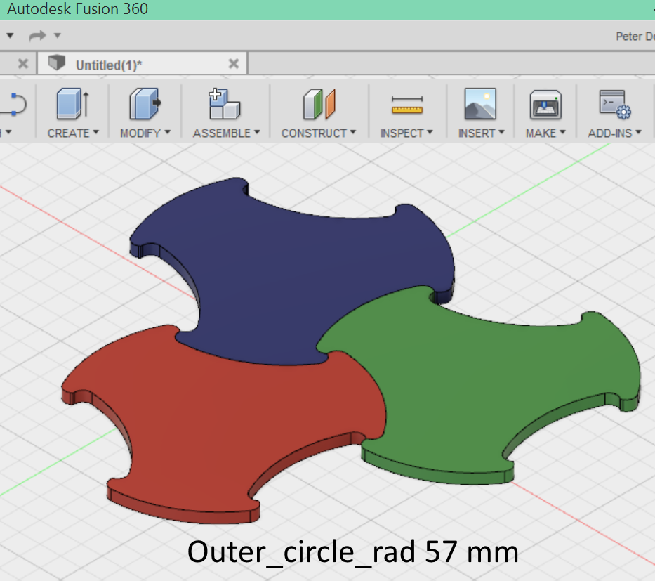

  13. OK I got this by discovering that it doesn't like big changes in parameters at once, but little by little.
    To get it to Outer_circle_rad 57mm, I had to step from 65 mm to 61 mm and only then to 57 mm.
Name:	fusion 65 to 61 to 57mm.png
    If I tried a bigger change directly from 65 mm to 60 mm the design went crazy.
Name:	fusion 65 to 60.png
    So it seems temperamental but with a bit of coaxing you can get it there.
  14. #20
    Neale's Avatar
    Lives in Plymouth, United Kingdom. Last Activity: 4 Weeks Ago Has a total post count of 1,748. Received thanks 299 times, giving thanks to others 11 times.
    Absolutely right, Peter - I had not tried this particular dimension change (I had just fiddled with Hex_spacing to change the proportions). I've had a closer look, and what seems to be happening is that as you reduce that parameter, F360 starts to modify the drawing to suit. However, it can make these changes in a non-obvious order, and depending on how things have been set up, the intermediate stages while it is applying changes and recalculating dependent features get distorted. It tries to redraw the large arcs, for example, with the new parameter-based dimension, then puts the fillets back in. But at this point, it has not yet moved the other line to which the fillet connects, so it starts drawing the corner fillets in the wrong direction. Make smaller incremental changes, and it manages to get the thing right at each stage.
    F360 is most definitely history line-based so things get applied in the order in which they were created. It might be possible to redraw this shape so that the ordering is better but as F360 does not display this level of detail in a sketch, it's very difficult to track back exactly what happened. And that sketch had quite a lot of add/delete/change operations, so it's anyone's guess what's actually behind it.
    That has been a really instructive little episode and I shall remember this "feature" in case it comes up again! Just goes to show that you always need your work examined by a third party to find the errors you would not even have looked for yourself
