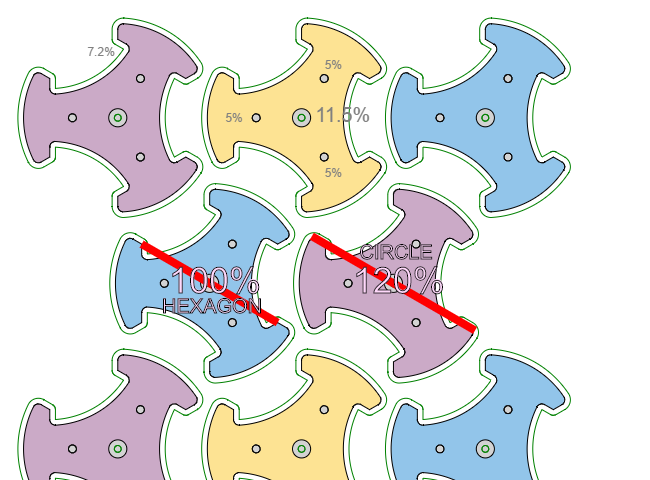

  1. For Computer-Aided Manufacturing of trispokedovetiles, I've published a Javascript web-page -
    Trispokedovetiles: CNC code to cut tiles web-page G-code generator [LINK]
    - which generates Computer Numerical Control (CNC) code which I've tested with CNC Simulator Pro [LINK] but not on a real CNC cutter as yet.
    In case you are wondering what a "trispokedovetile" is, it is the name I have given to a class of 3-spoke dovetailing tiles which fit together like this.

    Then image says Hexagon 100%
    The parameters ask for a mm input????
    My method for specifying a particular shape of trispokedovetile is to specify the "CIRCLE" length as a percentage of the "HEXAGON" length, as illustrated in this diagram.
    This image shows trispokedovetiles with CIRCLE = 130% - in other words the length of the diameter of the (partially drawn) circles is 1.3 times the maximal diameter of the (partially drawn) hexagons.
    Yes of course. My CAM webpage needs to know what actual sizes are intended to be cut to generate the correct CNC code.
    So you type in what is the length in mm of the HEXAGON maximal diameter, what length will be equal to "100%"?
    It's like if I tell you "the width of a rectangle is to be 100% and the length 130%".
    Fine but before you can cut the rectangle from a sheet you need to know what length 100% is to be in mm.

    What about needing a near zero tool diameter?
    This code kind of works for a single tile,

    except that the inside corners will have the radius of the cutter so the square outside corners will not fit together with them.
    EDIT- yes, probably good for a laser cutter which uses G-Code, but the paths will not work for rotary tool machines because square outside corners will not fit radius inside corners

  10. Quote Originally Posted by magicniner View Post
    Does the package allow for rounding external corners to match the inevitable rounded internal corners?

    It should have gone in Laser Cutters, or possibly Plasma, as it's currently of no use to anything else.
    If instead of a single flavour of G-Code with no consideration for the cutter being used it generated a drawing of a single tile there would be the option for using CAM to generate G-Code suitable for the user's machine rather than that suitable only for a laser/plasma which uses the generated flavour of G-Code.

    I edited out the stuff that stuffs Mach3's interpreter and the path looks OK but if I use a cutter with a positive diameter then there will be gaps of cutter width between the tiles once assembled, so for a router to cut the tiles they would need to be arranged as densely on the material as possible but not in their assembled pattern.
