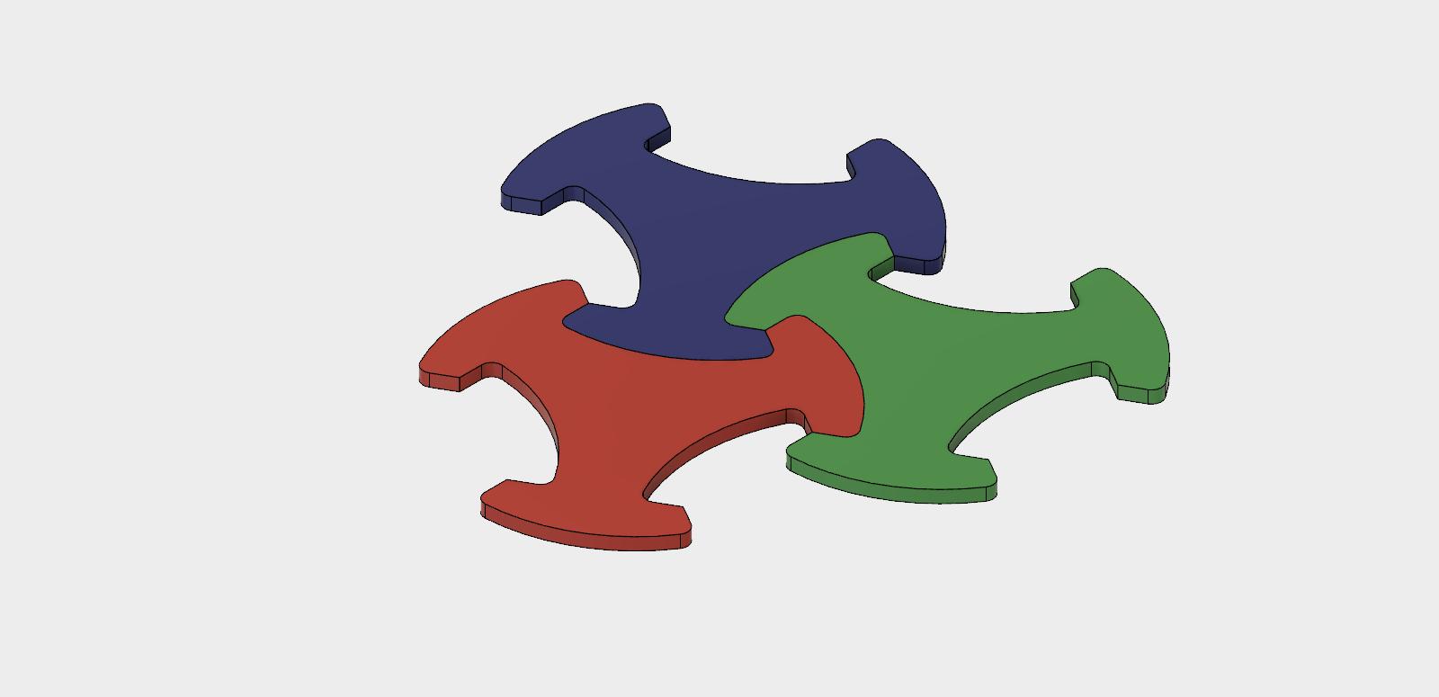

    I thought that this was quite an interesting design, so I looked at recreating it with Fusion 360:
    I have attached the F360 model. I have used the F360 User Parameter feature to allow the user to tweak dimensions easily. Outer_circle_dia gives the diameter of the tile. Hex_spacing gives the centre-centre spacing of the hexagons that make up the underlying structure. Corner_rad gives the fillet radius on internal and matching external corners. Yes, I tried to fix the "sharp internal corner" problem.
    Obviously, you can just go straight from design to gcode using F360 CAM and choose your own cutter diameters. You could, if you wanted, export a DXF version of the basic sketch. Note that because I was having serious problems in F360 in trying to draw one spoke and then use a circular pattern at sketch level, I actually extruded one spoke and then built up the tile using a circular pattern at the solid body level. This might make sense to someone with F360 experience, and if any of those people can point me at what was going wrong, please do so!
    Threespokedovetile v7.zip

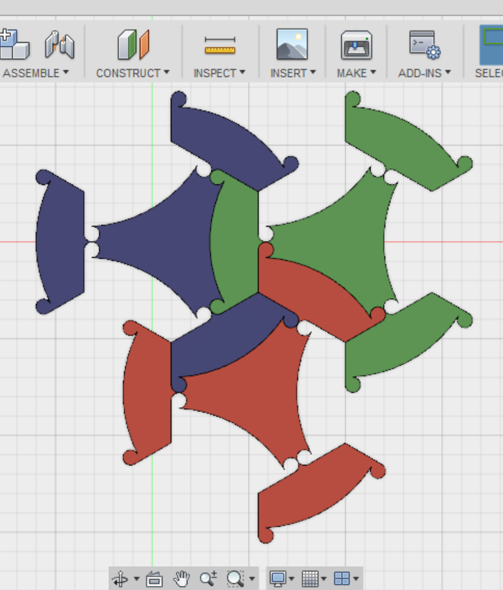

    I'd like to know how to use Fusion 360 in that way, if you care to explain Neale, please?
    I couldn't see the parameters you mentioned - "hex_spacing" or "outer_circle_dia" - I didn't even know where to look for them.
    I found the data object tree obviously enough and had fun clicking through it, finding something new each time.
    OK found the parameters on the pull-down "MODIFY" menu.
    Still finding my way around this software package.
    This was the result of changing one parameter - "Outer_circle_rad" from 65mm to 70mm.
Name:	fusion parameter change.png
    Hmm. Not quite what I hoped for.

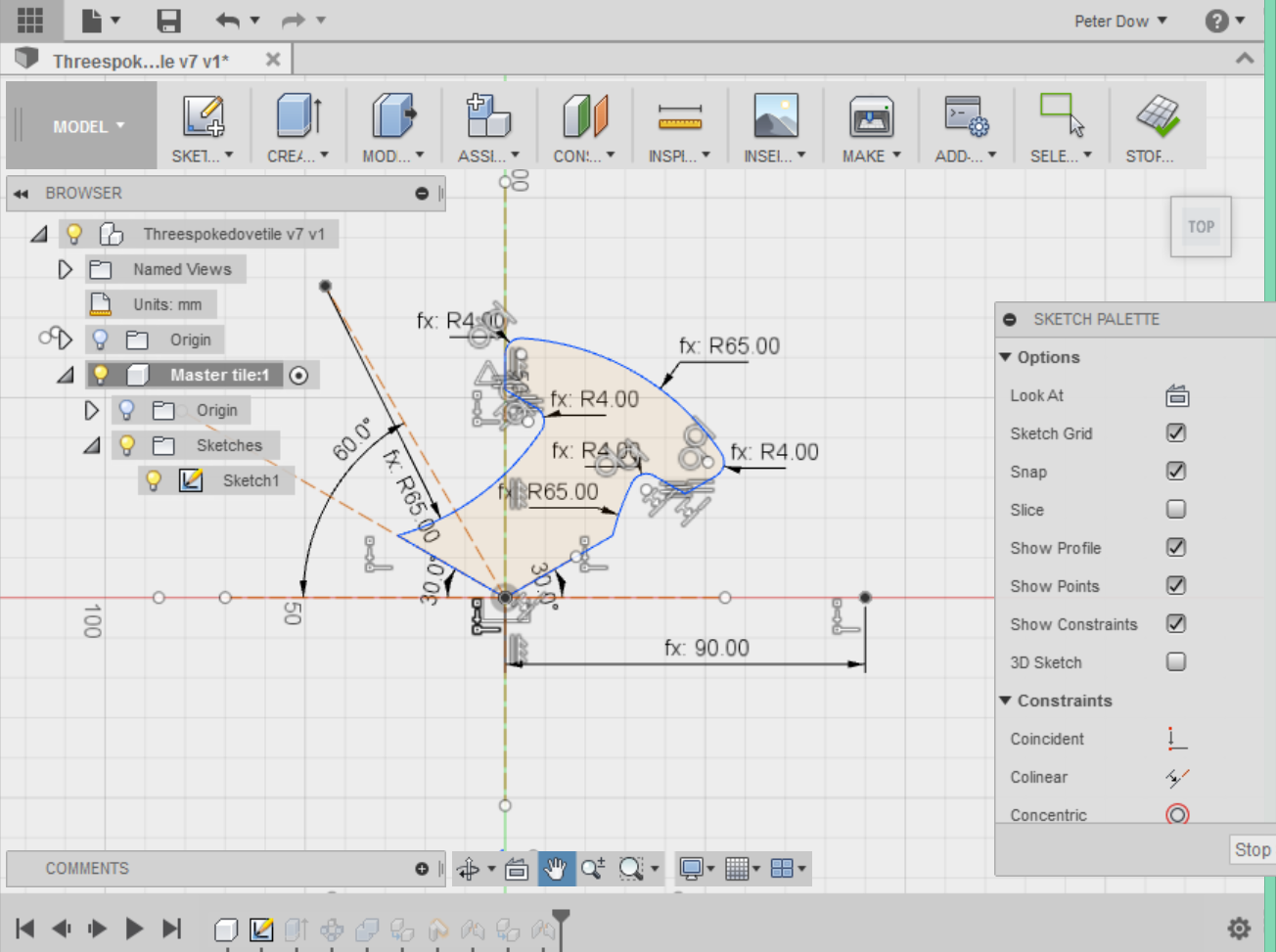

  13. OK I got this by discovering that it doesn't like big changes in parameters at once, but little by little.
    To get it to Outer_circle_rad 57mm, I had to step from 65 mm to 61 mm and only then to 57 mm.
Name:	fusion 65 to 61 to 57mm.png
    If I tried a bigger change directly from 65 mm to 60 mm the design went crazy.
Name:	fusion 65 to 60.png
    So it seems temperamental but with a bit of coaxing you can get it there.
  14. #20
    Neale's Avatar
    Lives in Plymouth, United Kingdom. Last Activity: 22 Hours Ago Has a total post count of 1,746. Received thanks 297 times, giving thanks to others 11 times.
    Absolutely right, Peter - I had not tried this particular dimension change (I had just fiddled with Hex_spacing to change the proportions). I've had a closer look, and what seems to be happening is that as you reduce that parameter, F360 starts to modify the drawing to suit. However, it can make these changes in a non-obvious order, and depending on how things have been set up, the intermediate stages while it is applying changes and recalculating dependent features get distorted. It tries to redraw the large arcs, for example, with the new parameter-based dimension, then puts the fillets back in. But at this point, it has not yet moved the other line to which the fillet connects, so it starts drawing the corner fillets in the wrong direction. Make smaller incremental changes, and it manages to get the thing right at each stage.
    F360 is most definitely history line-based so things get applied in the order in which they were created. It might be possible to redraw this shape so that the ordering is better but as F360 does not display this level of detail in a sketch, it's very difficult to track back exactly what happened. And that sketch had quite a lot of add/delete/change operations, so it's anyone's guess what's actually behind it.
    That has been a really instructive little episode and I shall remember this "feature" in case it comes up again! Just goes to show that you always need your work examined by a third party to find the errors you would not even have looked for yourself
    I started this exercise as an excuse to play with F360 and I have learnt more than I expected.
