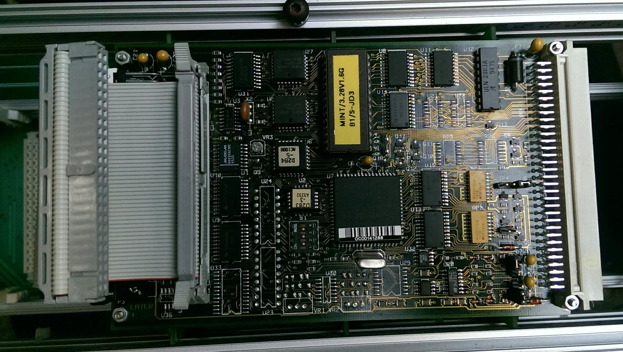

    Do you have pics of the specific cards you are looking for?
    dont have any on me just now but its the one with the little segmented display. i may be interested in the other cards as spares for my machine but if you coupd pop a photo up i can tell you what they are.
    Ill try to get a photo up today

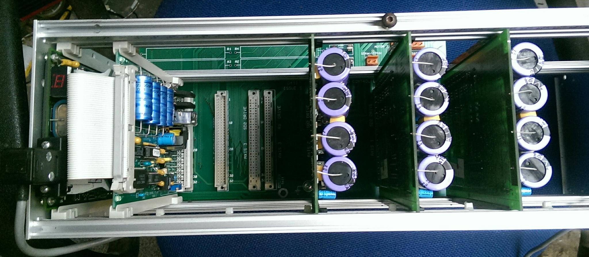

    I've got a complete rack from a 90s VMC sat on the workshop floor just now, and I'm near Edinburgh. It's got a Mint V3.28 eeprom in it.
    damn, that is the same DOS eprom i have already. Trying to get it working on VR5 in order to retain the atc operation. Out of curiosity have you converted your VMC to Mach with a tool changer? What are you looking for the parts?
