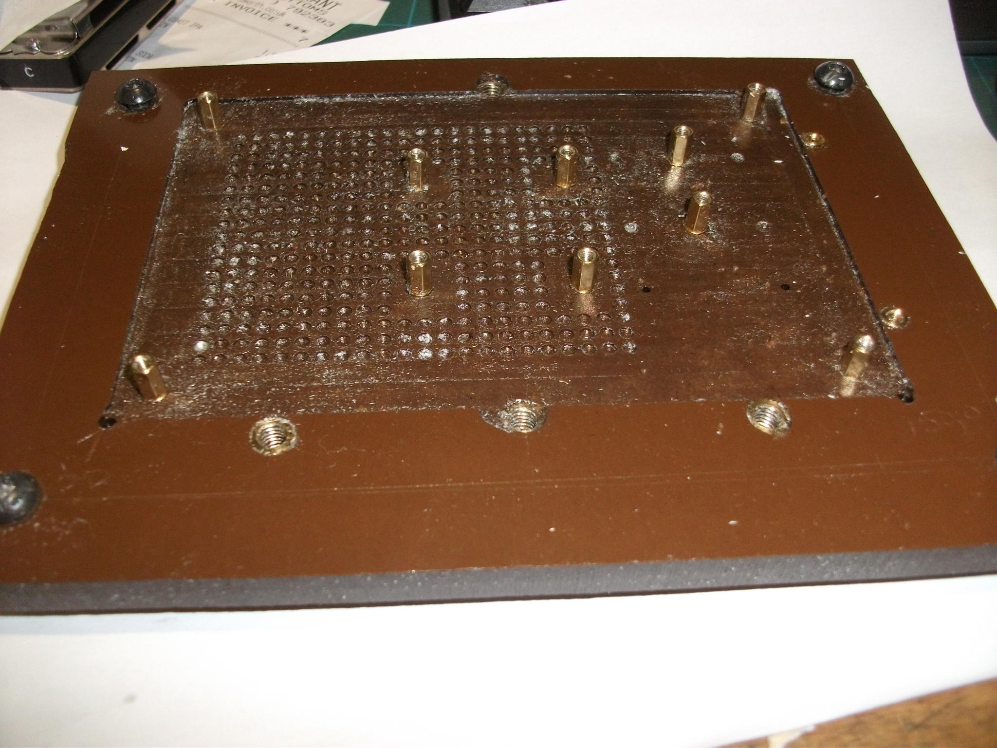

    I have got a sheet of 10mm thick paxolin marked out ready to cut to size to fit my machine bed and drill with a matrix of holes 45mm apart (so that they coincide with the T-slots) the holes then have M6 brass inserts pulled into them with a smear of araldite as lubricant. I plan to use this as a permanent sacrificial bed. For the moment I am just making up jigs for each job, like this one
    Rob
