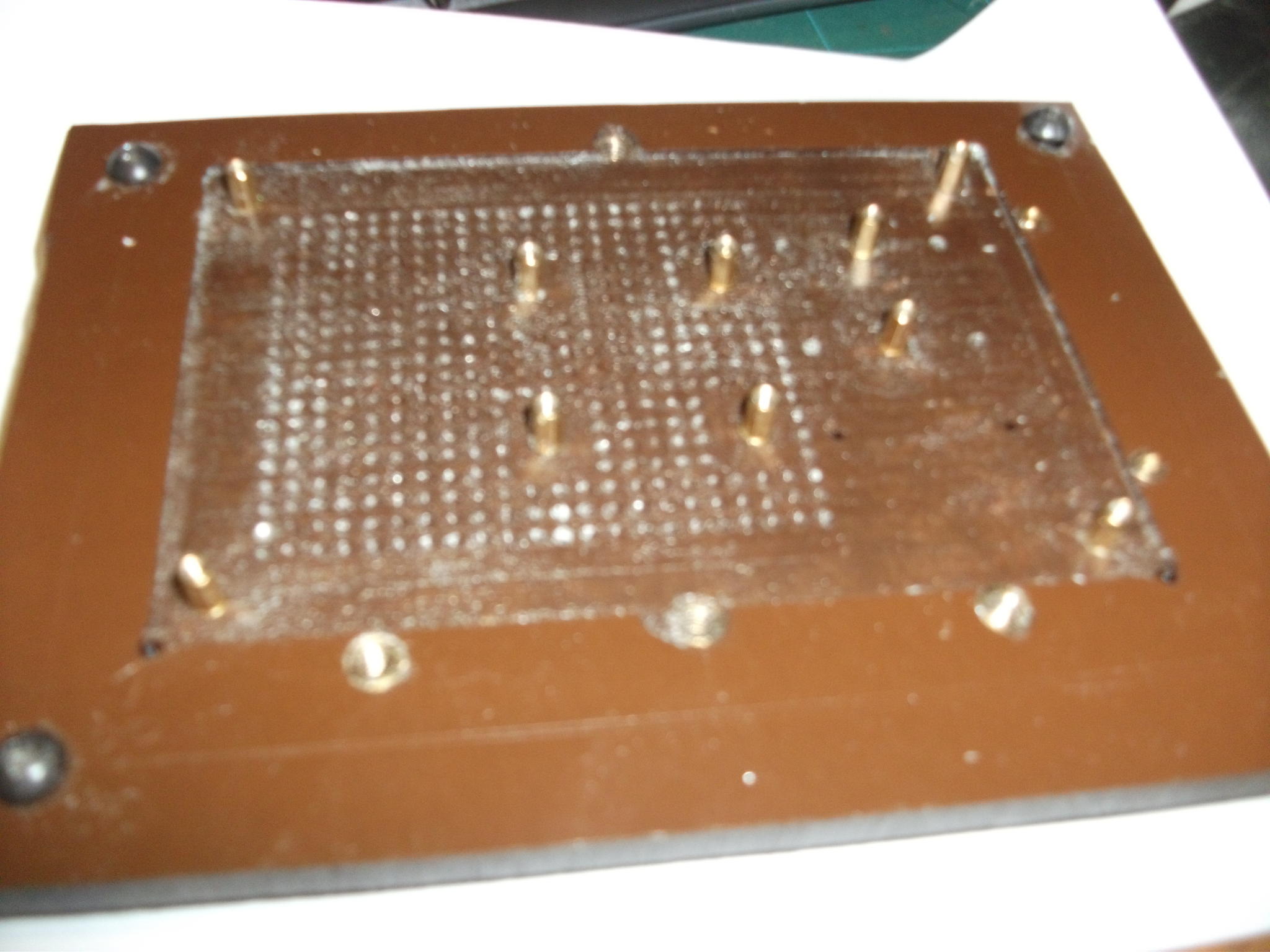

    I have got a sheet of 10mm thick paxolin marked out ready to cut to size to fit my machine bed and drill with a matrix of holes 45mm apart (so that they coincide with the T-slots) the holes then have M6 brass inserts pulled into them with a smear of araldite as lubricant. I plan to use this as a permanent sacrificial bed. For the moment I am just making up jigs for each job, like this one

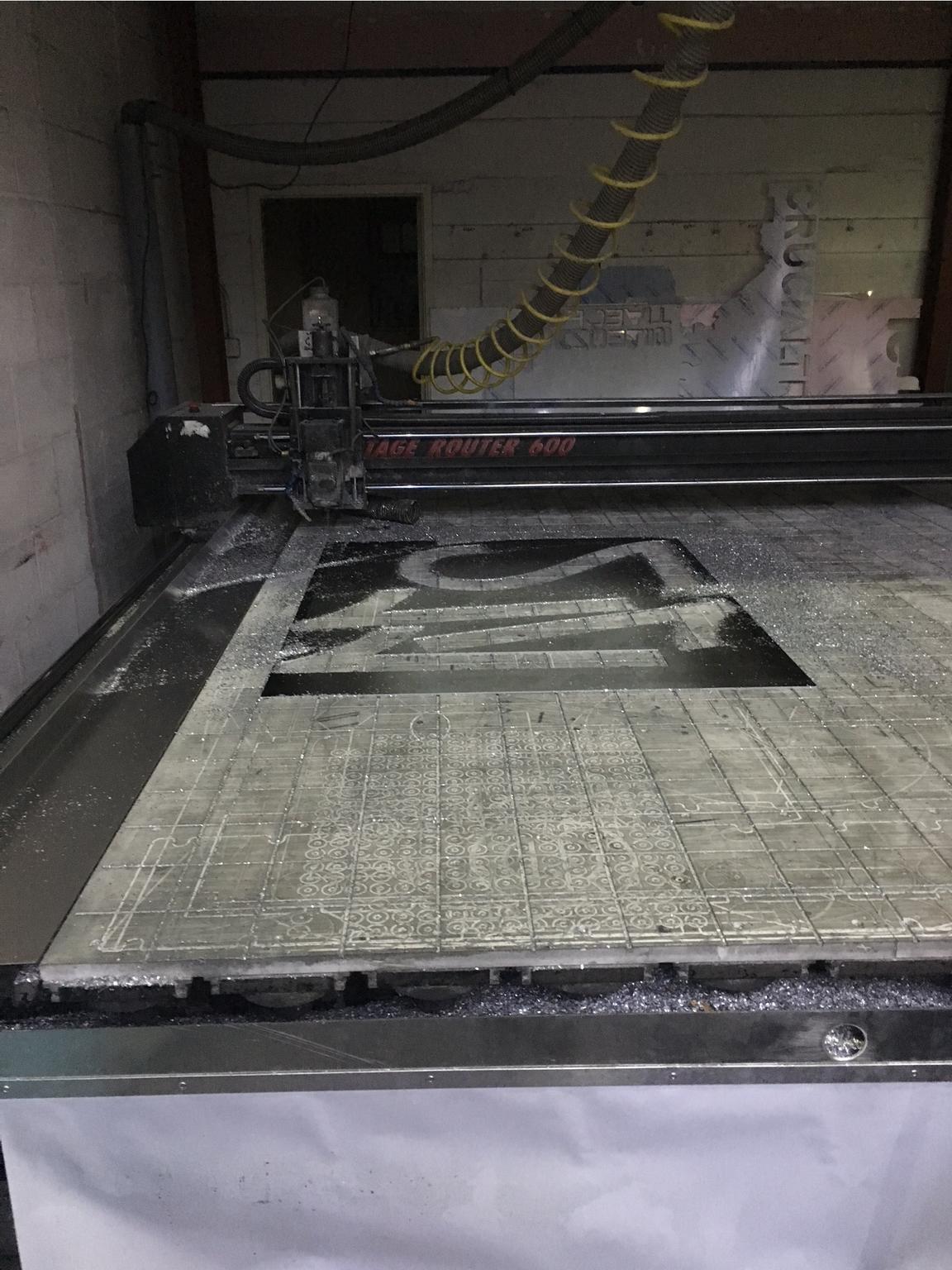

    This is my router bed, 3mx2m in 19mm foamex, I cut a grid with 100mm centres for easy reference to keep things square, I cut a lot of sheet material 3-25mm, I prefer to screw things to the bed, in the slot 5mm deep, so there is liitle chance of movement of the panel and clamps are more bulky and can slip.
    My machine has a vac bed, however I've learnt of the years it's not 100% reliable to stop movement of the panel, 1 screw up and it's all over, I cut quite a bit of aluminium sheet with mist coolant so don't use the the chip collection system, I do use it on dry materials like perspex & mdf.
    BTW I conterbored it to the aluminium slats with Tec screws which are about 10mm from the cutting surface, then milled the bed flat
