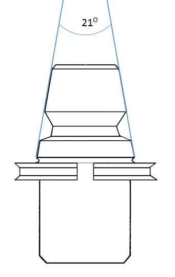

    Measured the angle and although it might not be dead accurate, it reads 21 degrees.
    (Se Attached sketch)

    I've measured one of my Coventry Easy Change at 20 degrees

    Standard BT tapers are 7/24, which going by my calculation, works out at 16.26 degrees.

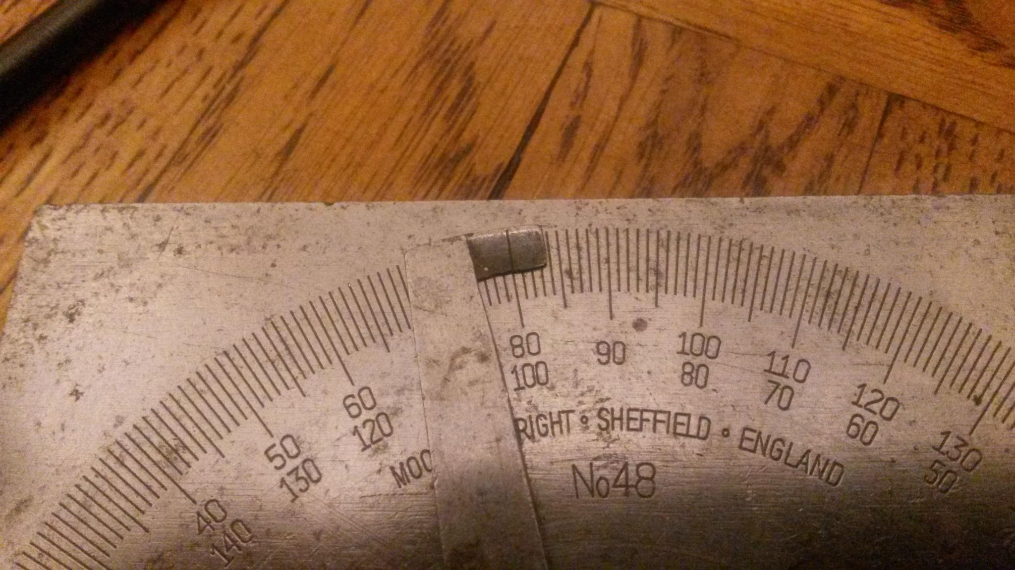

    I've measured Coventry Easy Change and BT30 for comparison/reference with a Moore & Wright Angle Thingy, here's the photos -
    I used BT30 because it's the "Taper Which It Definitely Isn't" which keeps getting rolled out here, it mystifies me and I was tempted to use a MT3 taper, but I'll go with the flow ;-)
    This is why i suspect the tool holders to be Coventry.
    My measurement was not accurate holding 2 steel rulers along each side and then measure With a School Plastic 180 Degree Protractor.

    Your dimensions are almost exactly what I get off the Coventry Easy Change if I try to measure where you have using digital calipers.
    Because of the problems measuring the top edge of a frustum with calipers I chose to measure the OD in two places where an easily measured OD is available, at the bottom edge of the taper and the top edge of the groove, with a micrometer then measure the vertical distance between the two with a vernier, that gives me a calculated angle of 10.02 degrees. (Once I'd downloaded a decent calculator with inverse functions to my phone - what's the use of sine without arcsine Mr Samsung!)
    If you super-glued your two steel rules together in alignment with the taper you could draw a nice big triangle on a piece of A4 and measure/calculate the angle ;-)
