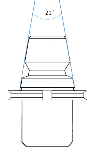

    It really wouldn't surprise me if Boxford used a custom taper and holder design, just so you had to buy holders from them.
    I think Boxford and Coventry used to collaborate previously(at least) on toolholders.
    I seem to remember a chap talking about some Coventry toolholders for his VMC190, and i think it`s the same toolholder.
    Still havent got any answer from Neville at Coventry yet though.

    The Coventry Easy Change system was fitted to lots of machines, however it doesn't use a pullstud, which is why my money is on some form of Boxford specific custom holder.
    Boxford aren't exactly renowned for using established standards.
  3. The Following User Says Thank You to m_c For This Useful Post:
    The presence on the Boxford holder of the locking ring groove in the same place as on the Coventry holder when with a pull stud it isn't required makes me suspect the Boxford is a modified Coventry, anyone conversant with, say the BT30 holders would recognise that the slot is redundant and that it would be absent on a fully custom-ordered part ;-)
    Also there are the suspiciously thin walls above and below the tool changer disc slot, intriguingly designed to fit into the standard Coventry holder drive disc size and position :D
    I'll put a fiver on the Boxford being a modified Coventry
    Got answer from Coventry today.
    The toolholders are custom made for Boxford.
    Production stopped in 2012, but they can make them at 156£ each with the groove. However, i strongly belive it's the same as their standard Easychange toolholder(without the groove).
    I will order 1 and check similarity with the ones i have. For nearly 60£, i could could even fix that groove myself in my lathe.
    The pullstuds however is a Boxford product according to Coventry.
    Will have to make them myself ��
