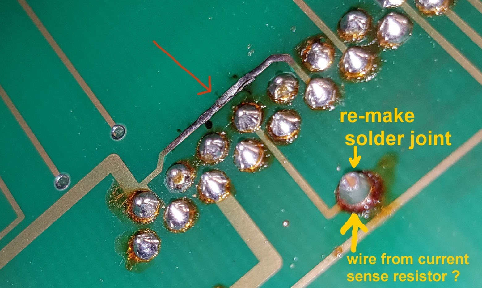

    after looking at the latest photo
    in addition to adding a wire link to replace the damaged track
    I would resolder the current sense resistor as well
    John
    PS
    if you switch the two X motors now
    then if it fails again you will know if the fault goes with the motor

    Looks to me like that track had a problem, someone tried to fix it by gobbing solder over it, found the solder wouldn't bridge the gap until some of the tin had boiled out of it, so he delayed and destroyed the glue holding the track down to the PCB.
    After 30+ years soldering for a living I could fix that in a jiffy. OTOH I can remember what it was like when I started so I feel your pain

    Thanks Graeme. Much apreciated. I read a few things about the mica washers not being as effective at getting the heat into the sink, hence the idea of just having the thermal compound. But you are right i will not start messing with things like the grounding in a system that i already dont trust lol. Thanks for the info on testing the wires, im pretty good with mechanical things but electronics baffles me at the moment.
    Hi Robin, thanks for the input. You know now that you say it i dont know why this didnt occur to me that this looked like a previous repair. But it does look like a soldered over track and the solder gas blown, but again i guess its back to what caused the first failure.
    Anyway i will report back what happens

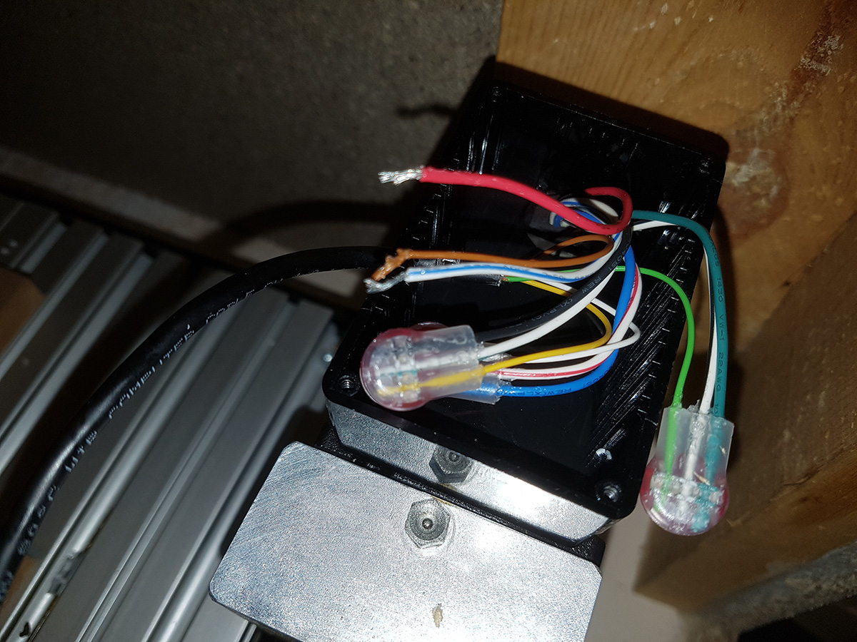

    Hi guys just a quick update and a query, i have cut away the broken track as suggested and eventually after a bit of trial and error have managed to solder a jumper nicely to the right terminals on the back of the pcb, quite a task as the pins are very close together :-o. replaced the IC chip and also upgraded the cooling by having a much beefier fan suspended from the top of the contol box onto the Driver chips and heatsink while i was at it.
    I am now checking the wiring on the suspect X axis motor, i have attached a picture to show what i am dealing with, i want access to these termianals but they are burried inside these 3M terminal blocks, i popped one out and the brown driver wire literally just fell off whereas the other two needed a bit of removal force, so i guess even that brown wire could be a potential short. To be honest im not too impressed with these 3M terminals, they seem a bit fiddly and precarious, what kind of terminal are you guys using for this, wouldnt something i can get a tester on at a later date without having to rip the thing apart be more suitable ?. Id like to remove them all to test the cable and replace them with something a bit less permanent and more robust if possible

    Not sure the picture got attached. Interested to see what you're dealing with before offering suggestions.....
