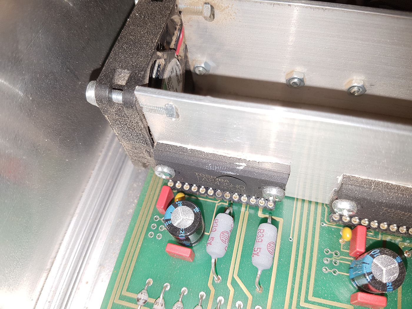

    My Machine is a Heiz S1400 and until today it has been fairly trouble free, however during a cut today the x axis racked and stalled.
    I have twin steppers on the X axis and at first i thought i had narrowed it down to one of these steppers, however on switching over the control cables and seing the propblem move from one x axis stepper to the other i then realised it was an output problem frm the control box.
    I have taken the control box apart and the first thing i have noticed is what seems to be a circular crack in one of the driver chips TA8435HQ.
    Is this likely to be the culprit ?, all 3 other chips seem intact
    and if so does this need replacing with exactly the same chip as the others are TA8435HQ too.
    i am assuming this will be a relatively simple soldering job, just desolder the old one and replace?
    I will upload a picture of the chip in a minute

    Here are the pictures
    Can't answer that but you can buy them here:-
    http://www.ebay.co.uk/itm/1PCS-TA843...-/251057536704
    I would also check the current rating you have set.

    I'd say it's definitely the first thing to try - that driver chip is clearly dead! Looks from your photos like they are socketed though, so no soldering required. Just remove the old one and replace like-for-like, being careful not to bend any of the pins.
    Also, check to see if the chip needs to be electrically isolated from the heatsink. Some do, some don't - take your lead from what is currently there, and if the back of the chip is metal. If it needs to be isolated, then there will be evidence of an insulating pad or washer used between the chip and the heatsink, and then you need to take a lot of care when you fit it all together, testing it for isolation with a meter. But maybe it is just bolted together. Looks like there is at least some heatsink compound used, but what lurks in between is not visible in your photos. Try and salvage as much of that as you can for the new chip - ideally you'd buy a small tube off eBay and smear it on to help conduct heat from the new chip.
    Hope that helps!
    Graeme
    Thanks GND and Clive S. Yeah that will be handy if the chip is socketed, im crap at soldering to be fair. I think they are just bolted together with small bolts with thermal compund between the heatsink. I have a tube of MX4 Processor compound from building PC's so im thinking that would work.
    That chip definately is the one leading to the X axis output with the problem so i will replace it and see if that fixes it. There is one on ebay available from the uk but it is missing the Q designation at the end so not sure if it would be ok TA8435H rather than TA8435HQ. I will order one of the ones Clive suggested but might be a little wait for that one to arrive.

    I had a quick look at this device's datasheet, and the only difference between the H and the HQ versions seems to be that the HQ is tinned with lead based solder, so it's not "lead free" as is required these days for commercial use. But for your purposes it really makes no odds - go for either and you'll be fine!
    It also said that the rear of the chip is metal and connected internally, so you need to take precautions. However depending on what the heatsink is connected to, then it may have been designed to be non insulated, as that part of the chip appeared to be grounded. But just be aware of the options here!
    Thanks GND, i have ordered the untinned one and will try that. I will look at the other other chips for guidance on how its connected to the heatsink.
