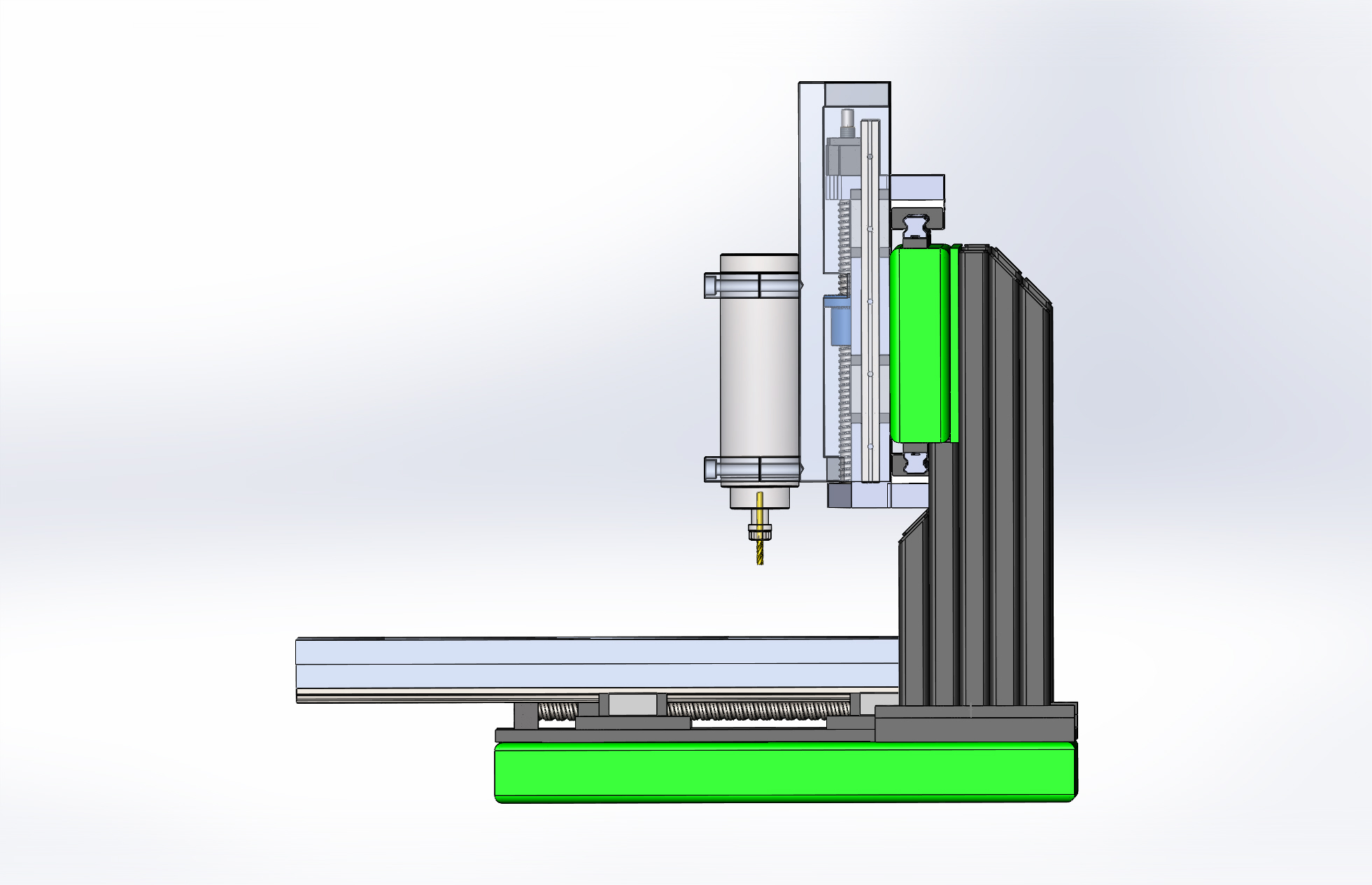

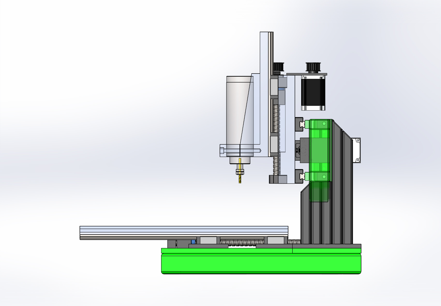

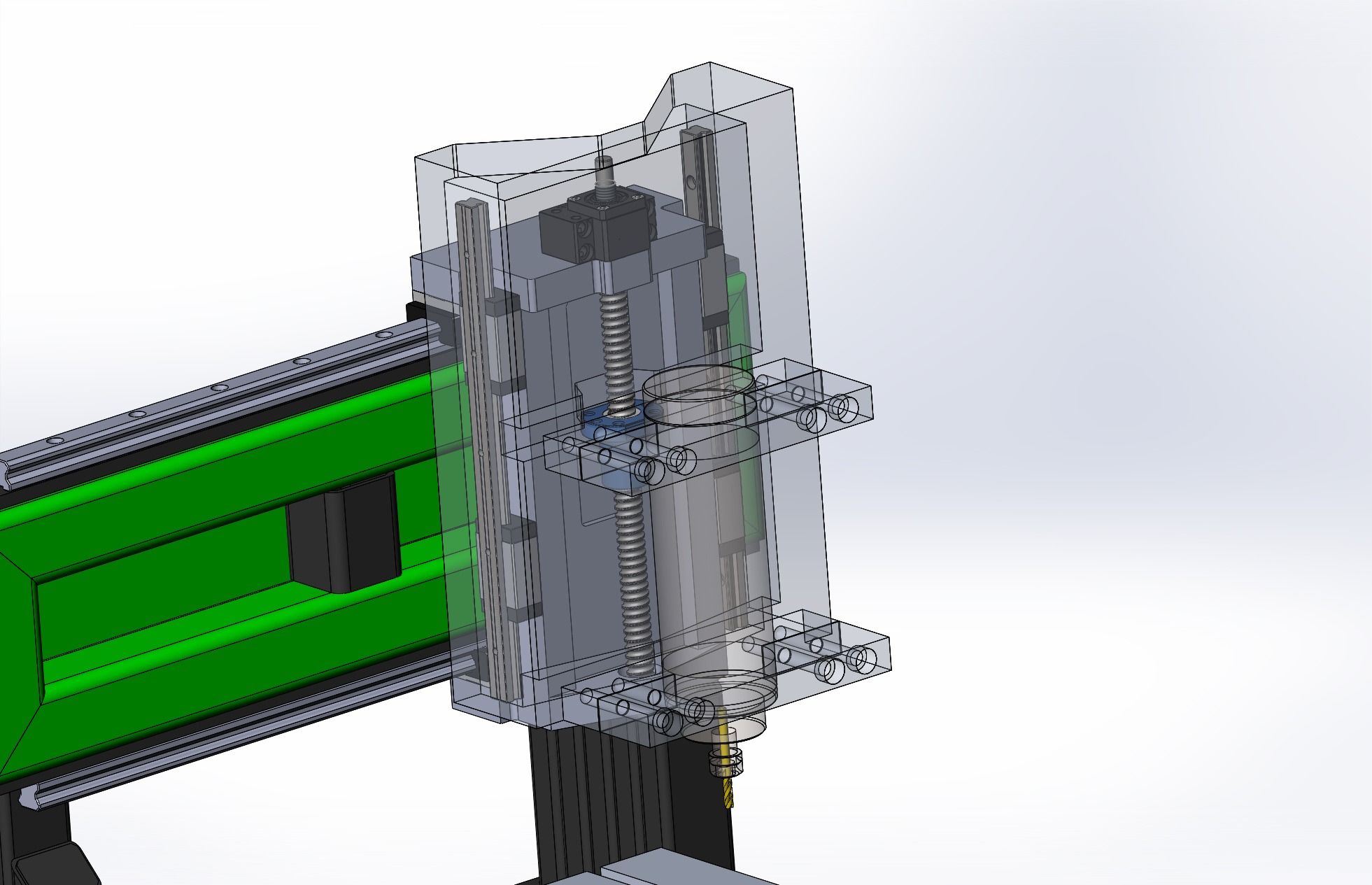

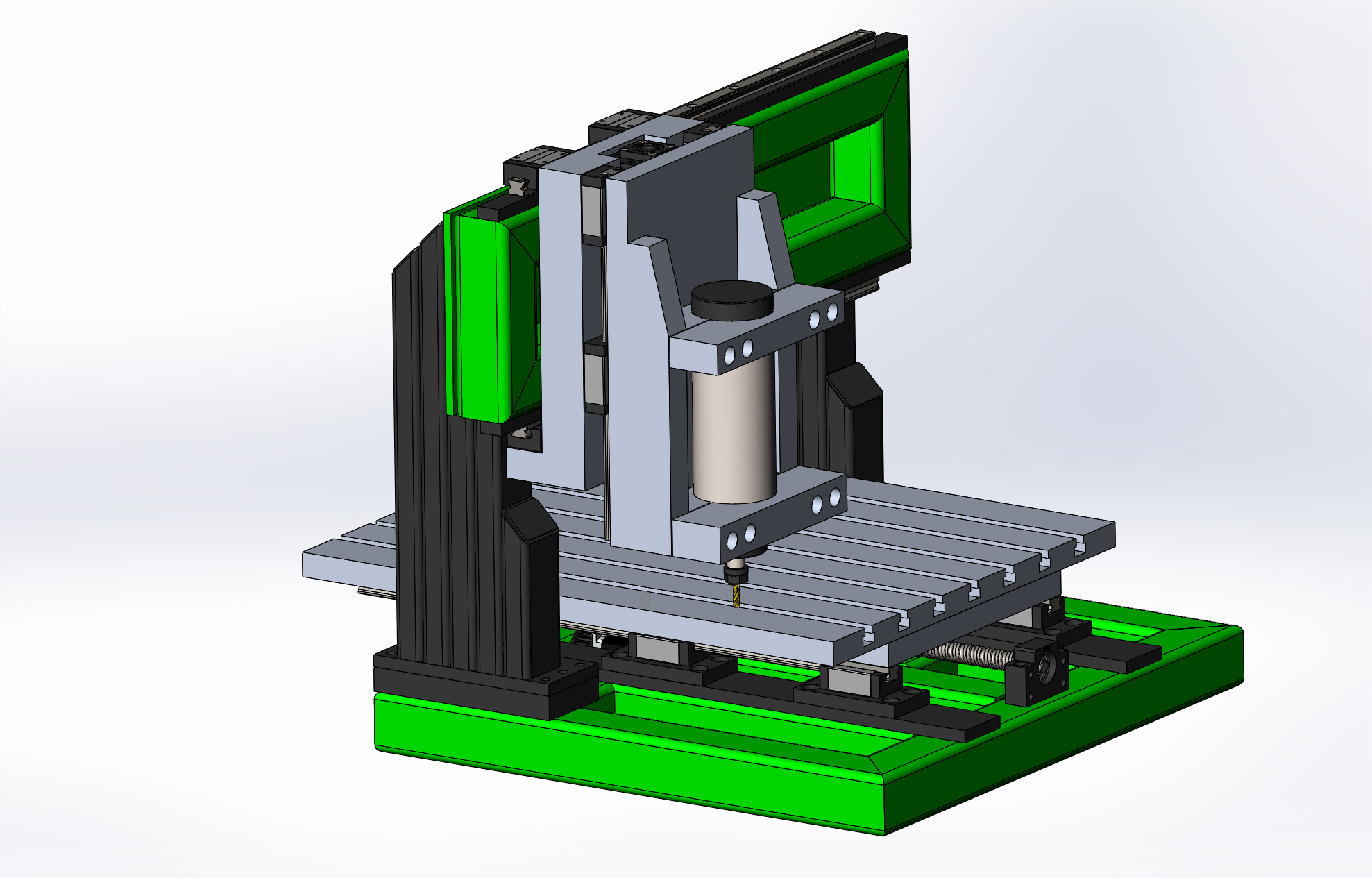

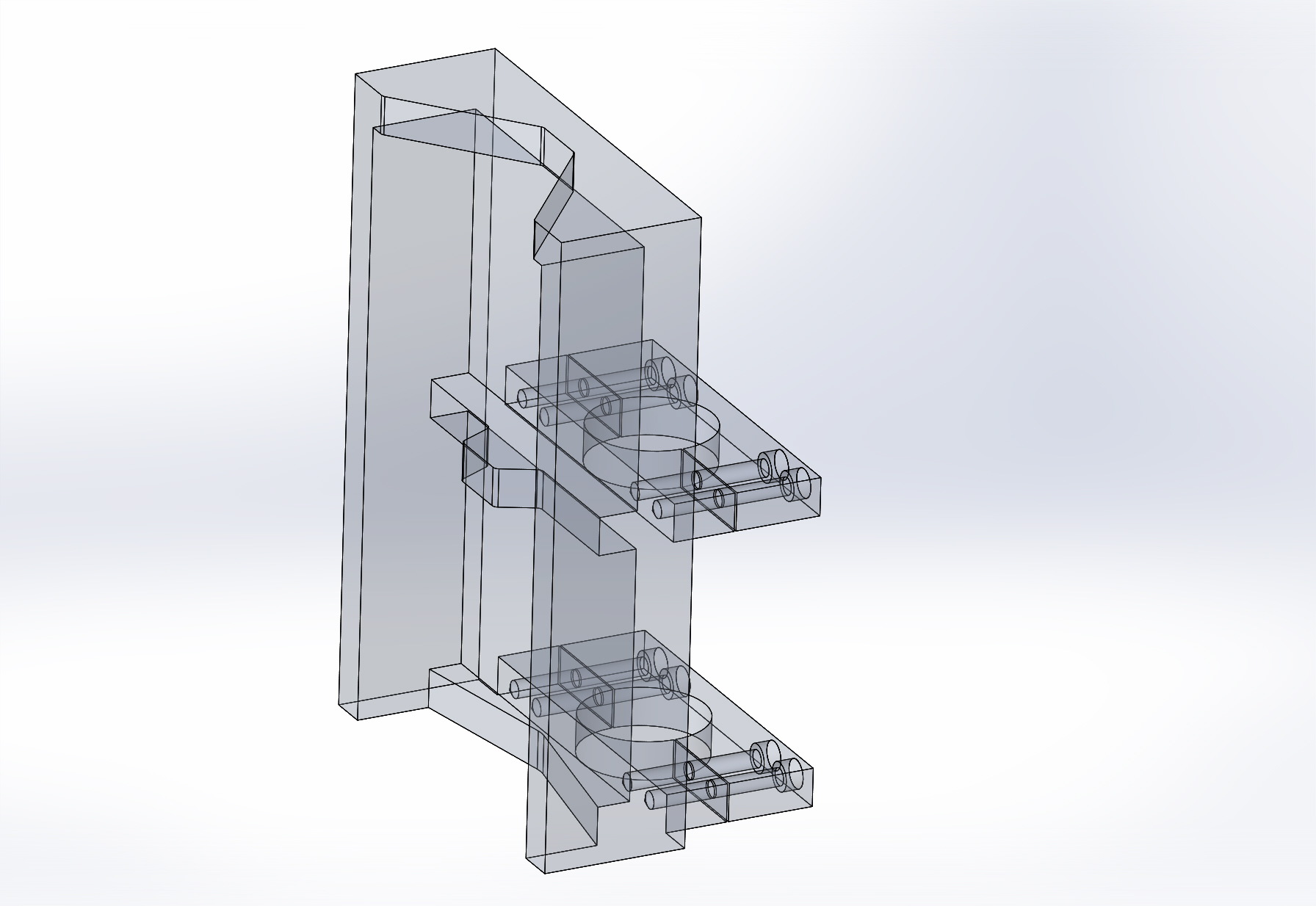

Hi

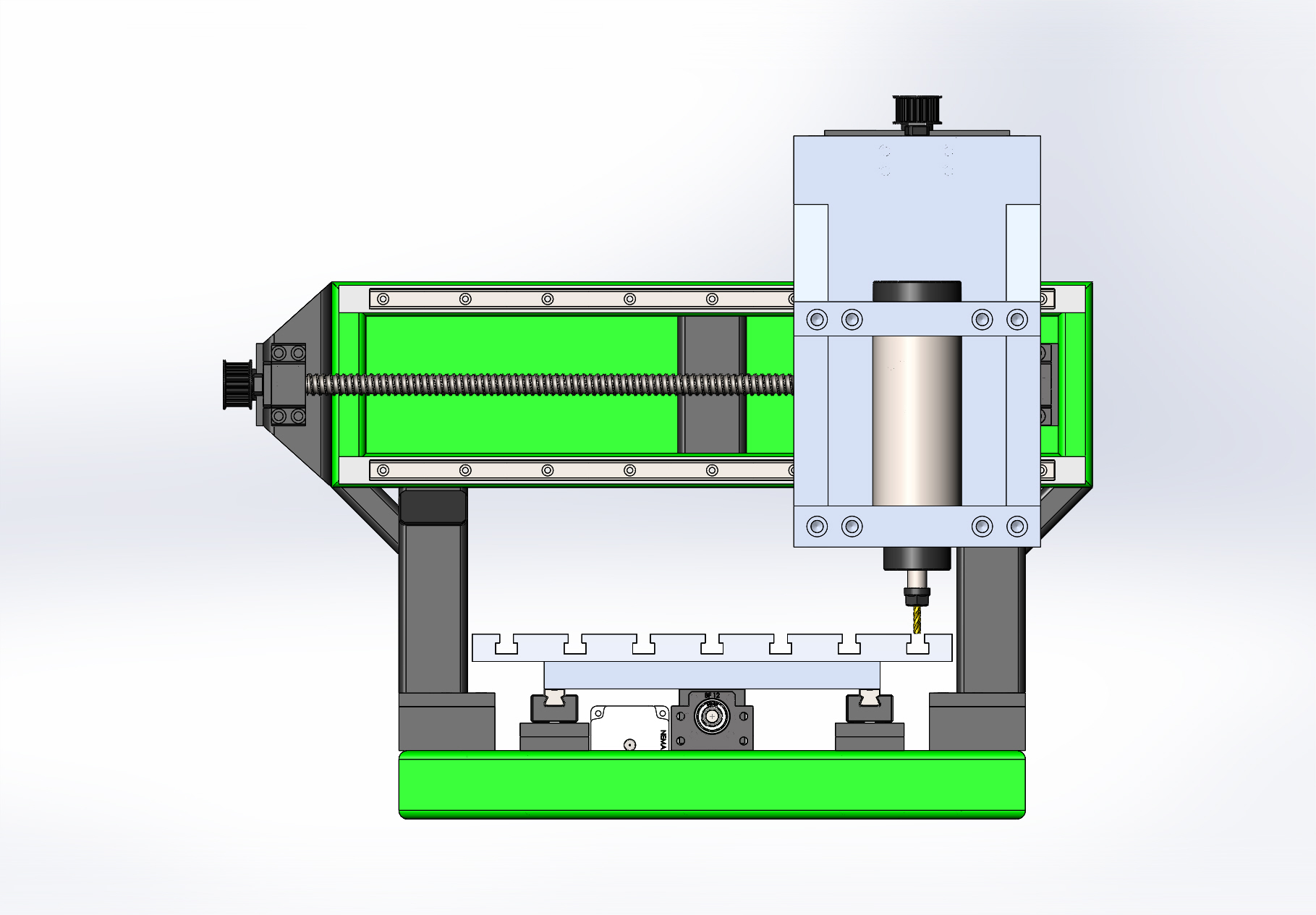

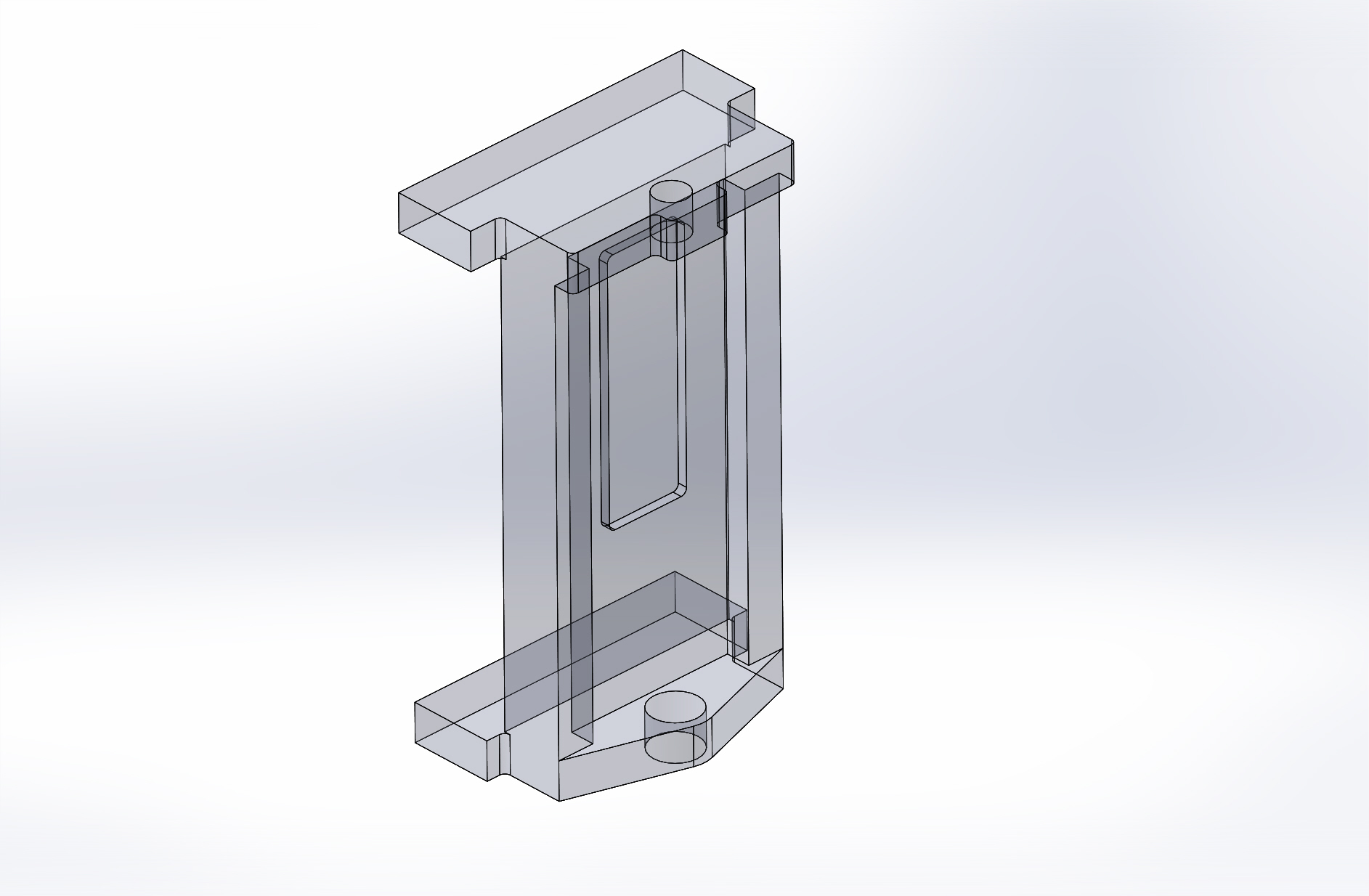

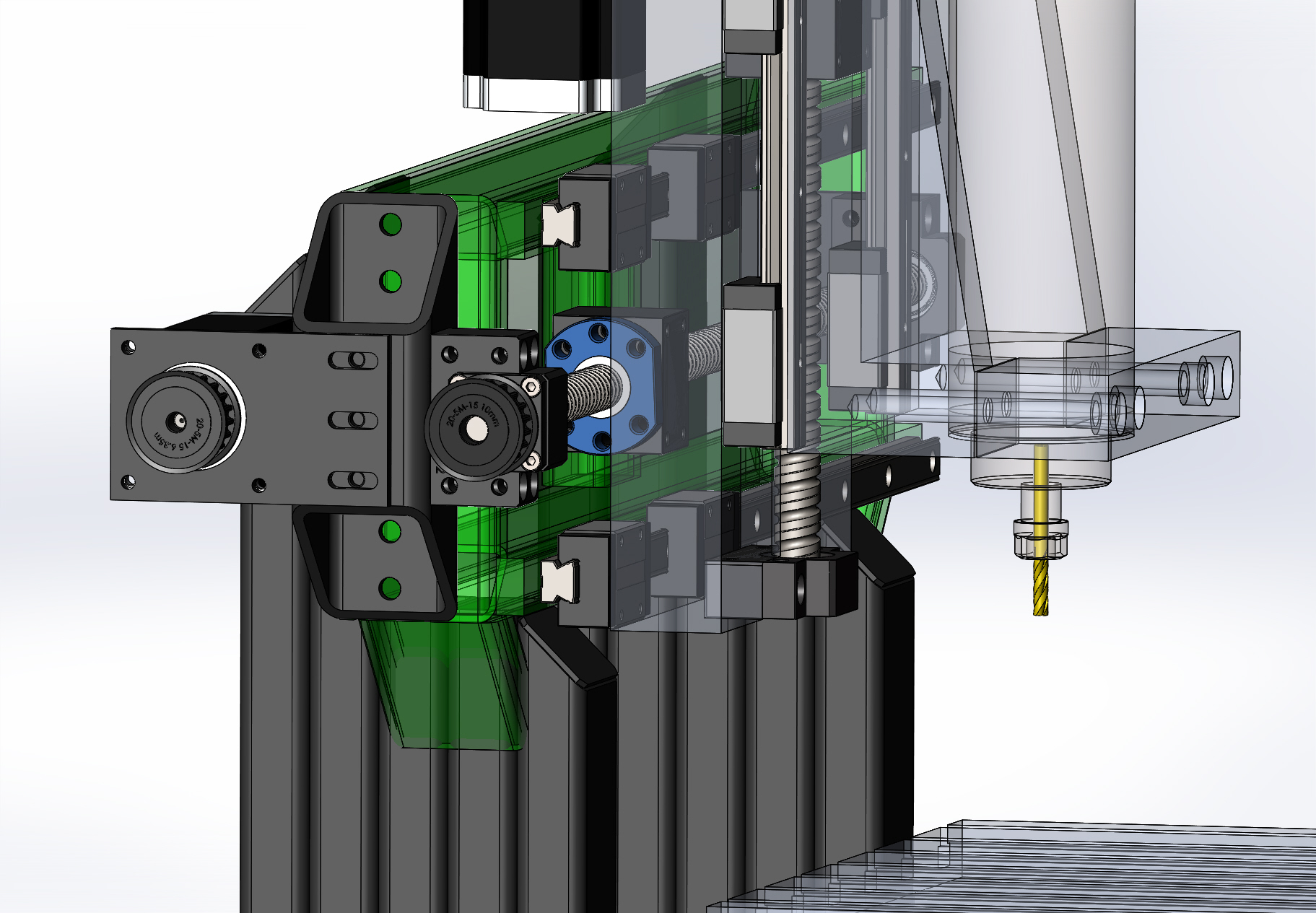

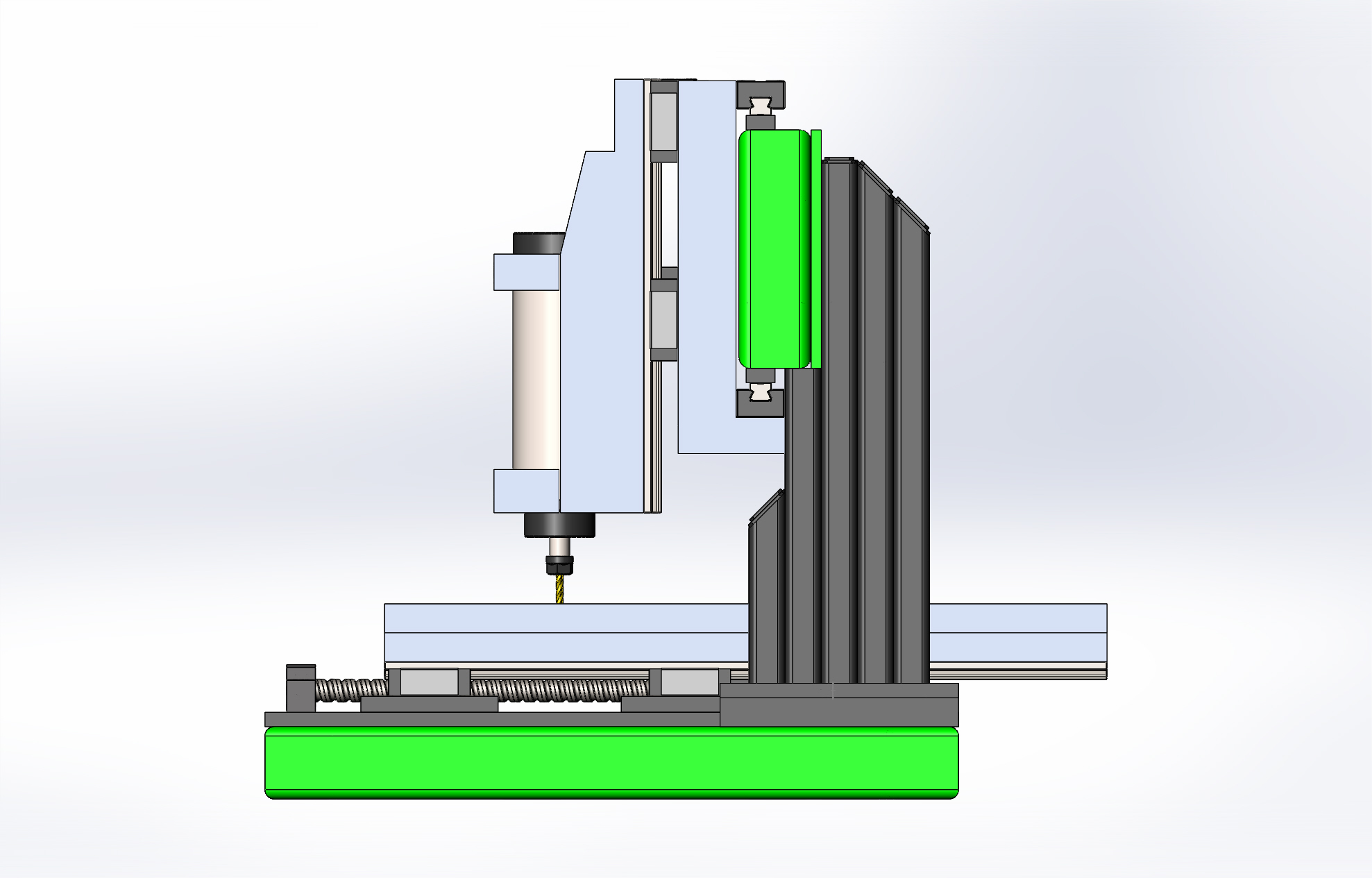

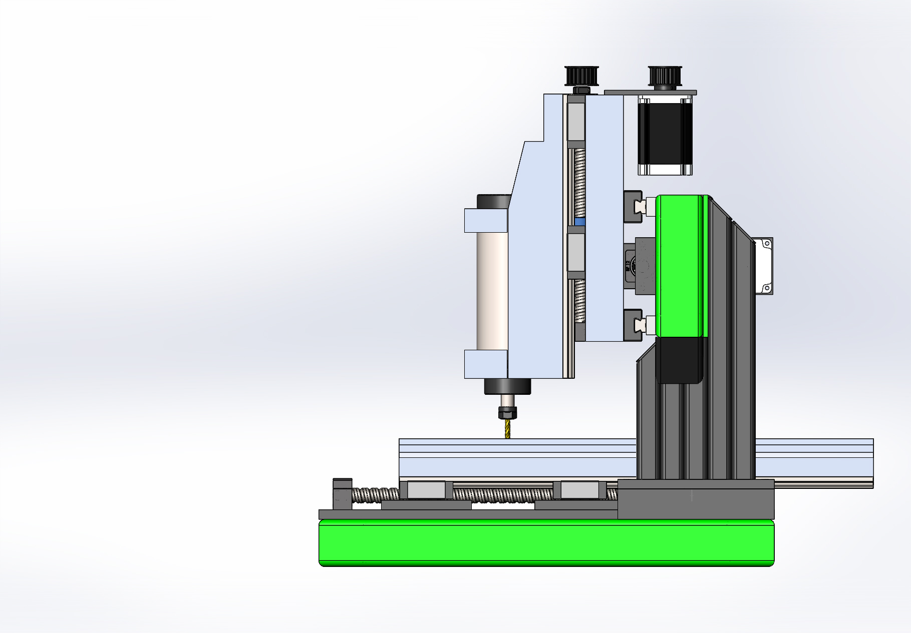

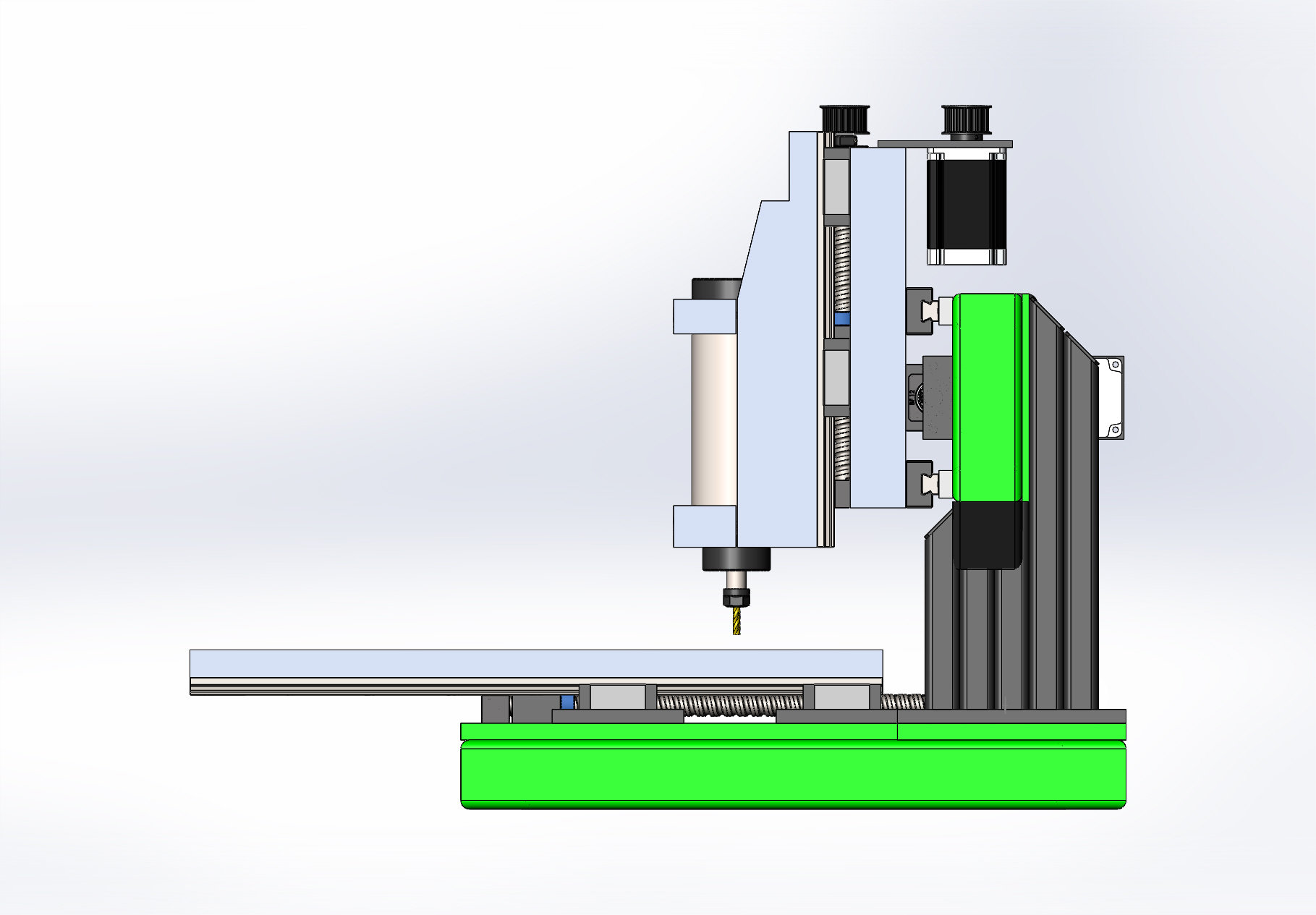

I would like to present you the 2nd version of desktop size router designed by myself in SW.
Hoping to mill aluminium as hardest material.
Parameters:
Working area 320x250x100mm (X.Y.Z)
Hiwin, HSR or THK 15mm blocks on Z
Hiwin, HSR or THK 15 or 20mm blocks on X
Hiwin, HSR or THK 15mm blocks on Y
3A steppers (8 cables bipolar parallel) Nema 23
Ballscre RM1605
Belts HDT 15 T20 1:1
Spindle Chinese 1.5KW water cooled
frame box 50x50x4mm
Digital drivers
CSMio/IM-M
Torus trafo 420
Soft start
Pliz safety relay
AB 24V DC
Power relay
I am limited with working size due to size of Milling machine.
All will be tig welded work started, but need your opinion before is too late.
Thank you for comments.
