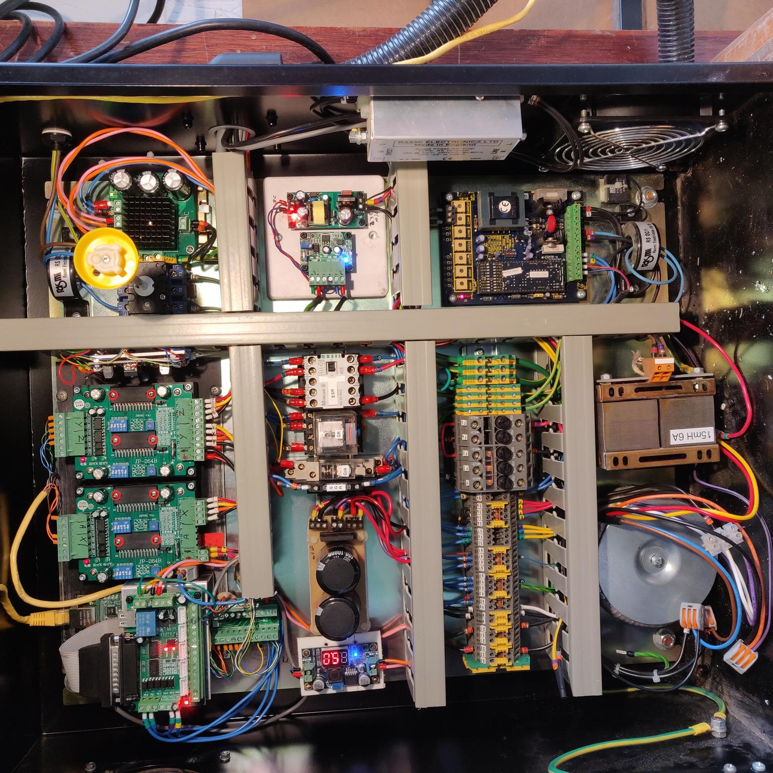

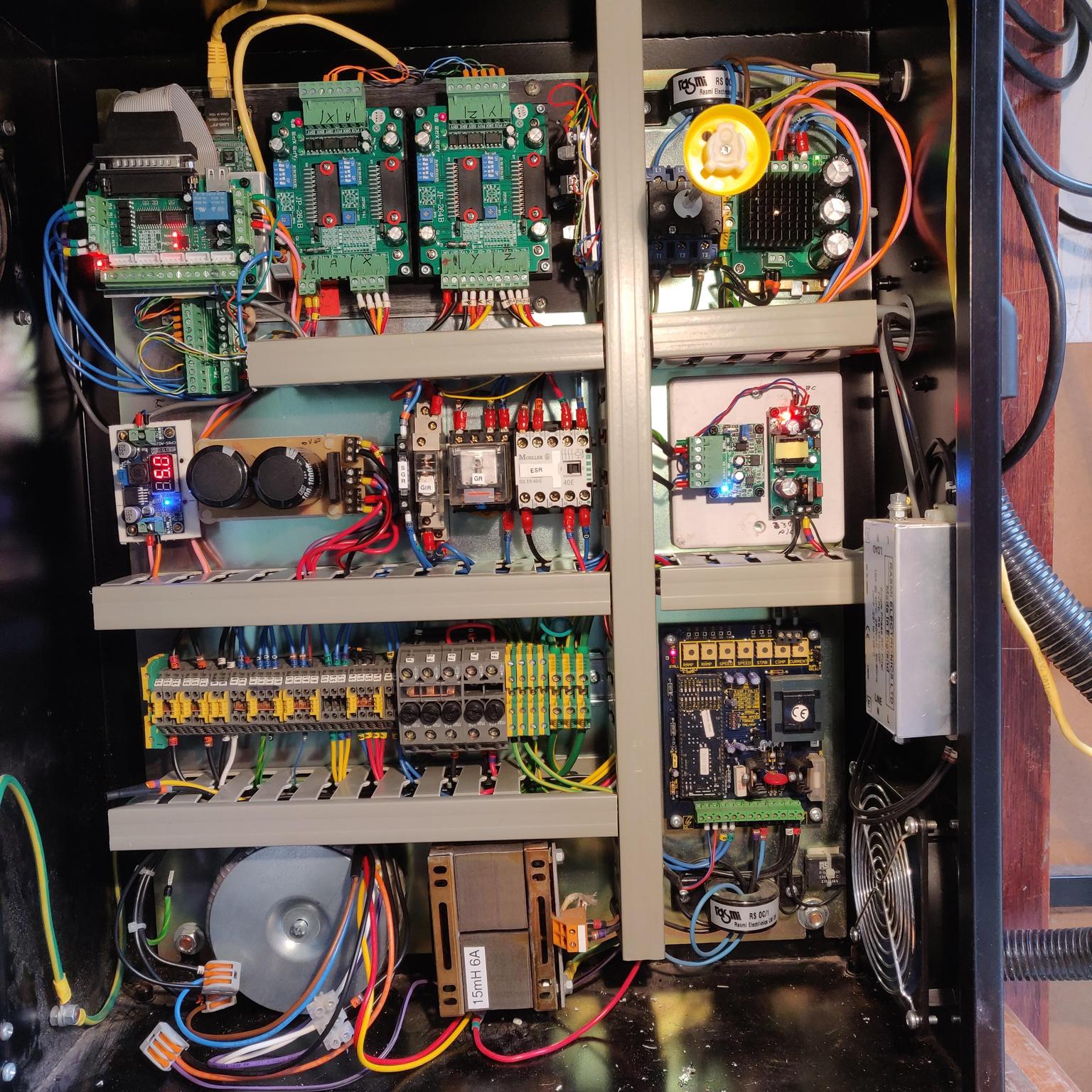

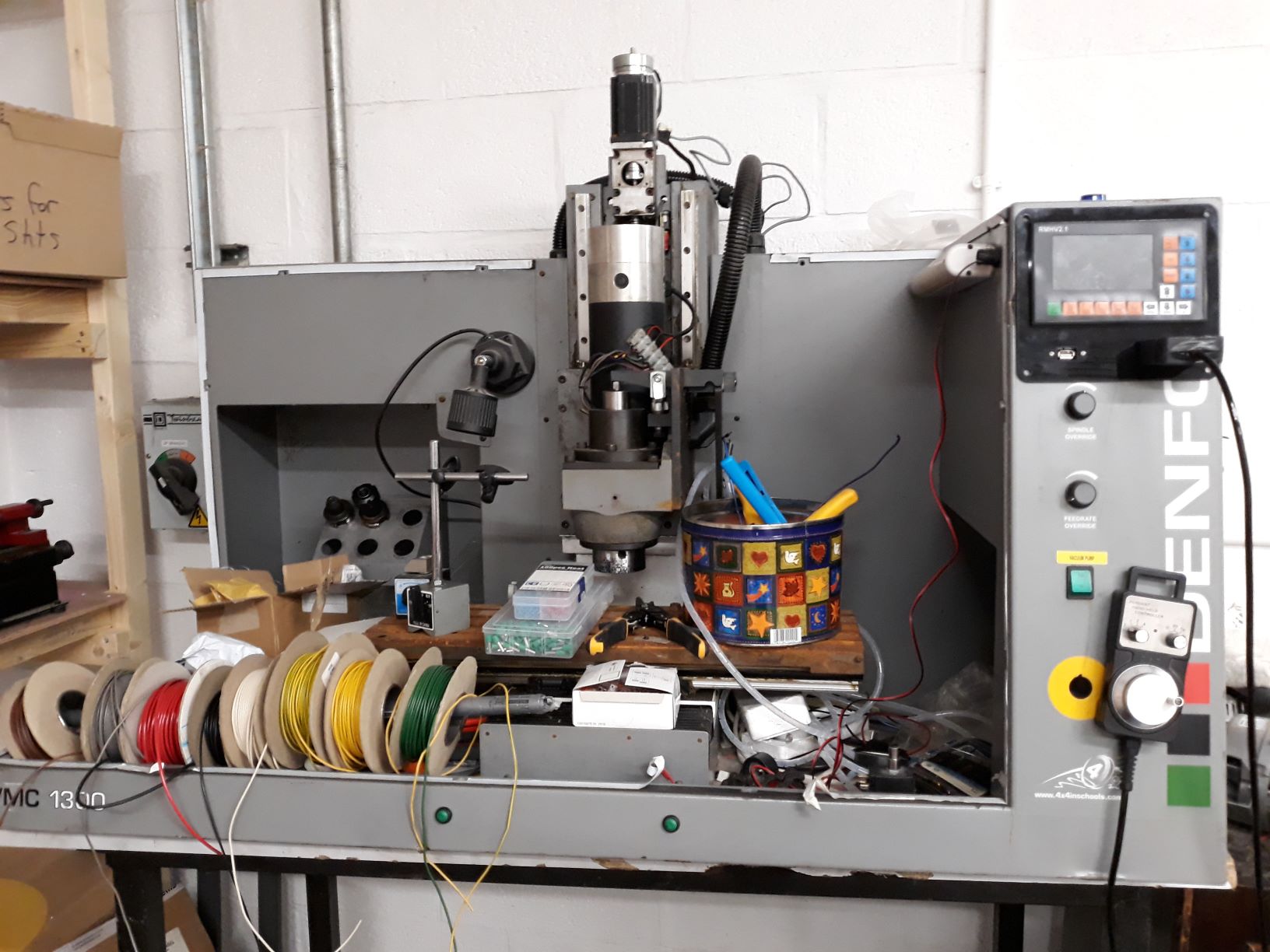

    Well only two years later and my mill has become my primary project and I have made some progress.
    I have the RMHV controller hooked up to the EM806 drives connected to the original steppers. I have also connected the home switches. I have used the original power supply and relay board for this.

    This gives me the following good things.
    1) Movement on all three axis
    2) Control of all three axis using either the buttons on the controller or a MPG pendant
    3) Homing set up.
    What isn't so good is
    1) the z axis brake is errrr .... broken (I managed to loose the spring that applies the brake)

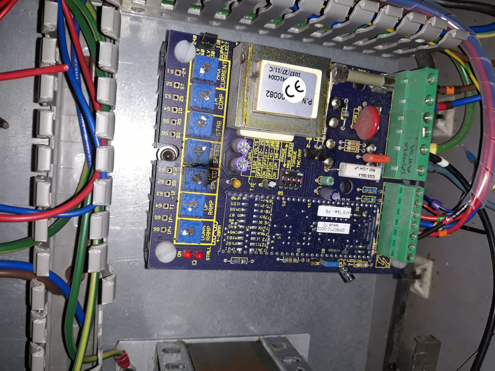

    2) More of an issue is I let the smoke out of the spindle dc driver. The good news is they are still available off the shelf the bad news is they cost about 200 quid....

    I have a replacement (https://www.transdrive.co.uk/shop/pr...q-non-isolated) and I'm in the process of wiring it up.
    To start with I have copied the settings (potentiometers and dip switches) from the old board but I'm now beginning to doubt the wisdom of this as the old board died on me and at some point previous to me finding it on a scrap heap someone has written the word BAD on the heatsink.
    I'll need to find some info on the motor as the old board is set for max voltage of 50V which seems a bit low (ISTR Triacs go up to 180V). I'm also trying to figure out how to use the 0-10v output from the RMHV controller to set the speed as I'm not sure if I need some form of isolation between the two.
    Hopefully I'm not too far from being able to cut some chips although I'm starting to think that I might be better off using MACH3/4 or Linux CNC rather than the rather limited RMHV controller.

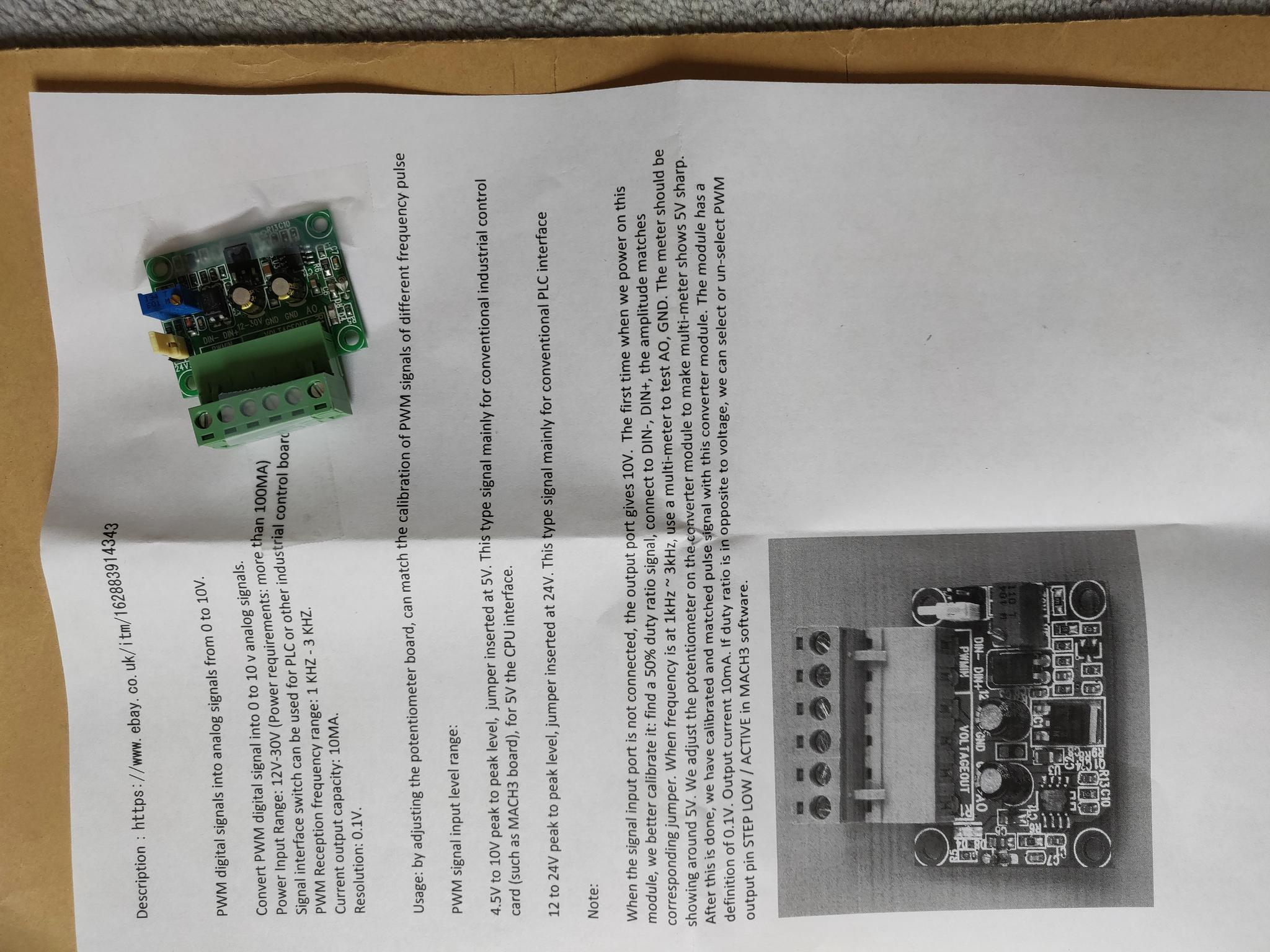

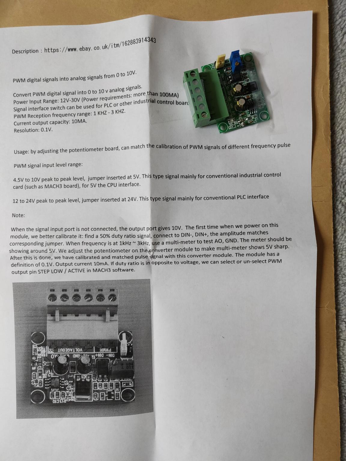

    I have just converted a Novamill that seems to have had the same control board. I used one of these https://www.ebay.co.uk/itm/111654184682 and a small 230V ac to 15V V DC power supply https://www.ebay.co.uk/i/26304063959...r=562044038463 so to keep the isolation from the motor control board.

    Not sure what you mean here, would you mind elaborating please.. I used the pwm signal from my bob and the https://www.ebay.co.uk/itm/111654184682 to convert it to 0-10V isolated for the spindle driver board.
    Does that board isolate the PWM in from the 0-10V output?
    I'm not sure if the 0-10V output from the DDCSV/RMHV will be compatible with that board. It would depend on if that board is simply relying on referencing the PWM voltage (should be fine), or measuring the actual PWM.
    Actually, I've just checked the spec of a DDCSV, and it states the spindle output can be configured as a PWM, instead of analogue. I can't find any mention of whether it's isolated though.
    The problem with SCR type drives, is the far more common non-isolated versions have the control wiring at near mains voltage, so your 0-10V source has to be isolated. Denford did use isolated drives in some machines, so yours may have an isolated drive, or your BOB PWM may be isolated. The only guaranteed way to check without knowing the exact board you've got, is to power the controller up, and then measure the voltage between the speed control terminals and ground (or neutral/0V).
    This morning I checked the voltage between 0-10V and earth about 200V and between PWM and earth 1.5V so it isolates the two.

    This morning I checked the voltage between PWM and earth about 200V and between 0-10v and earth 1.5V so it isolates the two.
    Good to know.
    Although I assume you meant to have those two voltages the opposite way around? ;-)
  11. #30
    Good to know.
    Well spotted. I have edited mine would you mind editing to save confusion for others.
