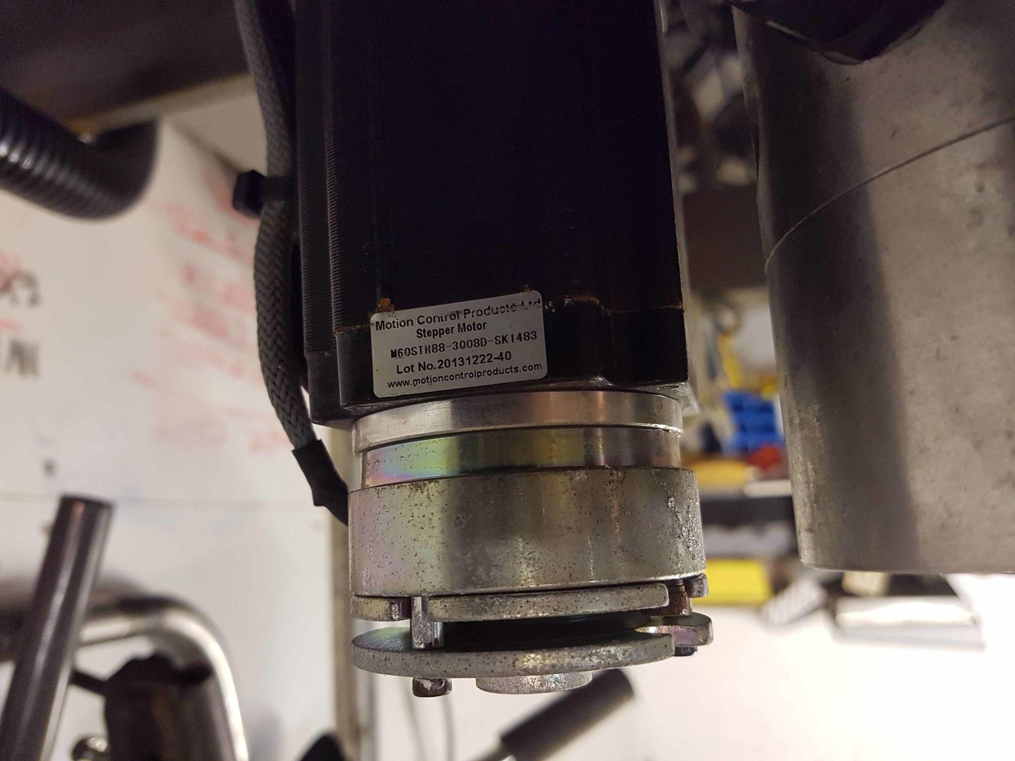

    That datasheet should be good enough. The main thing is once you have the machine running, make sure the steppers aren't getting too hot.
    Is that a brake assembly on the end of the stepper?
    You'll want to check the other stepper motors, as X and Y are often fitted with smaller steppers than the Z.

    No idea about the end of the stepper,
