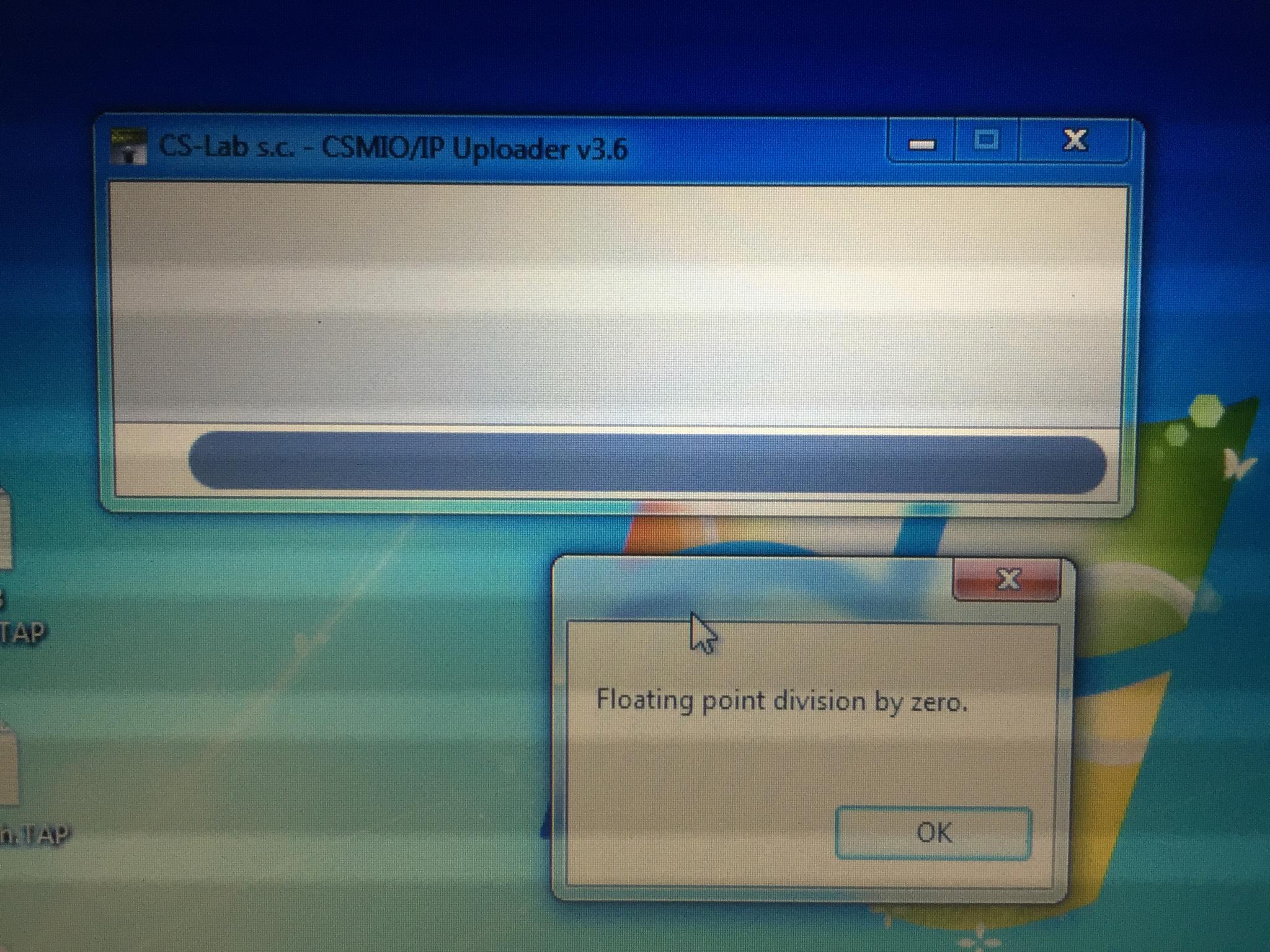

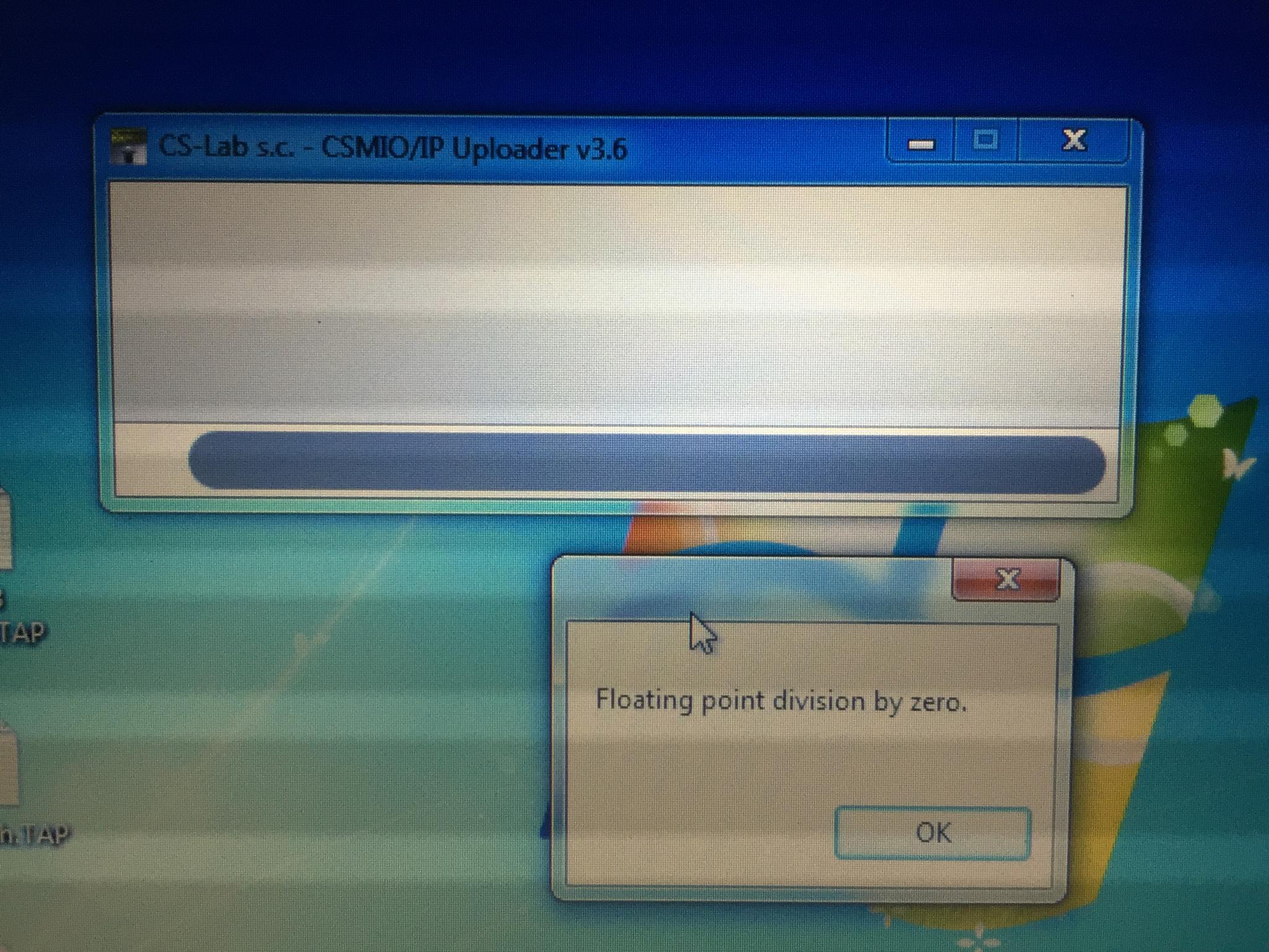

    Was about to use my CF19 Panasonic Toughbook with CSMIO-IP-M Firmware uploader v3.6 end got this error message
    Floating-Point Division by Zero
    was googling solutions for last 2 hrs and nothings seems to work.
    This uploader works fine on my PC workstation, I need use the laptop in the garage tbh.
    Any advice please?

    Try running as Admin.
    But if doesn't work then just upload firmware using PC. It's not something you update very often. Then ask Cslabs why getting error . I know there's alternative uploader because I used to use it. However this new one is much faster so use that now and never had any troubles and I've fitted dozens IP-M.
    thanks
    Just uploaded using my old laptop (both win7 64bit), works on workstation too.
    This is windows issue nothing to do with CSlabs, thread is long, mostly related to IE9, thought that somebody else had this issue.
