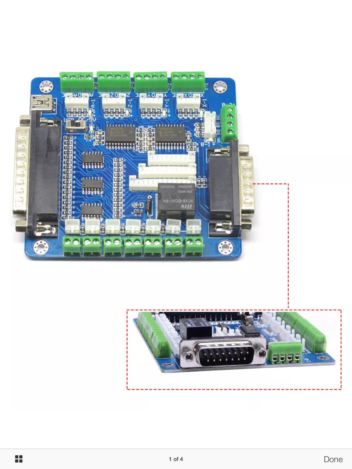

    I'm able to turn my spindle on and off from Mach but was wondering how to control the spindle speed that's the bob I'm using

    That BoB does not appear to have the 0-10v output needed to control speed. So the answer is probably - buy a different BoB.
    Like this one http://www.ebay.co.uk/itm/5-Axis-CNC...8AAOSwbsBXnbnv
    The BoB the OP shows doesn't do that job, in fact they are crap.
    The one Cropwell has linked to does the job far better, used loads of these and if you shop around you can get them as cheap as this.
    http://www.ebay.co.uk/itm/302090338358

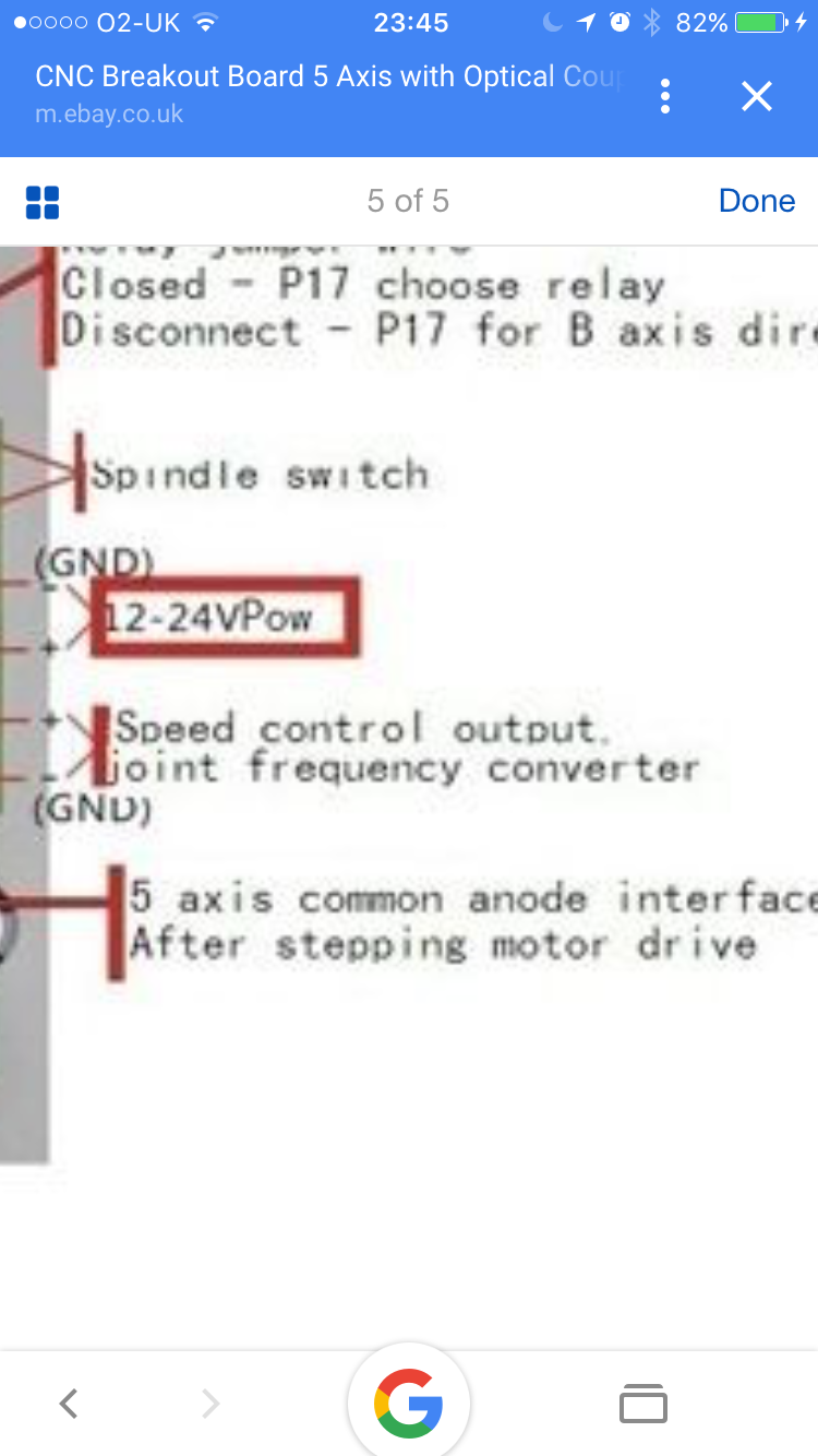

    So I guess it's all wired up the same. Where does the speed control outlet be wired to after the bob

    Depends on what spindle motor you have.
    If it's the high speed water cooled Chinese ones then it's to the VFD. If it's something like a Kress then you need a variable speed power supply
    Agreed - if spending more than £5 on a breakout board then you're probably doing something wrong.
