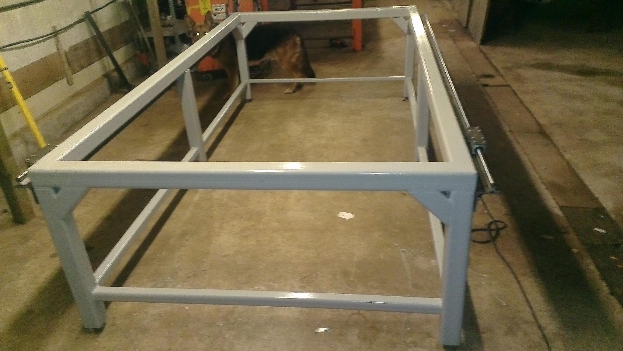

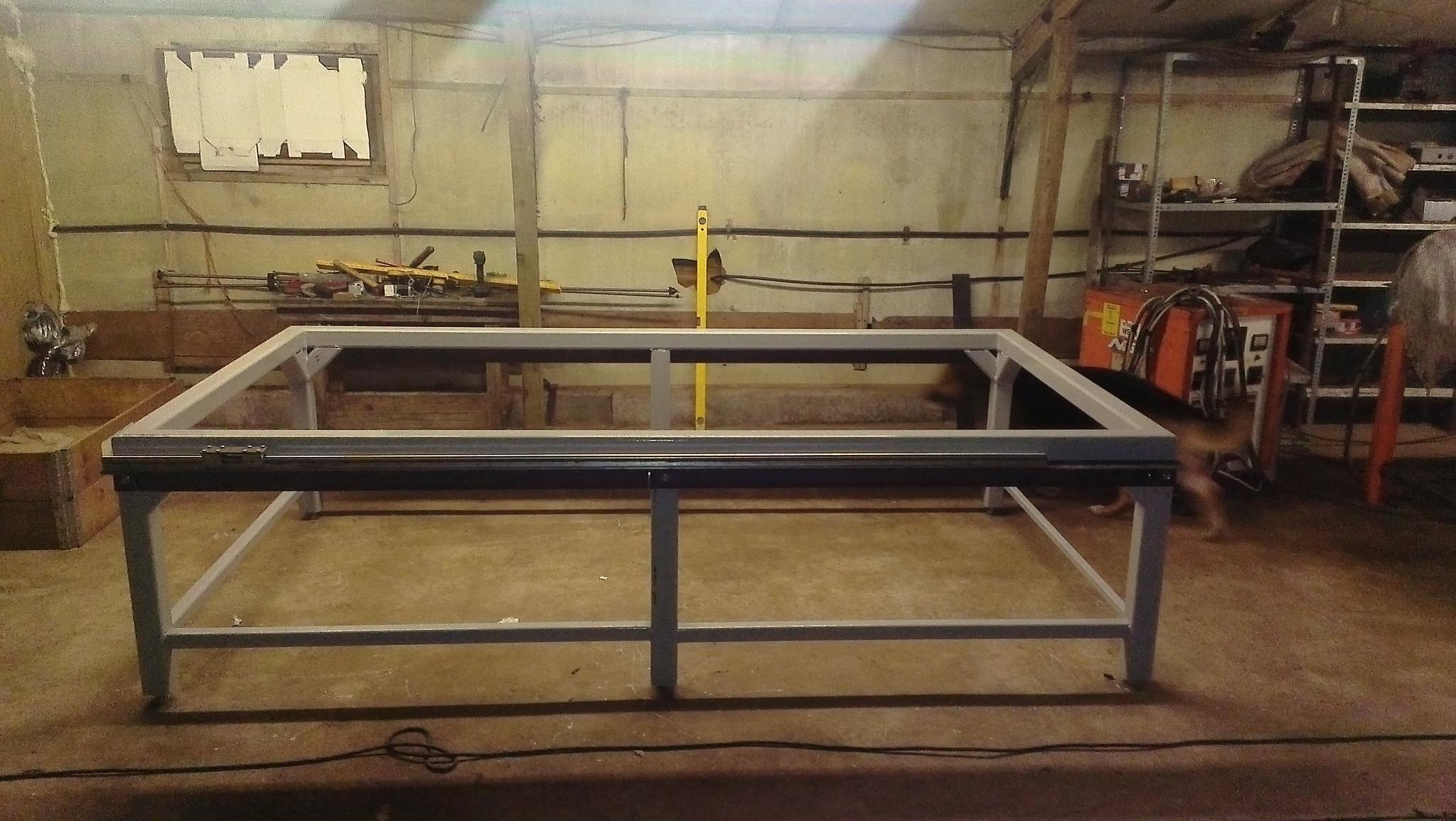

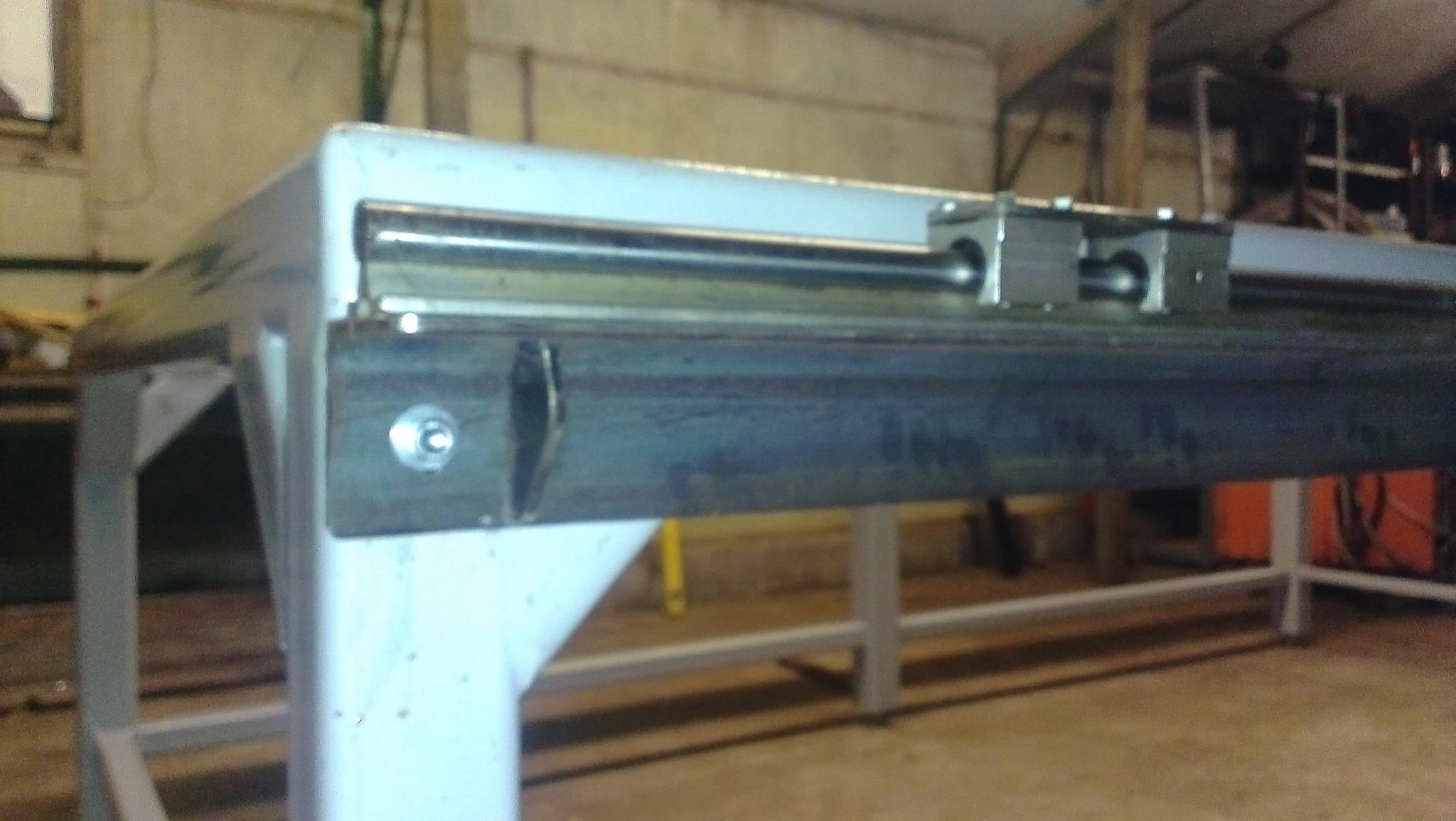

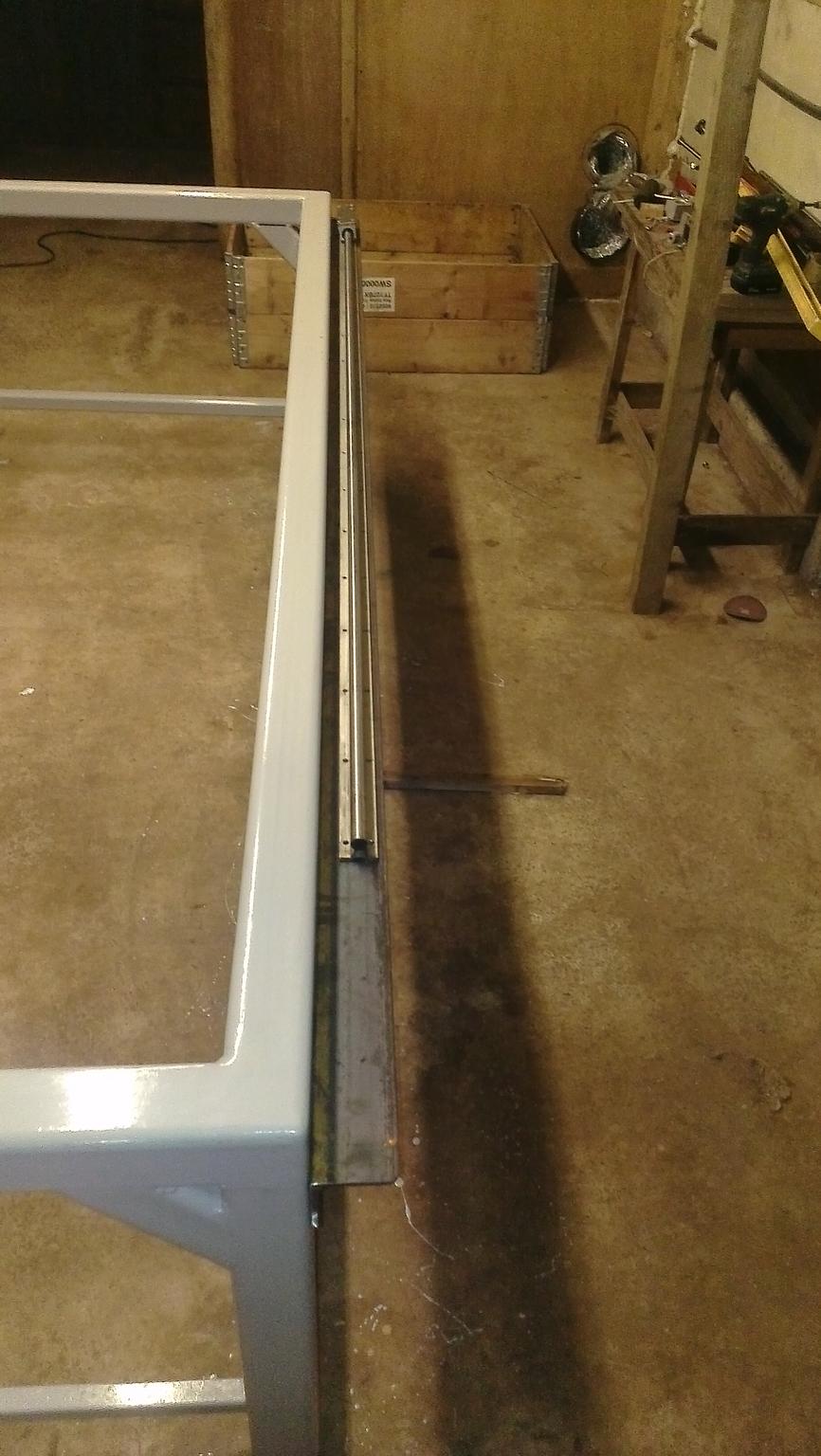

    hi, im building a cnc plasma table, its constructed from 80x80x6 box section, with 80x80xx6 angle running along side the y axis to support the linier rails.....
    im using rack gear system to drive it.....
    Can i tig the rack onto the angle rather than drill and tapping? also, i want the x gantry to be able to extend outside the table so i can cut large diamiter pipe.i was thinking of using a piece of link pallet racking to make the gantry,it being light and strong

    Looking at the pictures of what you've built so far, I think you probably already know the answer to the "welding rack to frame" question?
    Surly the rack is far to precious to weld it in place?
    What about distortion from the heat build up?
    Would the tempering of the steel be effected from welding it in place?
    Will you need any adjustment/wiggle room from the rack, when it comes to truing everything up and final assembly ?
    Not sure I would risk it myself and just bolt, shouldn't take that much longer.
    Nice work so far by the way, it's looking good, start a build log!

    Lazy bugger get the drill out. . Lol . . . . I've recently done exactly same thing on Router but used Nut bolts didn't tap and didn't take that long really. (My rack was pre drilled thou)
    Tig will work but for the little extra work I'd be inclined to Drill.

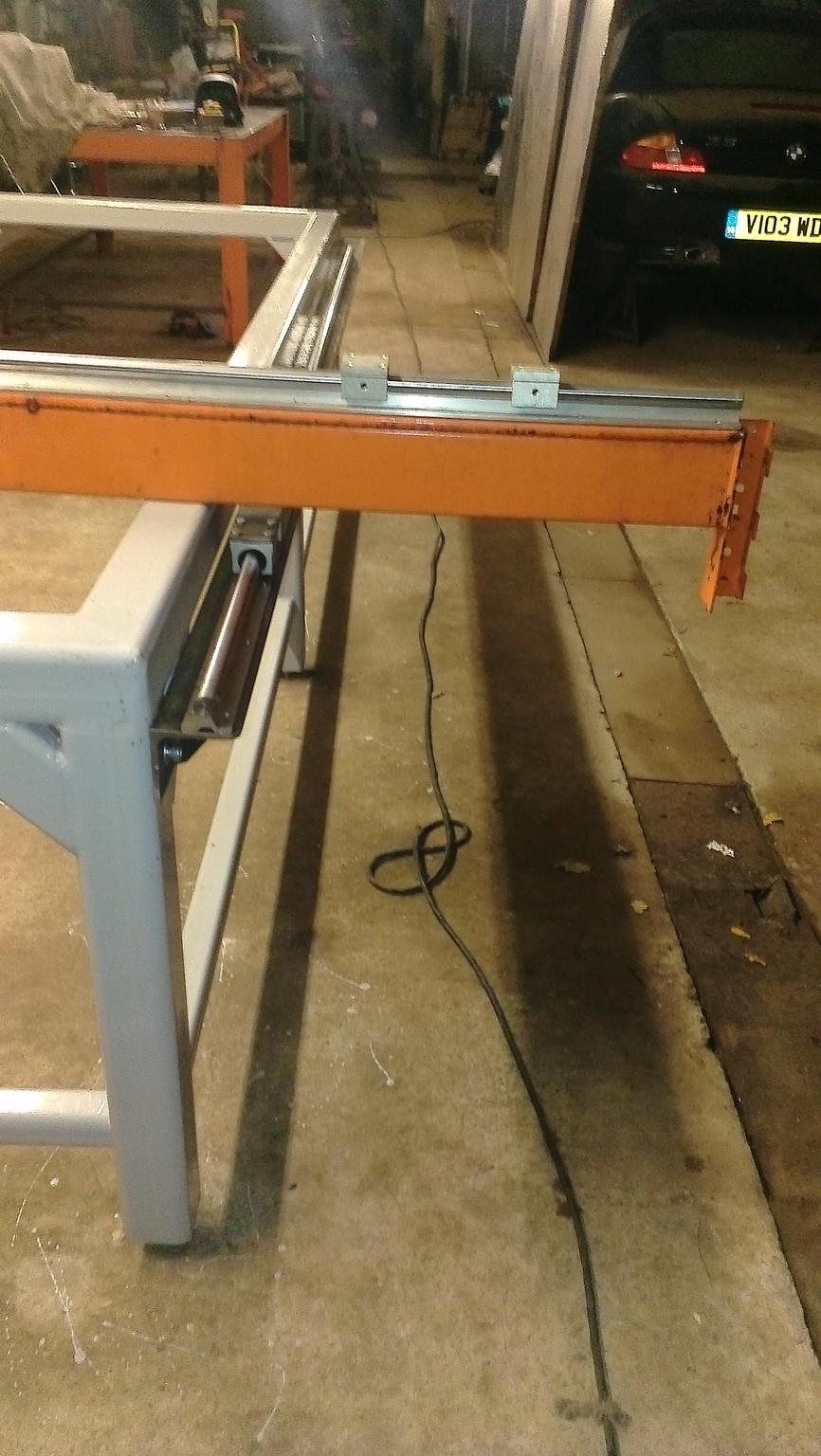

    the machine is getting built so another controller at the end i will run to if it makes it work reliably, iv ordered and had delivered 16mm supported linear rails 3200mm..iv unpacked them tonight and the look really weedy...i was thinking of using a piece of 80x80 box to make the gantry or a piece of link pallet racking (doesnt seem such a great idea now)...whats the best way to construct a light weight gantry? i have linear rails and 2m of r&p...im worried that the y axis rails arnt going to stand the weight and forces??
    i want the gantry to pertrude past the y axis outside the table and be able to run an ingraver...im not ever planning on doing any milling on this machine...iv got alot riding on this plasma working and working well,any help will be very greatfully receaved

    16mm supported rails will handle 80mm box section easily so wouldn't be bothered there.
    Dump the link pallet idea as it will only cause you grief. No point spoiling machine for little extra piece of box section costs.
    80mm or 100mm box with with few well placed braces will be fine for plasma machine.
    Regards the overhang then if you talking about using for Rotary type axis hanging off the side then yes no problem.
    But if your talking about actually engraving on separate table kind of thing then I'd say don't waste your time and just build another machine because engraver and plasma are two very different animals.
    Engraving machine needs to be far stiffer and accurate to work well and R&P just isn't going to cut if any real fine engraving type work is to be done.
    i'd like to be able to cut gas cylinder up,so i thought a couple of pillow block bearing supporting a shaft and then geared down so i can drive it with a stepper motor (in very simple terms).........you say 80x80 or 100x100 box will be ok..do you mean mild steel box or alloy? im more comfortable working in steel ..the link pallet racking idea was just because i had a pallet of the stuff knocking around BUT as youve said it will just devalue the integrety of the machine ...many thanks....
