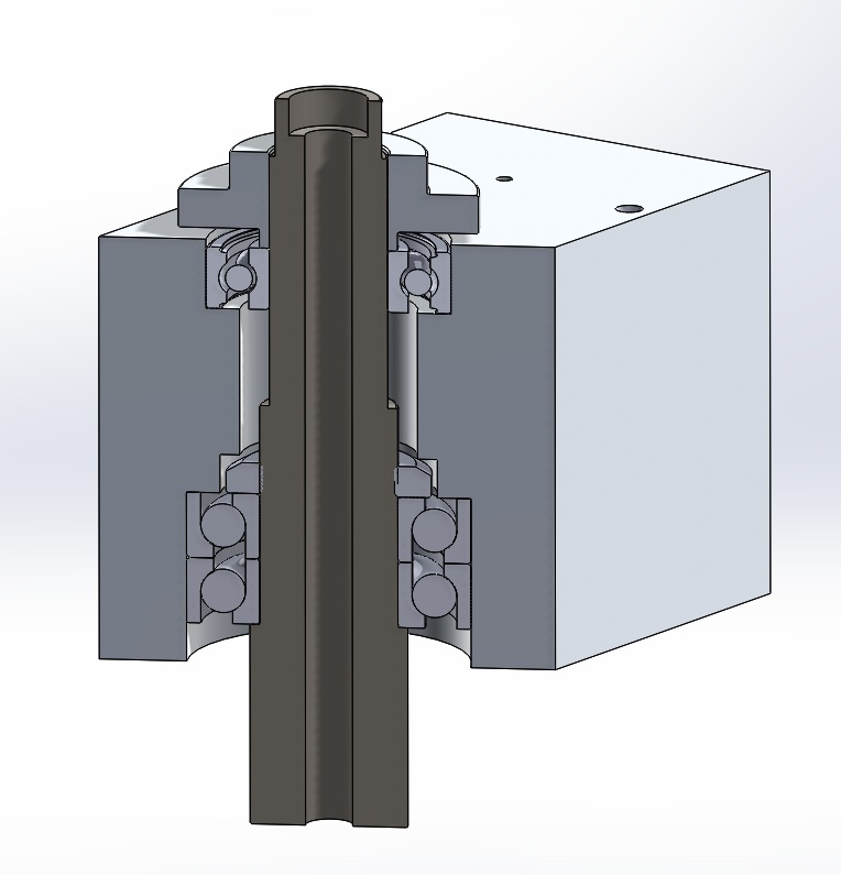

    12k rpm is asking much, Chris @ LMS says it's good for about 10k rpm. Angular bearings are rated at 12k rpm, if you double up they drop to about 9600rpm and if you decide to fit a radial shaft seal their limit is a surface speed of 18m/s. At 40mm diameter (the lower part of the LMS spindle) that's about 8400rpm.
    Still, my main concern is how much and by what means to preload the bearings. I hope I get to the bottom of this.
  4. #14
    Ok, I think I concluded to a design I'm comfortable enough with testing. It requires threading the 35mm part of the R8 spindle, so I can use a set of 7207BEGAP angular contact bearings. They are universally matchable, so the inner races are factory ground for a light preload, so fitting a KM7 nut will secure and preload them. Top bearing will be a standard deep groove 6206. The lower gap of the pair will have a flange that will secure the outer races and house a 40x62x8 radial shaft seal, series CRW1 or CRW1A.

    Also, (assuming the rest of the design works) the more I look at it, the more I don't like the design of the lever operated drawbar. The benefit is that you can use a small and cheap pneumatic cylinder, but the end result will look a bit bulky and amateurish to me, although fully functional. If I can spare the expense I might change the design to a 100mm bore 10mm stroke air cylinder. I think I'll need about 6mm of travel for 3 pairs of washers to release the collet, but I'll test as soon as i get them.
  5. #15
    Try and get those lower bearings as close to the end of the spindle nose as possible, it will reduce deflection.
    I think either operating method is good, both have merits, the lever and small cylinder will possibly be lighter.
  6. #16
    Yes, i've read that recommendation elsewhere, and it really makes sense to me, but it poses 2 problems. By far the bigger one is that I have no machinery to turn it down and grind it. The second problem is a design flaw that I couldn't predict. The end of the spindle head will be flush with the bottom of the Z-plate which is about 135mm from the table. That means that at the end of the z-travel, assuming a toolholder with an end mill with 20mm stickout, it will still need another 40mm or so to reach the table. If I get the bearings 20mm closer to the spindle nose, that becomes 60mm. I could maybe build longer toolholders, or use ones with er collets, or mount the head below flush from the z-plate, but wouldn't that be a problem?

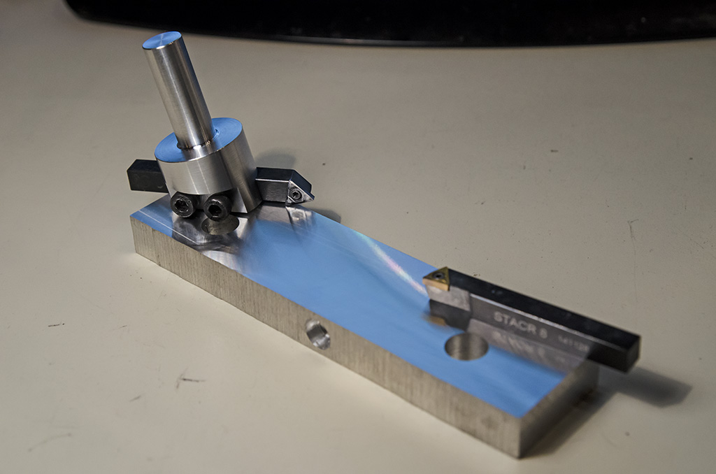

    In other news, I decided to make a small fly cutter, I wanted to see if it could be usable in that spindle. I had some 7075 bar (don't freak out, it's just a proof of concept), so I turned a 12mm shaft with a 30mm body and a 8mm slot on a 10 degree angle to mount a turning tool with a polished carbide insert in. Now, I would swear I had a 95 degree left hand tool somewhere, turns out it was right hand... The one pictured on the fly cutter is the only thing I had that would mount and make a cut, even though it's the wrong tool to use.
    Turned out quite nice though. I tried slow cutting air, to get a feel for the speed. Around 2200 rpm vibration starts being noticable, 3000 and it's too much. I tried it on the lathe at about the same rpm and it only had a really slight sort of harmonic to it. My guess is that whatever imbalance it has is greatly accentuated by the spindle runout. Anyway, 6082 plate, 0.1mm DOC, ~45mm WOC, 2300rpm, 300mm feed et voila. Not bad at all, spindle could handle it, I guess if it was runout-free it would give me much more confidence. Not that I would go deeper, I don't care about material removal, just surface finish.

    Its a crap-shoot with these spindles, never know what you get, I have two and both totally different in feeling.
    Fly cutters are murder on the spindle, be careful and if possible, counter balance it a bit.
