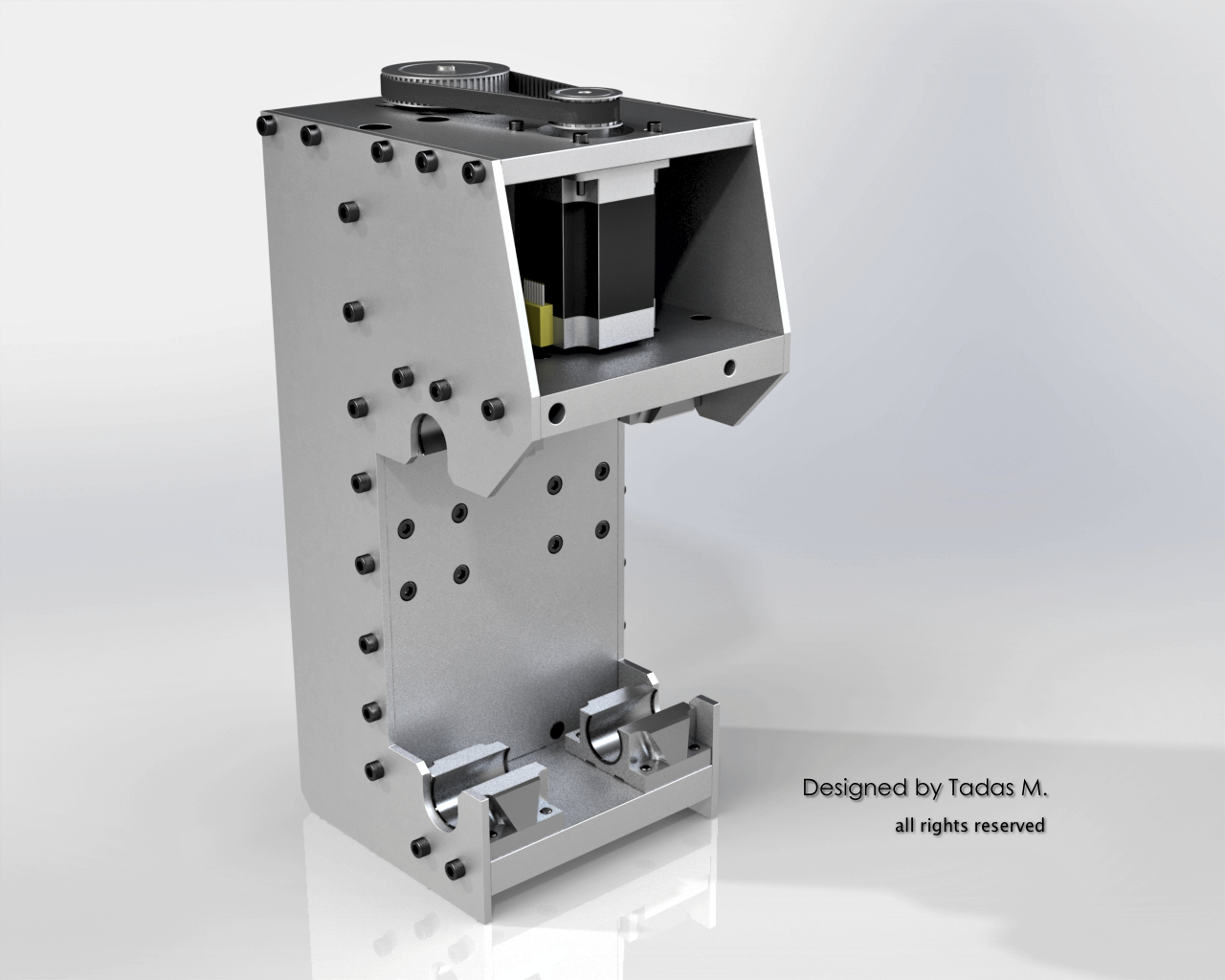

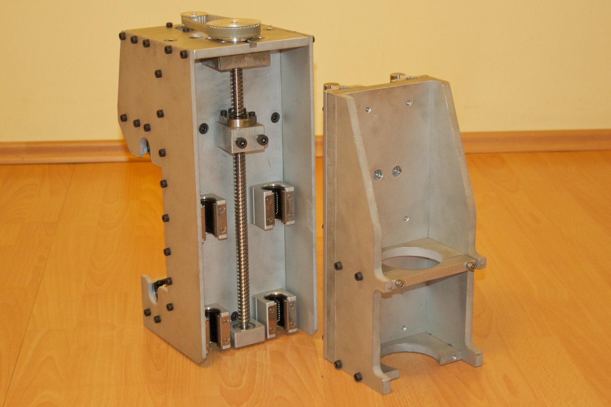

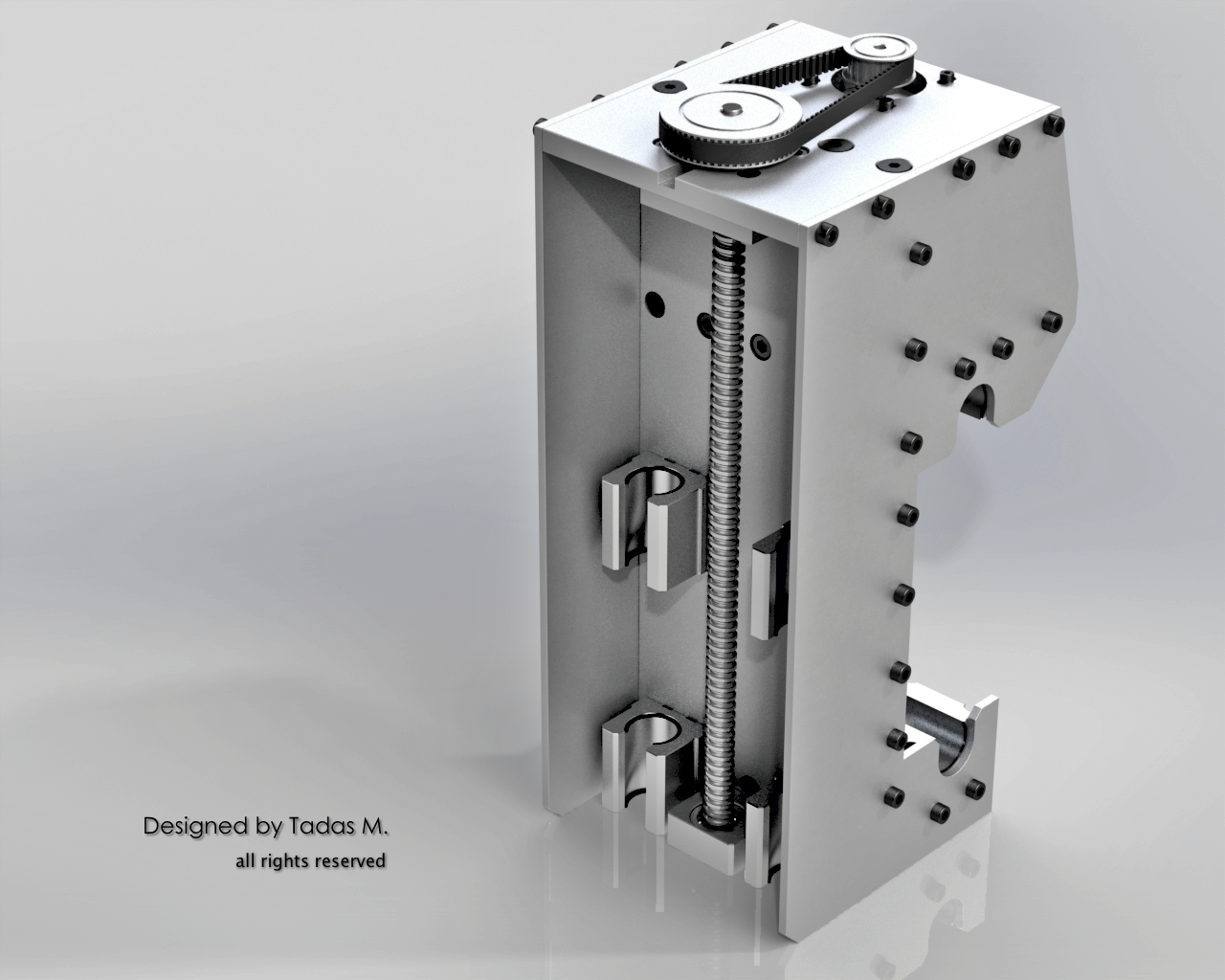

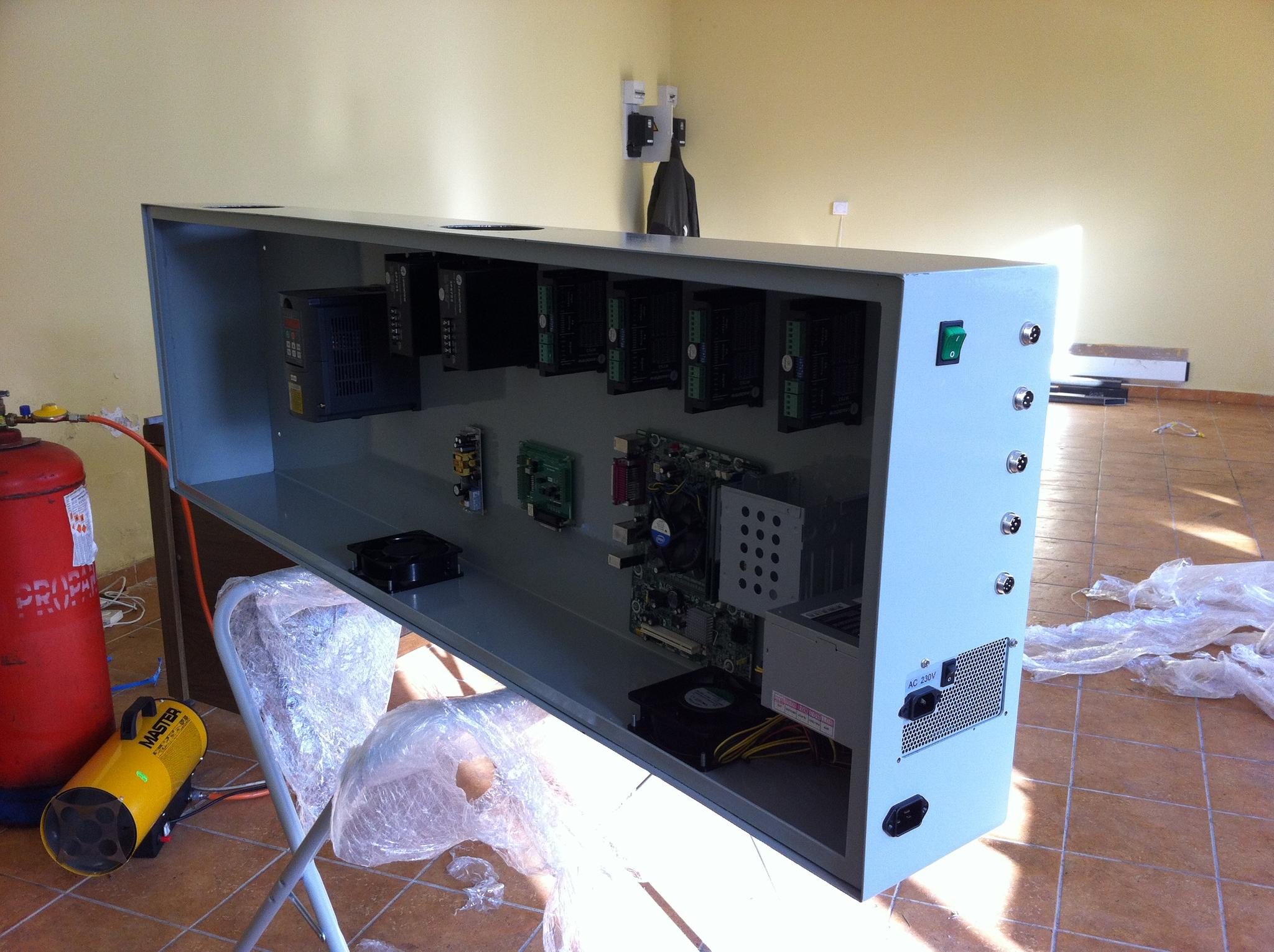

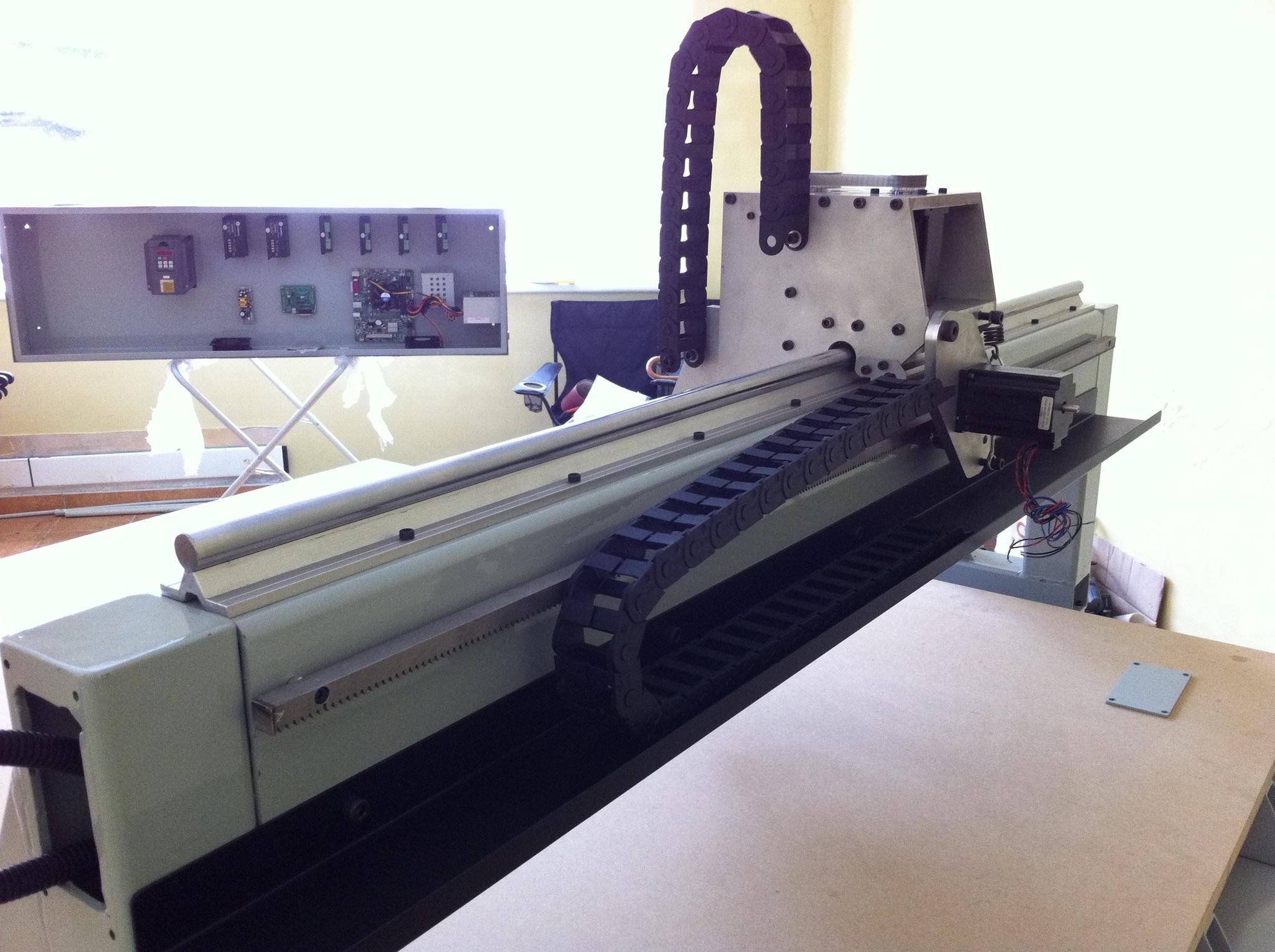

    Some time ago I have built 1200x700mm machine and it was pretty clear what electronics, mechanics and other items to use. Now, some time has passed - I have decided to build small, desktop machine (approx 400x400mm). But facing challenge - what electronics to use. My pc's does not have parallel ports anymore - is there decent USB BOB, or should I use motion controller connected to BOB ? What BOB should I use, what motion controller should I use (if needed at all). I want to have reliable machine so I could cut wood, aluminium, etc.
    Any input, advice would be much appreciated :)
    Here is some pic's and video from my previous build:

    Hello Welcome,
    You made a nice job of that machine but has well electronics I'd look at using different components to what you used last time. Things have changed in last few years and now the price of Ballscrews and Profiled linear rails have dropped massively so with in reach of DIY budgets.
    Regards the Electrics then go with Digital drives not old analog type ie Not M542. Lead shine AM882 are a very good drives at ok money if bought from china. Thou for small machine you could use the slightly lesser spec Dm 556 with 50Vdc Max.
    Regards the Motion control then Ethernet is the best. For a small machine that doesn't use slaved axis then IP-M from Cslabs is by far the best. This doesn't need a BOB and comes with spindle speed control. It's very high quality unit with plenty of 24V I/O.
    Other alternative is ESS smooth stepper used with a BOB, extra Bobs can be used if more than 5 inputs are required. No speed control unless BOB comes with it and only 5v I/O so more prone to noise.
    These are the only two Motion controllers I'll use. I don't ike USB it's too unreliable but If I had to choose then the only one's I'd use are the UC300 or Pokeys 56CNC.
    Thank You for your advices JAZZCNC. Much appreciated.
    As for rails, I think to use MGN12 rails with MGN12H carriages for Z and X axis. For Y axis HGR15 with HGW15CA (or other type, depending on final design) carriages.
    I have concerns if MGN12 with MGN12H will be enough for Z and X axis ? (even though I have seen those used in small cnc machines).
    I really liked the CSMIO/IP-M 4-axis Ethernet Motion Controller, but in specs it shows that the spindle axis is not supported ?
    I have ordered 800w water cooled spindle from aliexpress (the size was the buying factor - 158 mm fits nicely in my design) I expect this will be good enough for small aluminium works ? :)
    As for stepper drives, I will go with DM556 (or if needed - AM882). But what about steppers ? What torque I would need? (I plan to use pulleys and make 2:1 gearing or just leave it 1:1). The size is important too - smaller steppers are better for my design :)
    Do I need closed loop steppers and drivers ? (are they worth the money ? )

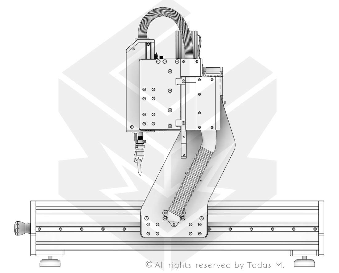

    Hello everyone,
    Bit more than a year passed from my first post and intentions to build a desktop size CNC machine. The design took longer than expected, but this CNC machine is not only about functionality, but about the design too. Machine is designed to have a small form factor but with biggest possible cutting area and be able to cut various materials, including steel. I hope You will like it as much as I do.
    MMC - Mini Mighty CNC:
ID:	20538Click image for larger version.
ID:	20539Click image for larger version.
ID:	20544Click image for larger version.
ID:	20542Click image for larger version.
ID:	20543Click image for larger version.
ID:	20545Click image for larger version.
ID:	20546Click image for larger version.
    Some numbers / info about my CNC machine:
    • FULL Work area X/Y/Z: 480 x 600 x 110 mm
    • Foot print: 416 x 778 mm (to outside of the foots)
    • Machine dimensions (L x W x H): 830 x 650 x 640 (height measured when Z axis UP at maximum, width measured at maximum width of X axis)
    • Weight (kg): approximately 100kg (control cabinet not included)
    • Rapid speed X/Y/Z: currently tested with 10000 mm/min showing very good results
    • Acceleration: X/Y - 2000 / Z - 1200
    • Repeated accuracy: 0.01 mm (check video below)
    • Linear rail types: HIWIN 15mm with carriages HGH15CA
    • Drive train X/Y/Z: Belt driven 1:1 ball-screws for all axis (1610 for X and Y axis, 1204 for Z axis)
    • Spindle: Currently installed 800w water-cooled spindle. (Can be upgraded to 1,5Kw spindle)
    • Drive motors: Steppers NEMA 23, 3.1NM (60BYGH301B)
    • Home/limit switch's: Inductive Proximity Sensor type
    • Sacrificial MDF bed with 54 pcs of 6mm threaded points for material fixing
    • Built entirely from Aluminum
    • Software: UCCNC 1.031 (show the new layout for UCCNC)
    • HB04 Wireless Remote Handwheel Controller MPG Pendant

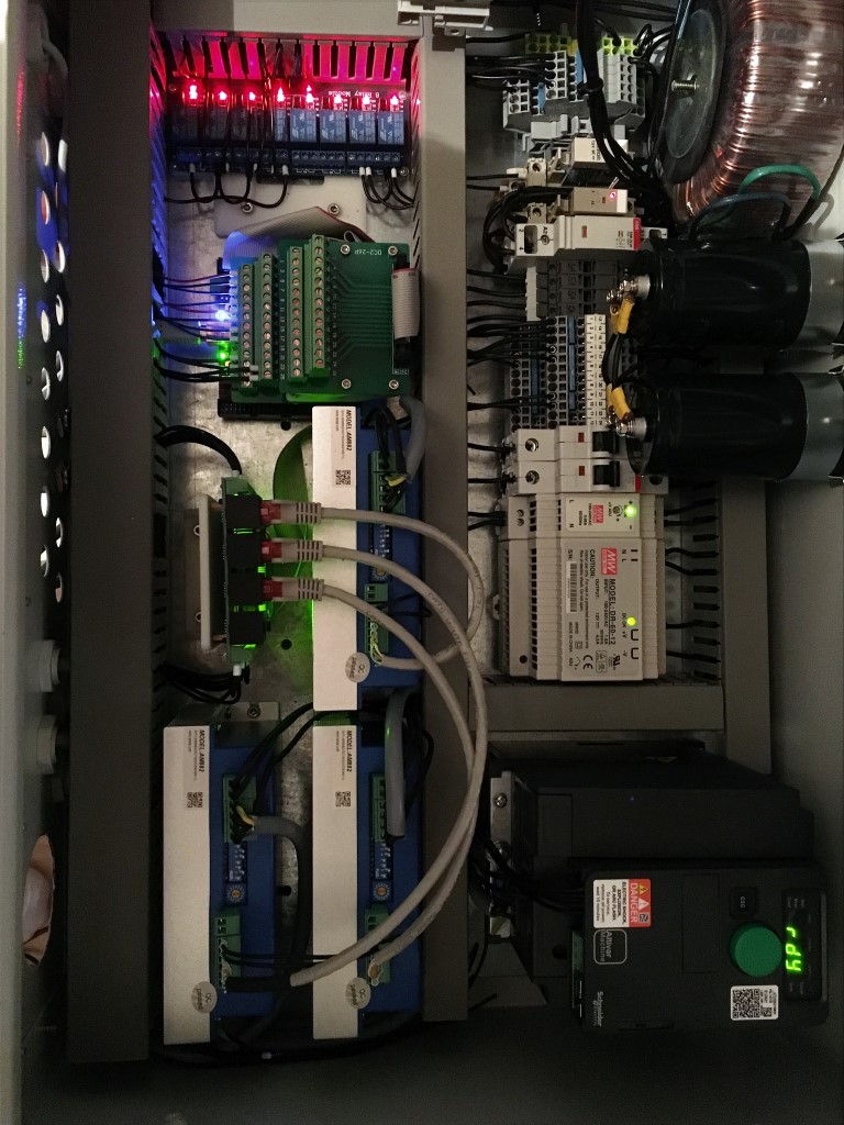

    Control cabinet:
    • Stepper drivers: Leadshine AM882 Digital Stepper Drive With Stall Detection
    • Motion Controller: UC300ETH-5LPT ethernet motion controller
    • BOB: HDBB2 breakout board
    • VFD: Schneider Altivar 320
    • Toroidal traff: 230V/2x24V 2x12.5A = 68V DC to Stepper drives
    • Capacitors: 2 x 20000/100V
    • And other electronics...

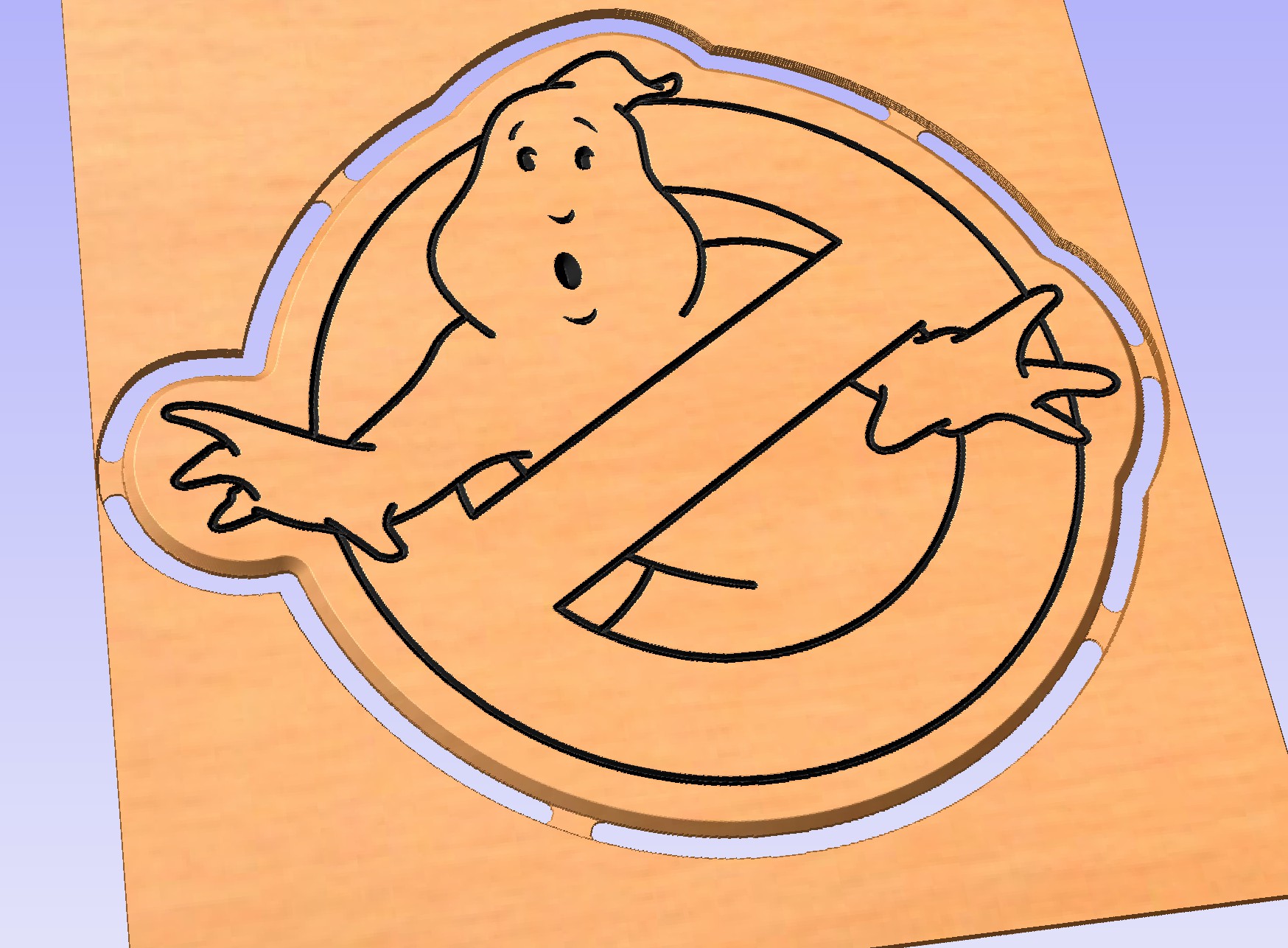

    I made a few checks of machine accuracy and repeatability.
    Here is videos for Z and X axis (Y axis has same accuracy, I did not made a video cause I feel it will boring to watch anyway :) )
    Z axis test:
    X axis test:
    Testing my new CNC machine:
    Very first testcut:
    Material size: X= 285.000, Y= 305.000, Z= 4.500
    Rapid CNC move feedrates:
    X axis: 8000 mm/min
    Y axis: 8000 mm/min
    Z axis: 6000 mm/min
    First toolpath:
    Tool: Solid Carbide V-Bit 90 deg 10 mm
    Cutting Feedrate:1500 mm/min
    Spindle speed: 18000 rpm
    Total depth: 1.2mm (Two passes: first pass at 1.0 mm, second at 1.2 mm) The two passes strategy was chosen in order to check repeatability of machine witch showed perfect results.
    Second toolpath:
    Tool: Solid Carbide End Mill 6 mm (1 flute @ 25degree)
    Cutting Feedarte: 1000mm/min
    Spindle speed: 14000 rpm
    Total depth: 4.6 mm (Two passes: first pass at 3.6 mm, second at 4.6 mm. 1x10 mm tabs to hold peace in place were generated)
Name:	Apsire - Ghostbusters.jpg
ID:	20549Click image for larger version.
Name:	Apsire - Ghostbusters-cut completed.jpg
    Next time, for such thin material, double sided tape will be used to avoid any material vibration during machining.
    Looking forward to cut some Aluminum and Steel.

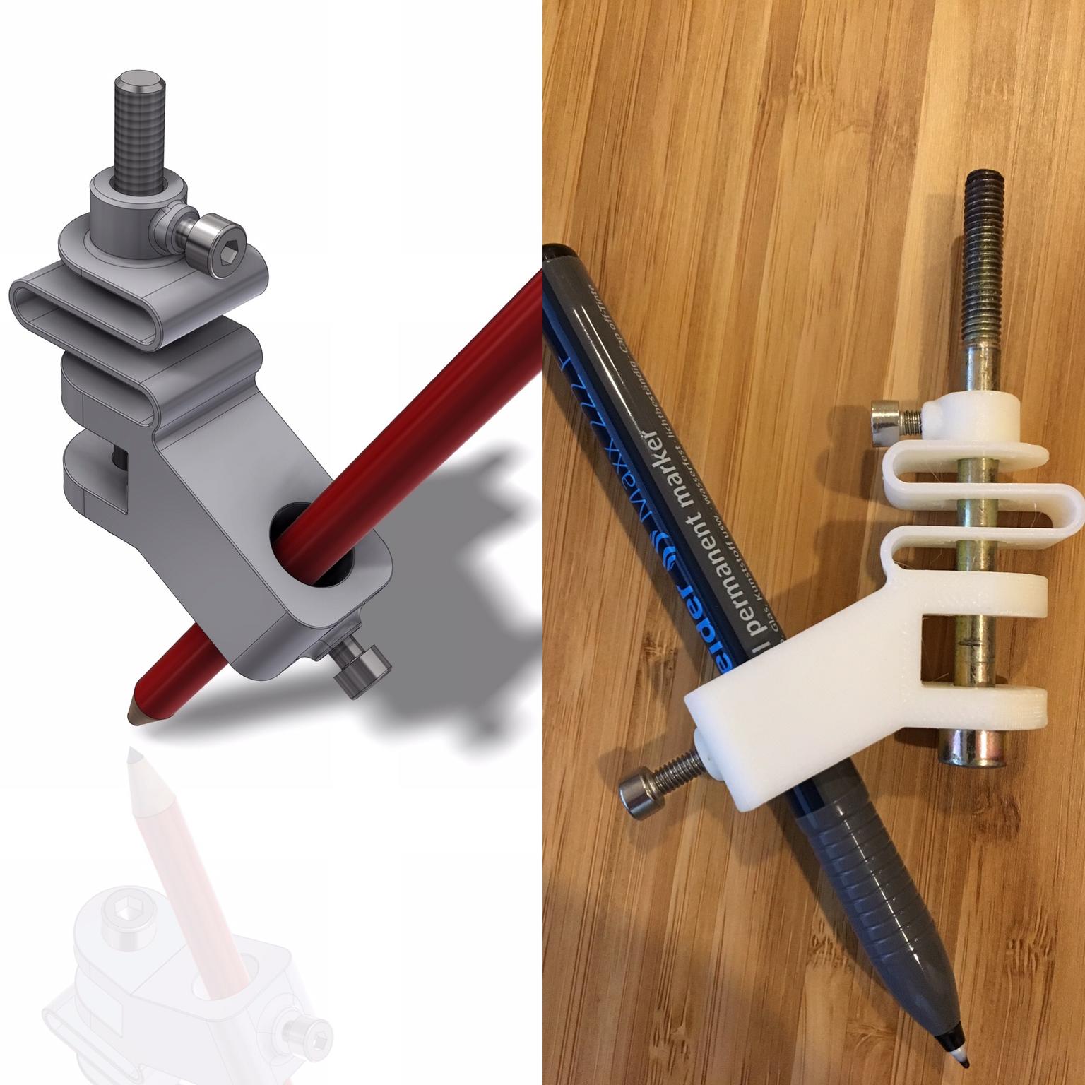

    I have also designed and tested a PEN holder, and made some nice gift cards during holidays. Please feel free to download, print and use it :)
Name:	2016-10-24 22.27.33.jpg
    download link to Thingiverse: http://www.thingiverse.com/thing:1847711
