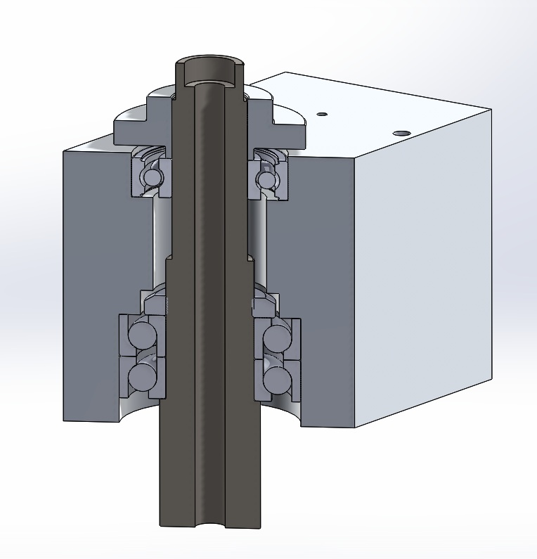

    And now, onto the ATC portion of the thread. It really bugs me to have to change tools manually, it's time consuming, it's a pain to zero every tool, even with the auto tool zero function, and most of the times doing all that takes up more time than the actual operation itself. I've looked into ATC spindles (since the generic chinese ones can't be retrofitted with any ATC system), but first of all the cost is way high(1.5-3k €), but most importantly there is no real reports from people actually using them, so I'm not going to take that risk.
    I then had an idea based on the people that convert the X2 machines to cnc and ATC. The idea is very simple, so simple in fact that there must be something massively obviously wrong with it and I still can't see it. Basically I want to make a new head into which i'll plant an R8 spindle, seated on a couple of angular contact bearings. The R8 spindle will be mated to a two step pulley that will be driven by the 2.2kw chinese spindle. My intention is not to exceed 12k rpm (or thereabouts) on the chinese spindle, the noise is tolerable on that rpm level and it puts out decent power. Pulley ratios will be 1:1.66 on the high gearing and 1:3.75 on the low gearing, so I can get about 8k rpm on the high gearing and 3k rpm on the low gearing. Belt will probably be a poly-v 4 rib belt, since I can easily make the pulleys myself on the mini-lathe and belt speed will be around 20m/s max, which is well within what they can take. Here is a quick mockup of that

    One consideration is weight, I've no idea how much weight the gantry could support without deflecting. I've been thinking to make it out of 7075 aluminium (head with spindle will weigh about 5.5kg). People tend not to prefer using aluminium, partly because it will expand a bit more than the bearing in a given temperature rise (I seem to recall reading somewhere it is 1 thou more over 40 degree temp rise). That could very easily be rectified with watercooling for the head, since there is already a system in place for the spindle.
    I mentioned deflection earlier, I did a simple measurement. I put a dial gauge upside down on the outer lower face of the spindle body. Then I rested a 5kg weight on top of the stepper motor. Gauge moved down 0.01mm. I then hang the same weight in front of the spindle and gauge moved down 0.07mm. Open ended bearings have inherent weaknesses, and I think most of that slack comes from the Z-axis. I need more travel in the z-axis anyway, so i'll be replacing the rails on the Z with profiled ones. Oh, and the stepper motor (nema23 270oz) didn't even flinch with the extra weight.
    About the actual auto tool change, if the head is a success the rest is a piece of cake. R8 spindle can take a Tormach R8 collet, which can take Tormach TTS toolholders (or indeed homemade ones). Couple that with a drawbar preloaded with 3 pairs of belleville washers and a pneumatic actuated lever and you're there. LMS used to offer it as a conversion kit for the X2 mill called the Z-bot, and a lot of people have done a similar conversion like the one below from Hossmachines.

    Nothing wrong with that setup and thought about doing something very similair but would allow 2.2kw to still be used.
    Would be side by side twin head with 2.2Kw upside down when low speed cutting. Slide out and turn around and it's back usable has high speed spindle without needing high speed bearings in milling head.
    I think i've seen something similar in a drawing somewhere, don't know if it was you or somebody else. I have no real use for high rpms, never do wood or plastics and rarely use small end mills, which have no problem running slower, so i don't need that interchangeability. If i need to do some engraving or a pcb or something like that, i can still setup my old 3040 and spare 1hp 24k rpm spindle and do it there.
    I'm glad people with more experience than me don't see much wrong in that, i'll be putting it together as soon as possible.

    12k rpm is asking much, Chris @ LMS says it's good for about 10k rpm. Angular bearings are rated at 12k rpm, if you double up they drop to about 9600rpm and if you decide to fit a radial shaft seal their limit is a surface speed of 18m/s. At 40mm diameter (the lower part of the LMS spindle) that's about 8400rpm.
    Still, my main concern is how much and by what means to preload the bearings. I hope I get to the bottom of this.
    Ok, I think I concluded to a design I'm comfortable enough with testing. It requires threading the 35mm part of the R8 spindle, so I can use a set of 7207BEGAP angular contact bearings. They are universally matchable, so the inner races are factory ground for a light preload, so fitting a KM7 nut will secure and preload them. Top bearing will be a standard deep groove 6206. The lower gap of the pair will have a flange that will secure the outer races and house a 40x62x8 radial shaft seal, series CRW1 or CRW1A.

    Also, (assuming the rest of the design works) the more I look at it, the more I don't like the design of the lever operated drawbar. The benefit is that you can use a small and cheap pneumatic cylinder, but the end result will look a bit bulky and amateurish to me, although fully functional. If I can spare the expense I might change the design to a 100mm bore 10mm stroke air cylinder. I think I'll need about 6mm of travel for 3 pairs of washers to release the collet, but I'll test as soon as i get them.
    Try and get those lower bearings as close to the end of the spindle nose as possible, it will reduce deflection.
    I think either operating method is good, both have merits, the lever and small cylinder will possibly be lighter.
    Yes, i've read that recommendation elsewhere, and it really makes sense to me, but it poses 2 problems. By far the bigger one is that I have no machinery to turn it down and grind it. The second problem is a design flaw that I couldn't predict. The end of the spindle head will be flush with the bottom of the Z-plate which is about 135mm from the table. That means that at the end of the z-travel, assuming a toolholder with an end mill with 20mm stickout, it will still need another 40mm or so to reach the table. If I get the bearings 20mm closer to the spindle nose, that becomes 60mm. I could maybe build longer toolholders, or use ones with er collets, or mount the head below flush from the z-plate, but wouldn't that be a problem?
