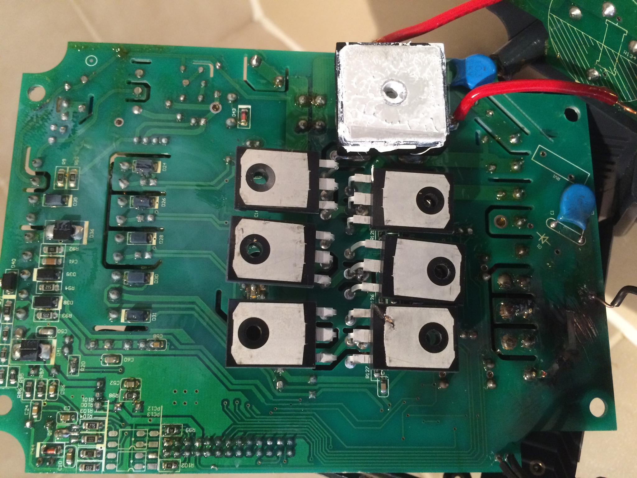

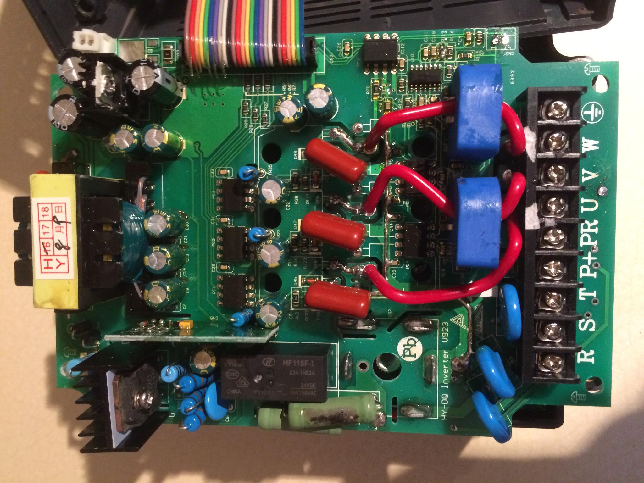

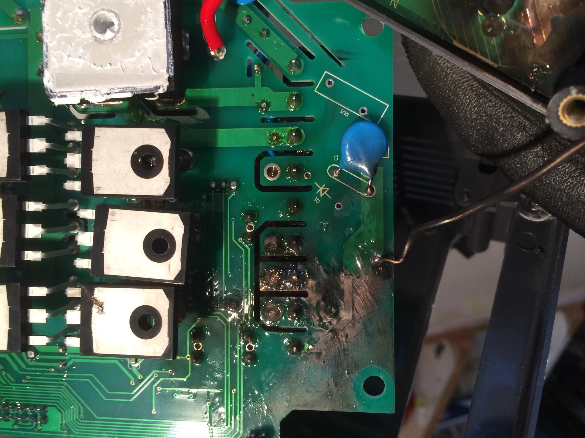

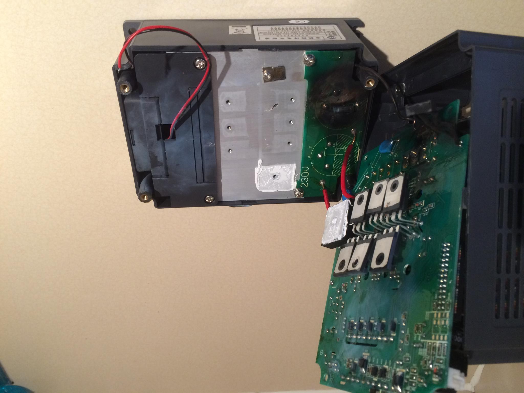

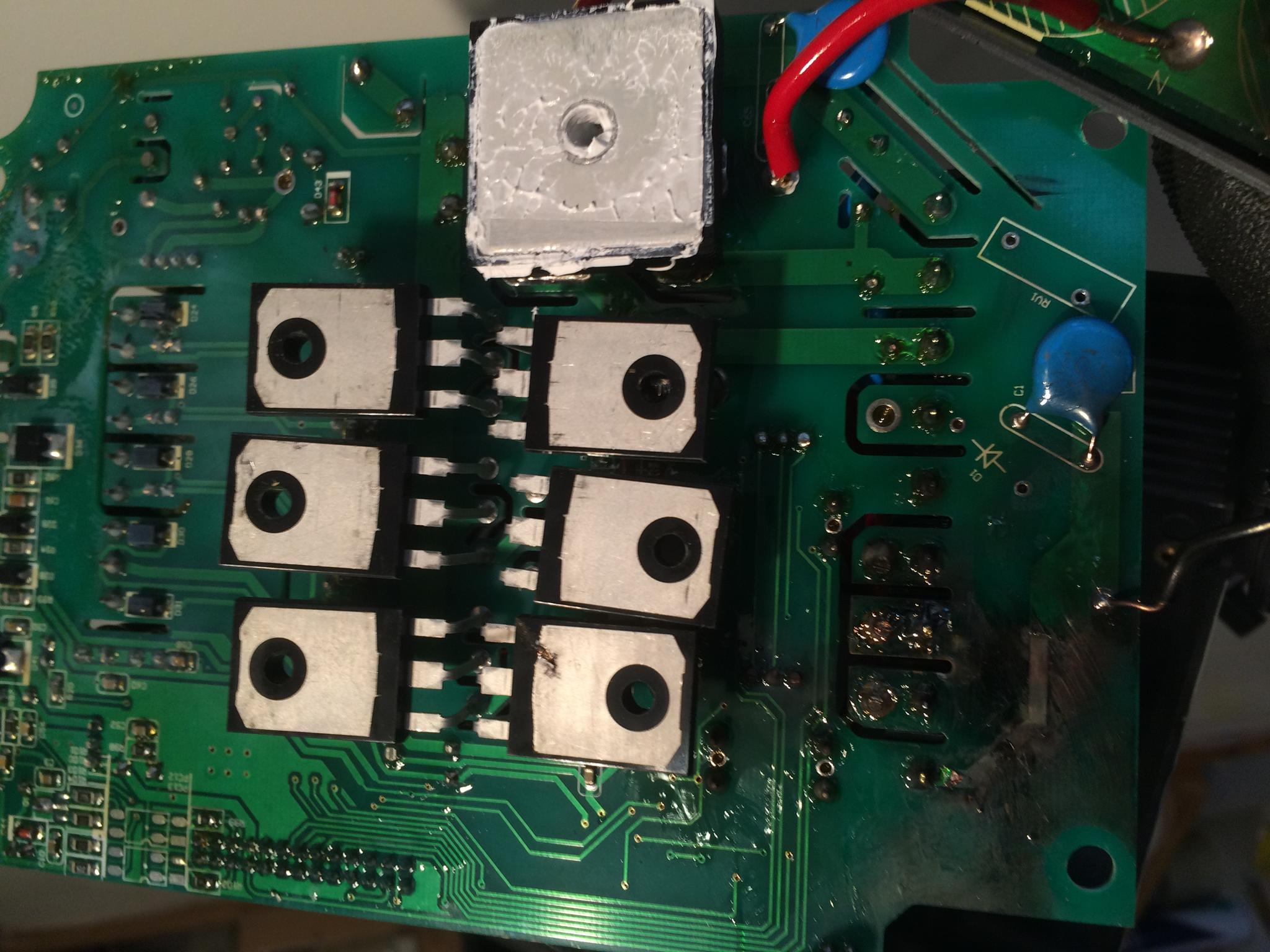

    Hi all.
    Just updating about my Huanyang.
    eBay sellers refusing refund/ exchange
    Here's what happened.
    Wired L to R and N to T and earth to E(9)
    Tripping RCD, twice, checked connection, have read manual, contacted eBay seller about wiring (he send me video) and scheme.
    I've checked wires, wiring, exchange few messages here
    Tried again and it burned.
    Thanks all for support.
    Buying cheap/ buying twice. ( I learned)

  8. #16
    Clive S's Avatar
    Lives in Marple Stockport, United Kingdom. Last Activity: 22 Hours Ago Forum Superstar, has done so much to help others, they deserve a medal. Has a total post count of 3,348. Received thanks 620 times, giving thanks to others 90 times. Made a monetary donation to the upkeep of the community. Is a beta tester for Machinists Network features.
    Stan sorry to hear about the seller refusing but I think you will have to contact eBay.
    These VFD's are very well known on this forum I bet 90% have them and are happy me included so it is very unusual for one to be faulty (but it does happen).
    If like you say you connected it correctly and it tripped then it was faulty.
  9. The Following User Says Thank You to Clive S For This Useful Post:
  10. #17
    I agree. You have to go through eBay, not just sending a message to the seller. The seller will react differently after you have raised a claim via eBay. Don't waste your time, just click on that claim button. You will get a response from eBay and every communication is logged after that. It takes a few weeks but you have a better chance.
  11. #18
    Quote Originally Posted by Stan View Post
    UVW cabel, but only cabel, nothing was connected to motor.
    Sympthoms of damage was white smoke, strong smell.
    Where the ends separated.? If not This may have caused the 3 phase wire to short.
    I've fitted more than 100 of these and only had about 3 faulty on first fit and only 2 or 3 actually fail in use within the warranty period.
    If your sure you didn't cock up then It's unacceptable and Ebay will act if you contact them but don't go showing them those Pics. It wasn't wise thing to do stripping the VFD and breaking the warrenty seal.
