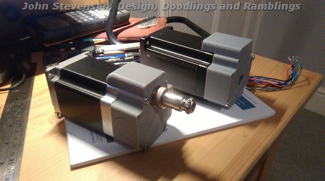

    23's and 24's are compatible as regards hole sizes. It just the bodies that are bigger.
    Just double checked with a digital vernier as I'm sat here 3D printing covers out for both.
