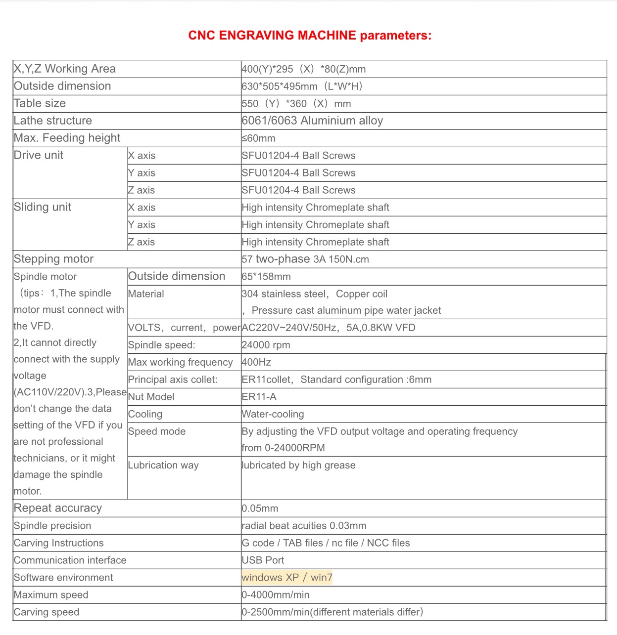

    I cancelled the above machine & ordered this http://www.ebay.co.uk/itm/182253604089 from Ebay, it's still a Chinese 30/40 machine but it's USB controlled, has a 800w water cooled motor & ball screws , it's the best I can afford as a new machine, as I'm not really into buying secondhand (bit me in the arse that many times in the past) I'm hoping that this machine is a bit higher standard than the cheapest Chinese 30/40 as it's about double the price & looking at the spec it seems to be higher spec/quality than than the others, despite the money side of things, we don't have room for anything bigger so I'm hoping this machine will be ok & see me through my cnc experience! I realise I'm going to have teething troubles with it & have to replace substandard parts on it (hopefully not straight away though) but I don't mind spending the couple of hundred quid here & there to hopefully improve it.

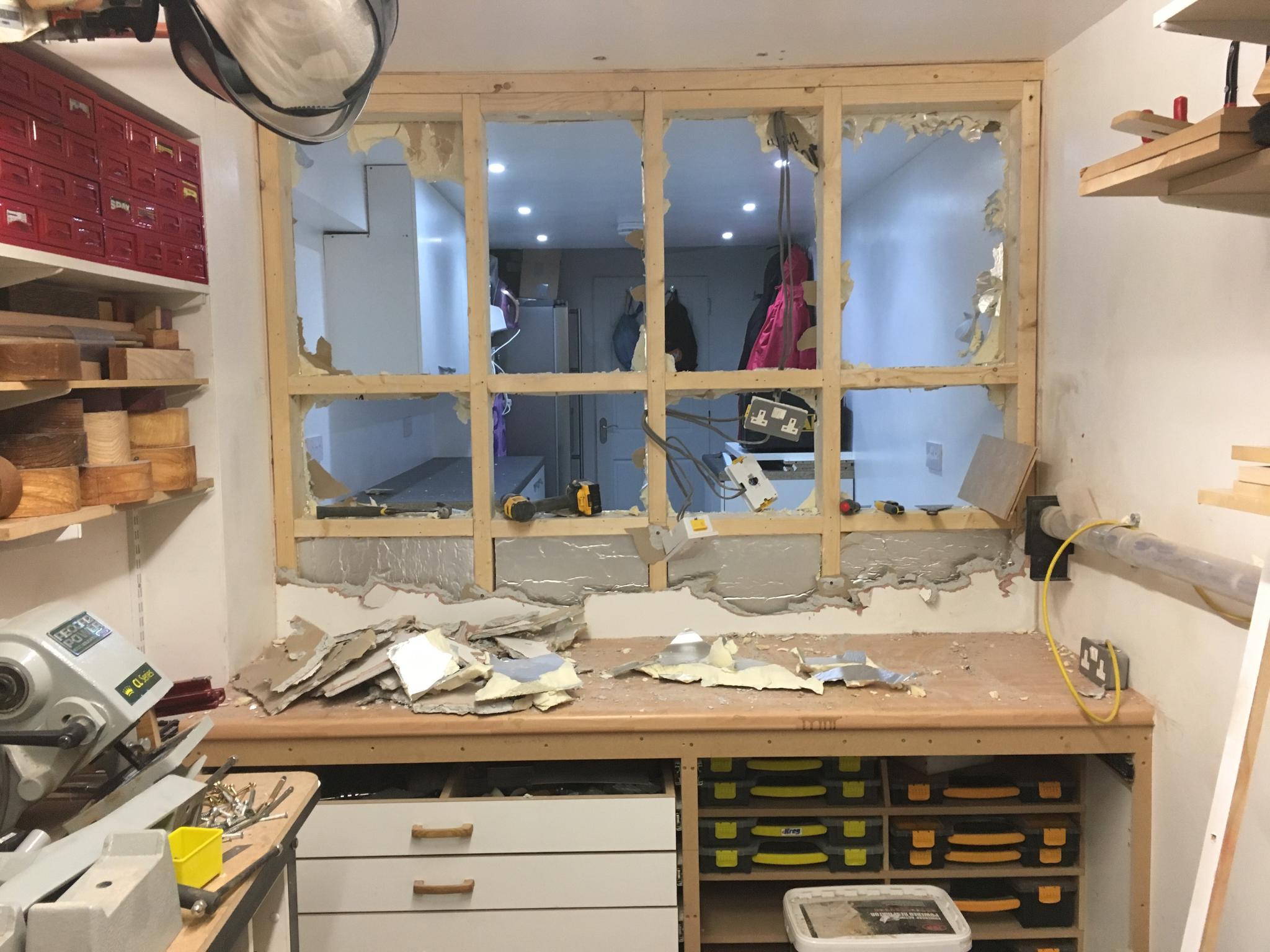

    I had a brain fart yesterday lunchtime! So now busy knocking down a partition wall in my small garage/workshop & pinching back about 3ft of my wife's utility room to give me a bit more room LOL

    Sh can't really complain as about 3 years ago the whole lot was my workshop until I gave up half of it for the utility room, so I'm only pinching a bit of it back!
    So you are just taking whats rightfully yours then
