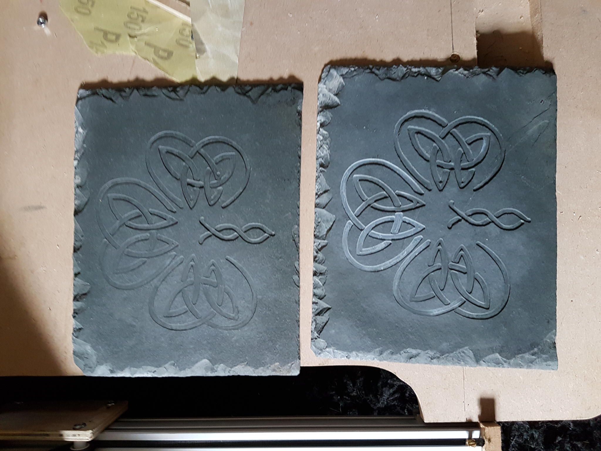

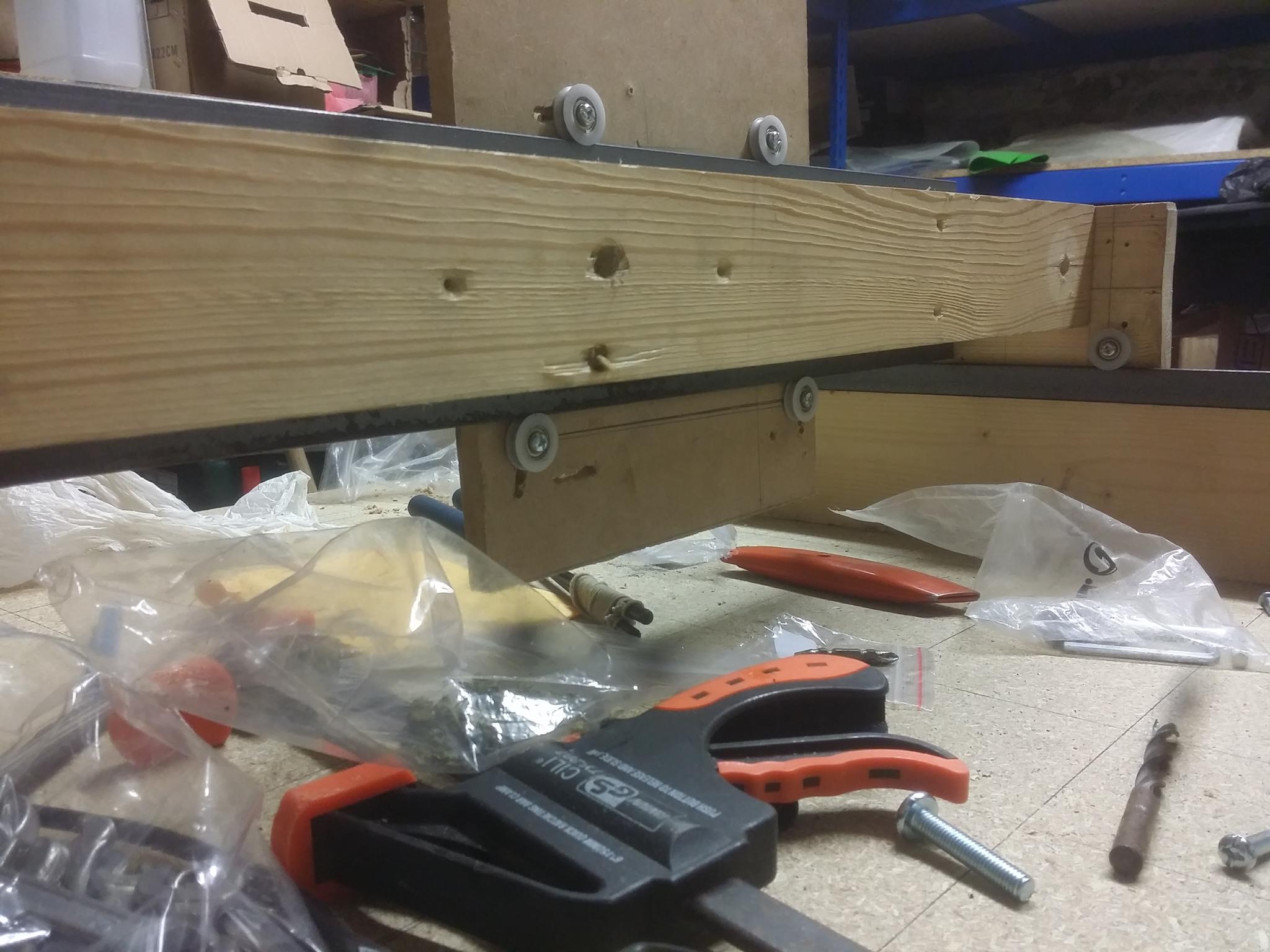

    ROFL, I love you man. But me thinks you got me wrong.
    The aluminium frame in the photo is 1 of two of my baby CNC's
    I still use my large wooden one and am making a aluminium one just because i can.
    My wooden machine is Ply and Timber i used MDF to prototype parts (cheap stuff).
    SO far cuts Hard and soft wood, perspex and slate.
    Think That Qualifies as Decent?
    I was going to use a chain drive but could find the parts i wanted so ended up ball n screw.
    as for the rails My lovely door runners have held out and work like a cool summer breeze.
    Router/Trimmer £40
    Rails n Wheels £70 ish 120cm
    Screws n Bits x3 £40 ish 100cm
    Stepper Motors x4 £100
    Drivers x4 £30
    Controller £20
    £300 as wood was all scrap i had that didn't cost me anything.
    I Think that qualifies as cheap?
    So my Cheap CNC Router is Decent ! lol look all three words in yet another sentence.
  3. #53
    Of course depends on what qualifies as "precision" and "repeatability" for you. What you have done so far is in the 1-2mm region at best. if that suits you, then great. Most people trying to make a machine aim at least 0.1mm, the good builds aim at 0.05mm, exceptional builds can achieve 0.01 mm.
