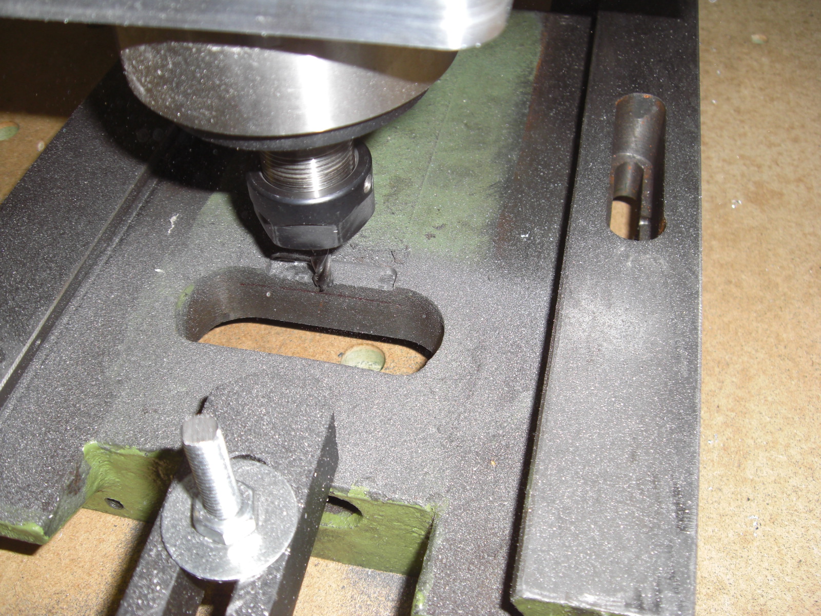

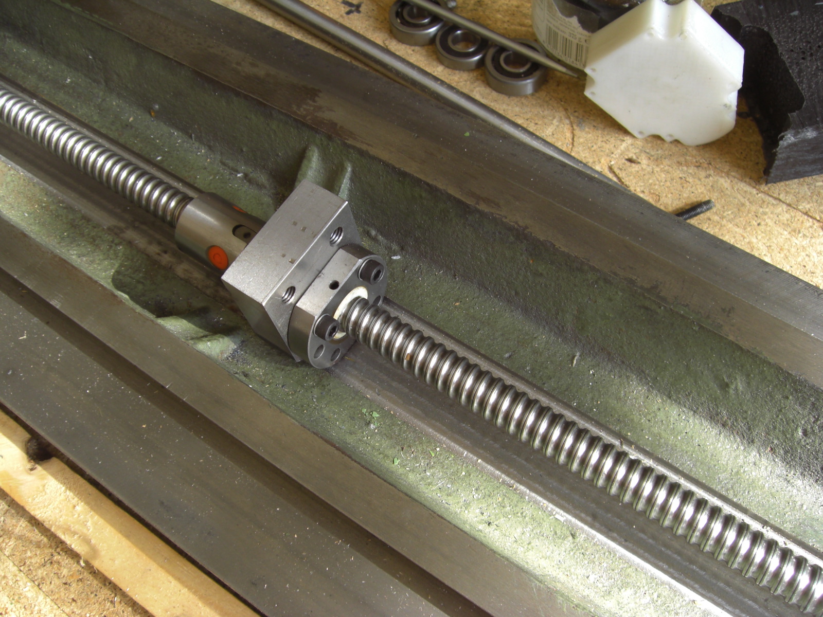

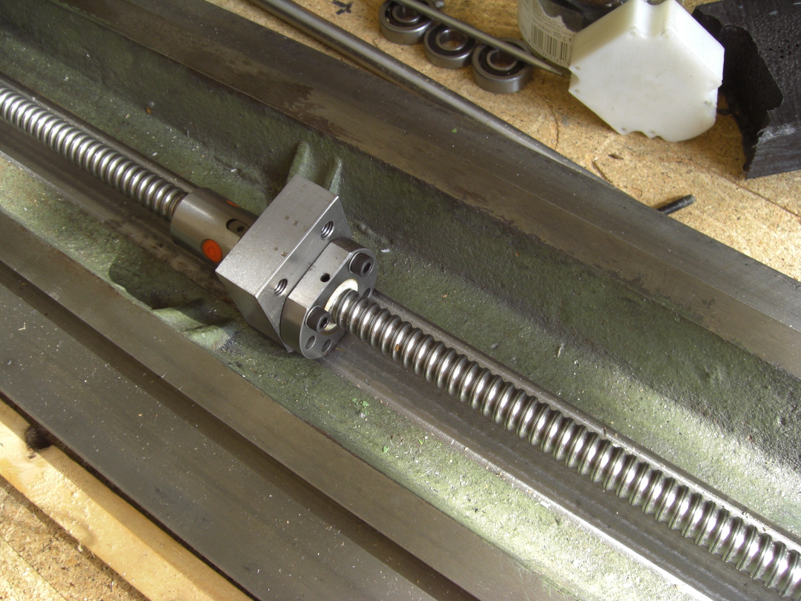

    I cut a slot in my table about 4mm deep Click image for larger version.
    and the table twisted by about 2mm with the stress being relieved then I had to take it to engineering place to have it trued up and the top skimmed.
    So beware as I did not expect that to happen.
    Yes 3-4mm was about what I'd imagined, I would have though that would be safe!.. bugger for your table what a pain!
    It's a crazy thought probably but what if I was to try and relieve the stress before milling out the groove?

    Warco WM14 you can usually get away without having to machine the underside of the table.
    Warco WM16 is borderline some clear, some don't.
    Warco WM18 you always have to machine the table.
    The problem comes about from droop when casting as they are cast top up.
    The longer the table, the slower it cools and gives rise to the middle dropping down under the weight of the metal.
    There are ways when casting to prevent this but seeing as it's not their remit to make sure they can convert to CNC then they don't bother.
    There is enough standard clearance for the manual ACME screws.
    So maybe no machining needed...
    ....wouldn't it be simpler/safer if necessary to mill the groove in the saddle and drop the x axis screw supports by slotting the mounting holes to get upwards/ downwards clearance? Or is this not possible for some reason I can't see. (I'm working off a plan at the moment my mill should be here next week according to Warco.)
    Perhaps simpler to remake the x axis ballscrew supports with lowered bearing housings and at the same time incorporate motor mounts or standoffs...
