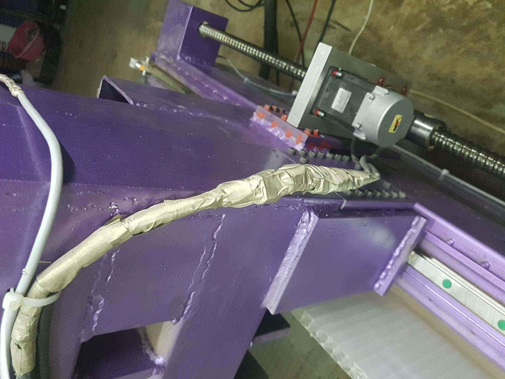

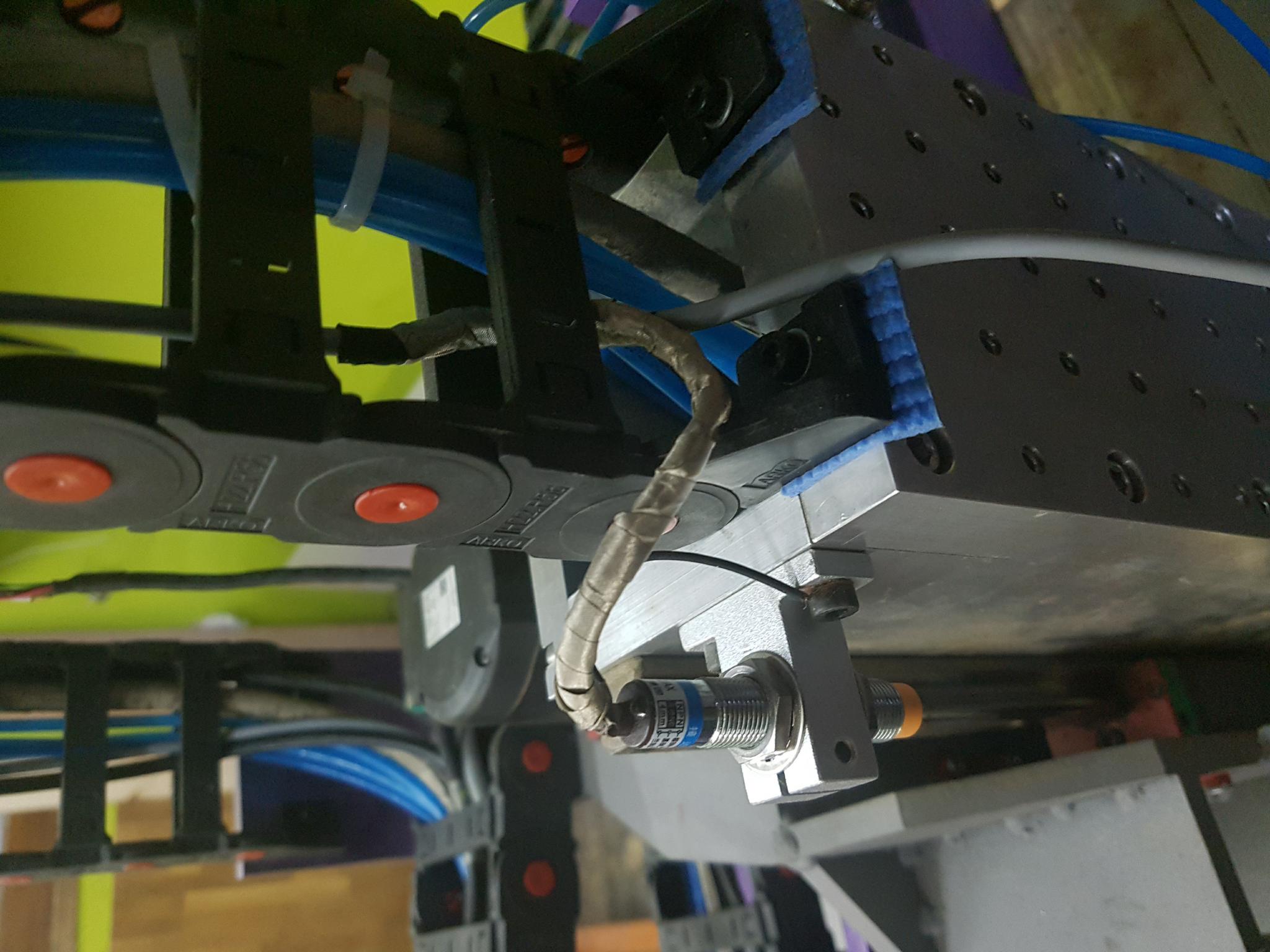

    how do you deploy your conductive tape? Would you mind elaborating?
    I don't see any reason to do this, just what is the point
    Quote Originally Posted by GND View Post
    Just curious, Boyan - how do you deploy your conductive tape? Would you mind elaborating?
    Limit switches and servo connection example. may be not "by the book" as it must be using collars bolted to frame, but works fine

    Thanks Boyan - so essentially shielding?
