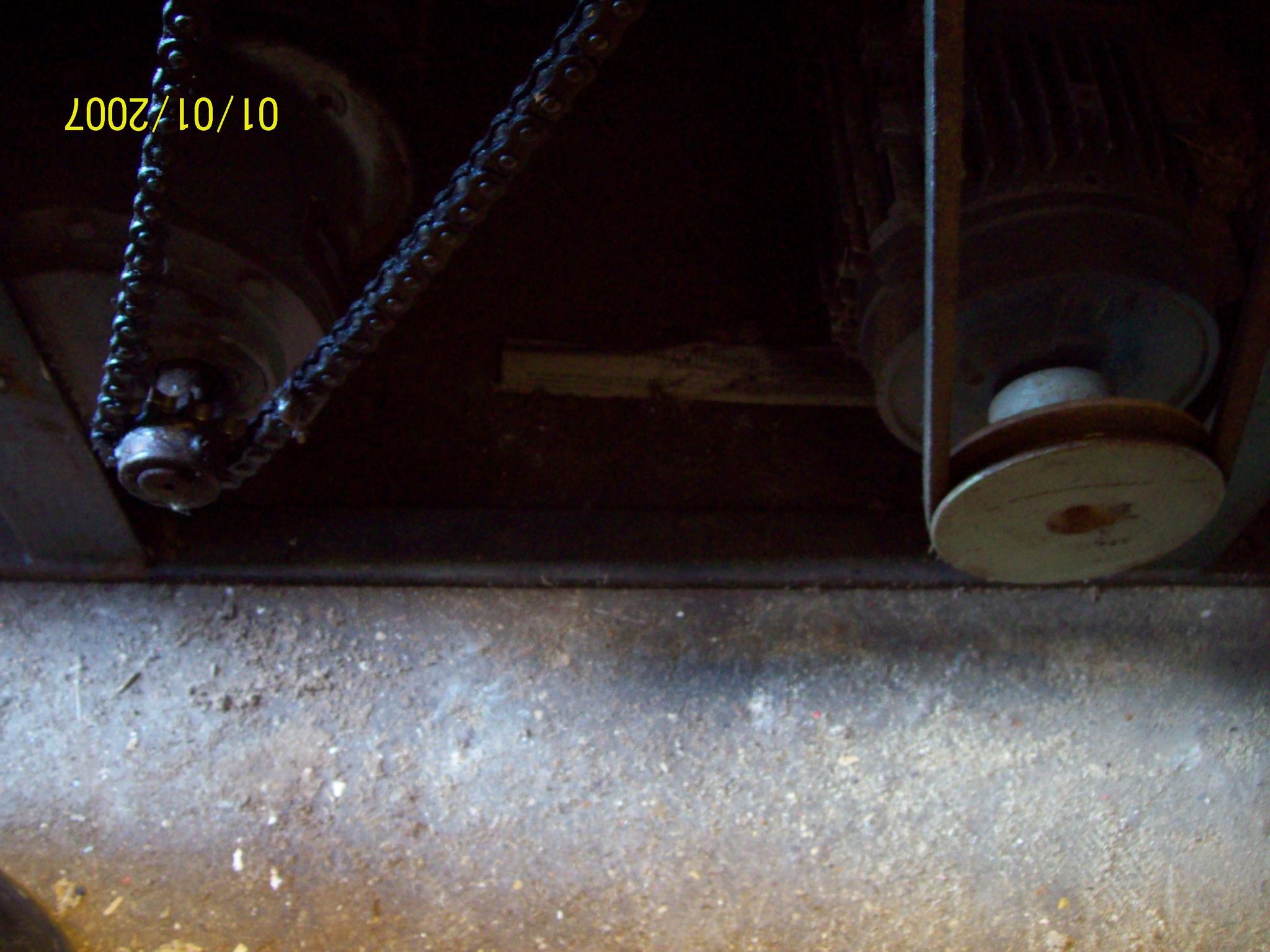

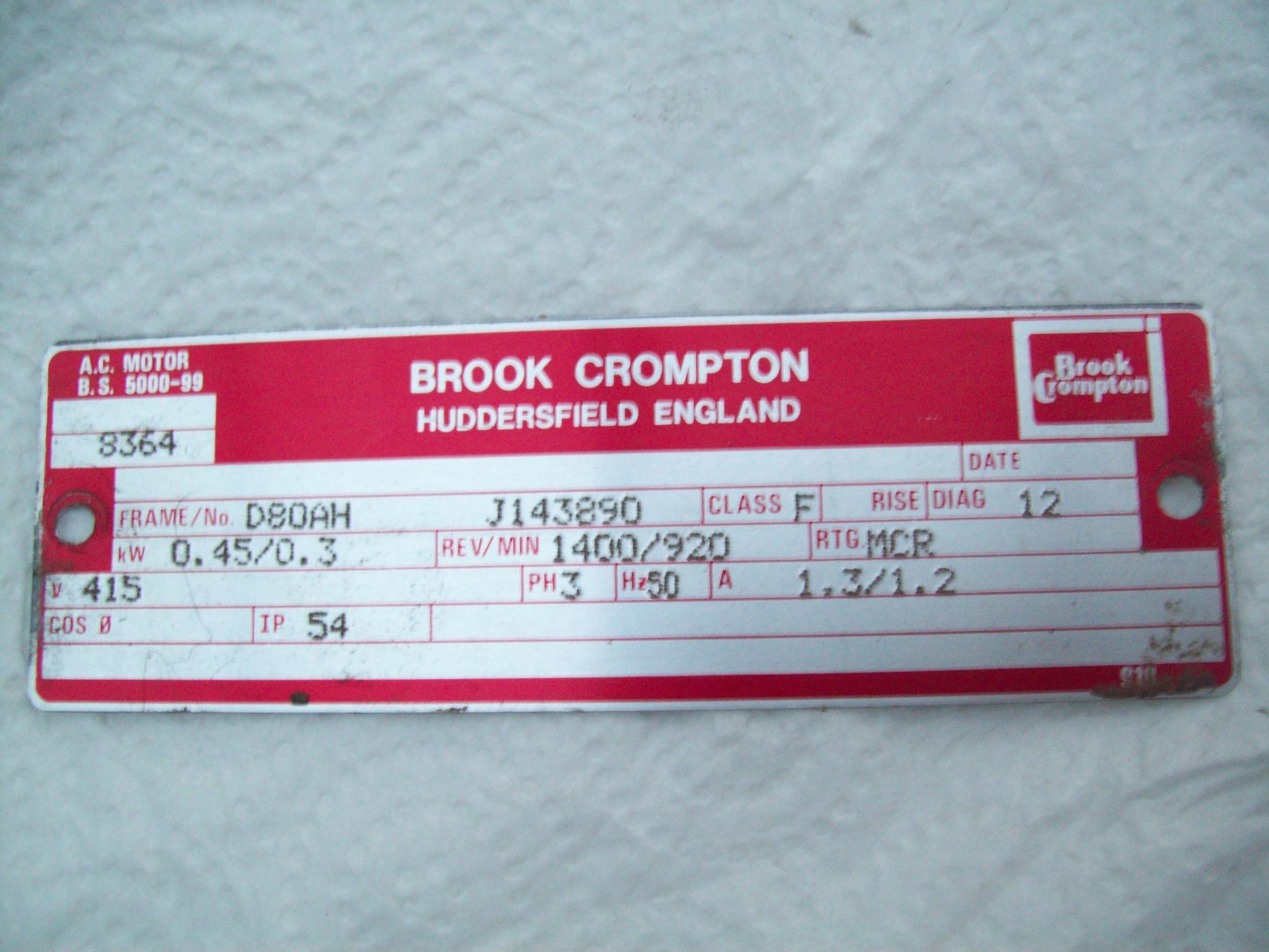

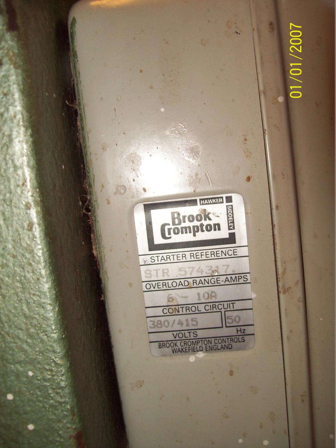

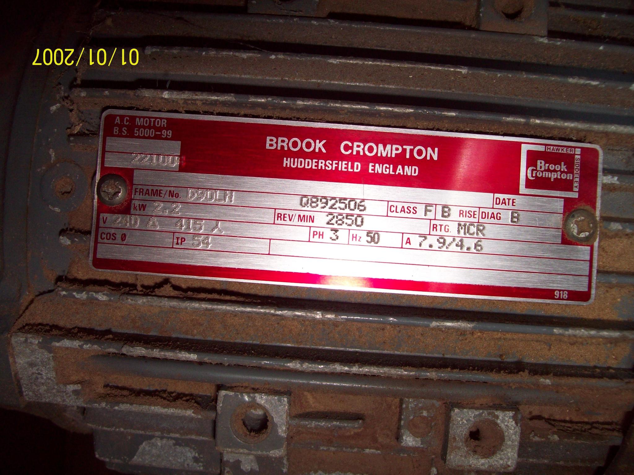

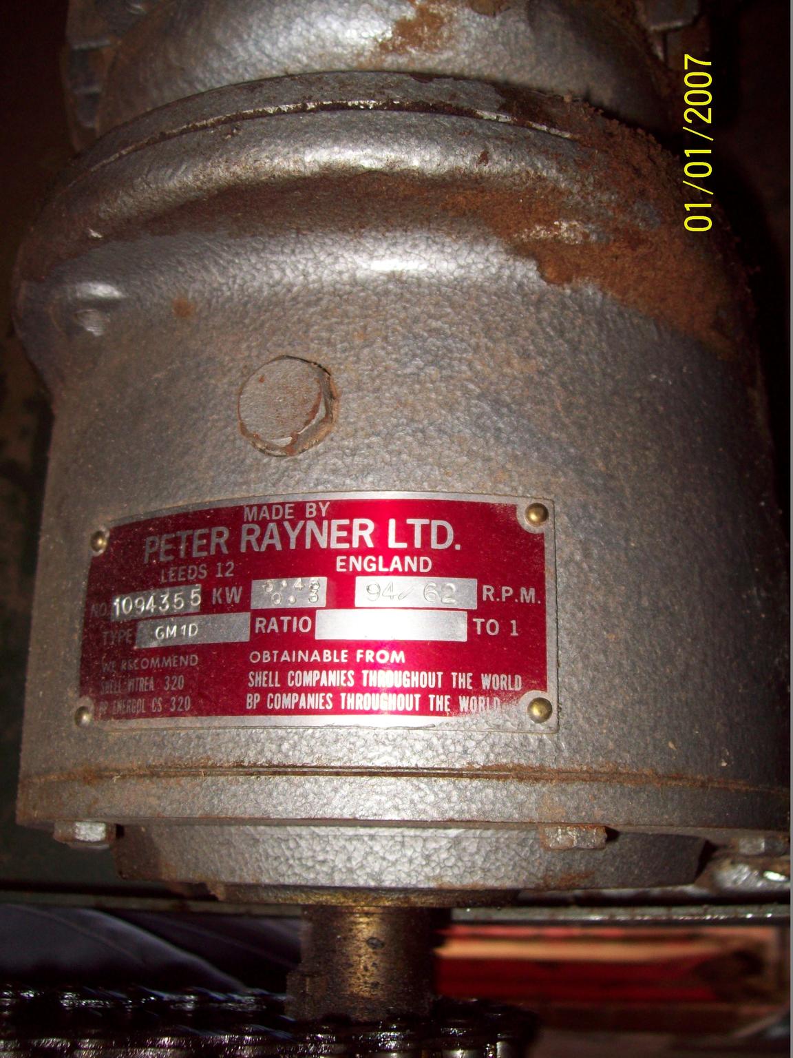

    Hello Guys,
    I am wanting to get my 3 phase planer working on single phase electric.
    1. As far as I know a there are 3 ways introducing a capacitor to the parent motor
    2. A 3 phase converter static, rotary or digital
    3. Change the motor for a 240v motor (I was thinking a 3HP or 4HP but have no idea really)
    I think I prefer the last option but am unsure what is best.
    I could mount a new motor but I would be lost on what motor I would need to buy, from where, and how to wire it all up etc
    If one or two of you guys can help it would be fantastic
    I want to be building my CNC still but nowhere near ready to start still saving up and get other jobs done before I start! As you will see the main motor the one with pulley drive the second via a chain
    Many thanks
    Steve

    It's a dual voltage motor so simply wire it Delta (240v on the motor plate) and use a 240v VFD.
    Job done ;-)

    VFD takes (in this case) 240V single-phase in and produces 240V 3-phase output. As Nick says, you are lucky to have a dual-voltage motor, so change connections to delta, buy a "cheap" VFD (maybe £150 new?) and plug in and go. It's a variable-frequency drive, but in this case you'll set it for 50 Hz output, fixed.

    Wiring is easy, LNG from your three pin plug into the VFD and T1, T2, T3 and Earth from VDF to motor, swap any two phase wires to the motor to reverse direction and get forward an reverse how you like it.
    If you go VFD try to buy one that has decent documentation, it makes a massive difference when you're getting something working,
