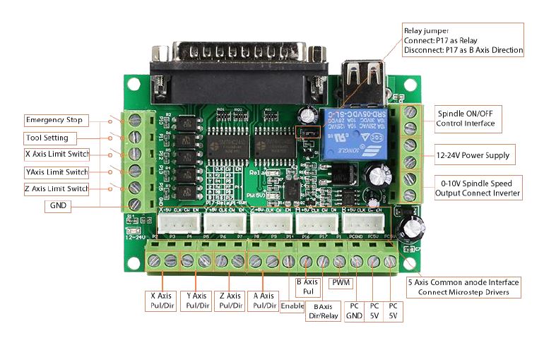

    I have decided that the board is duff, as after having a fiddle with it this morning, the spindle will turn on/off intermittently with nothing being changed.
    I have emailed the seller and am awaiting a response.

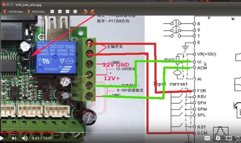

    Noddy how did you get the speed control working on this board?
    Mine turns on and off via the relay OK but I can't figure out how to get 0-10V out of it?

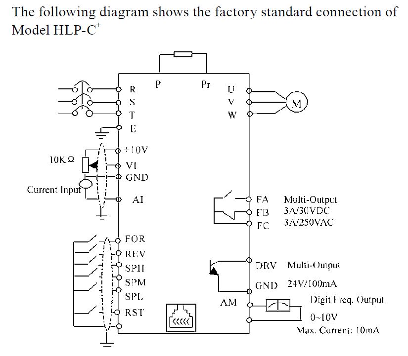

    I've set it up as shown in the manual with a potentiometer making a voltage divider. It works well which means I've got my VFD set up correctly to accept a -10V input.
Name:	HLPC wiring.JPG
    I don't understand how to get a 10V signal from the BOB though.
    I'm not measuring any voltage across the two "0-10V Spindle Speed Output Connector Inverter" pins.
    Do I need to feed it 10V from the VFD? Is the PWM port involved some how?
    Any help would be appreciated.

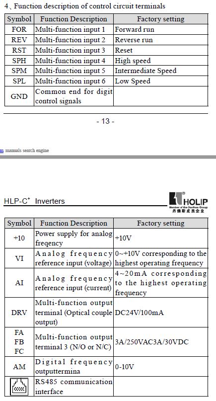

Name:	HLP Part Number.jpg
ID:	21744   Click image for larger version.

    Thanks Carl, I couldn't find nay info last time I looked.
    I tried and failed getting it to work with RS485.
    Works great now!
