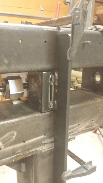

    Some updates on the gantry
    All of the bracing clamped in place ready for spot welding. The ballscrew is in place to set the distance between mounts.

    Here is one of ballscrew mounts

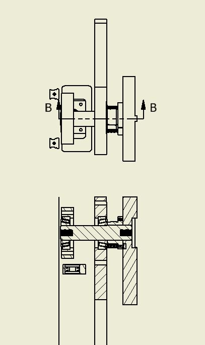

    Heres a view of the bottom of the Z axis and a section cut into it.
    **sorry the drawings are upside down**
    Here is the box tubing removed
    The bearings are roller bearings that I can get from McMaster Carr easily. 1 1/4 diameter shaft. Bearings are designed to be held into aluminum housings bolted into the 3 x6 steel tubing. The shaft is a 6 inch threaded on both ends. Again something I can just order from McMaster. The bolts into the shaft allow me to put preload into the bearings. I was thinking of bolting the pulley hub (pulley is not pictured) to the spindle mount.
    Open to thoughts on this design. I think it will work....
