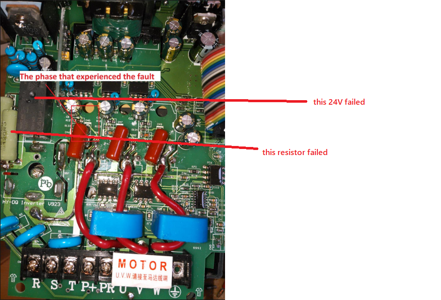

    The connection between earth and a damaged wire from the spindle created a short circuit. There was no smoke, the circuit breaker trips. I replaced the damaged wire and now I have the error A.oL and then E.oA.A. when I try to start the vfd.
    My setup is: 220v, 800w, 5A, 400HZ, water cooled spindle with a Huanyang VFD 1.5kw. The cable between vfd and spindle is 4 core 16awg shielded.
    The spindle seems to be ok. The resistance is 4.2Ohm between each pins (U,V,W not the earth).
    Visually the VFD is ok. When I run it witout the cable attached to the spindle there is no error. I tried also to reset settings and apply it again. My setting is:

    I really doubt that I can return it as the seller doesn't reply my messages. But I just checked the VFD and found a transistor exploded.

    This is the model number: kdg15n120h ( documentation)
    What do you think ? Is there a chance to save the VFD by replacing this transistor?
    Thanks for your help.
    You could try replacing the bit, they are cheap enough ($25 for 10 from China), but don't be surprised if the damage goes back a little deeper than that one component. For the cost of the bits, it is worth a punt. Check your circuit board tracks haven't been fried as well !
