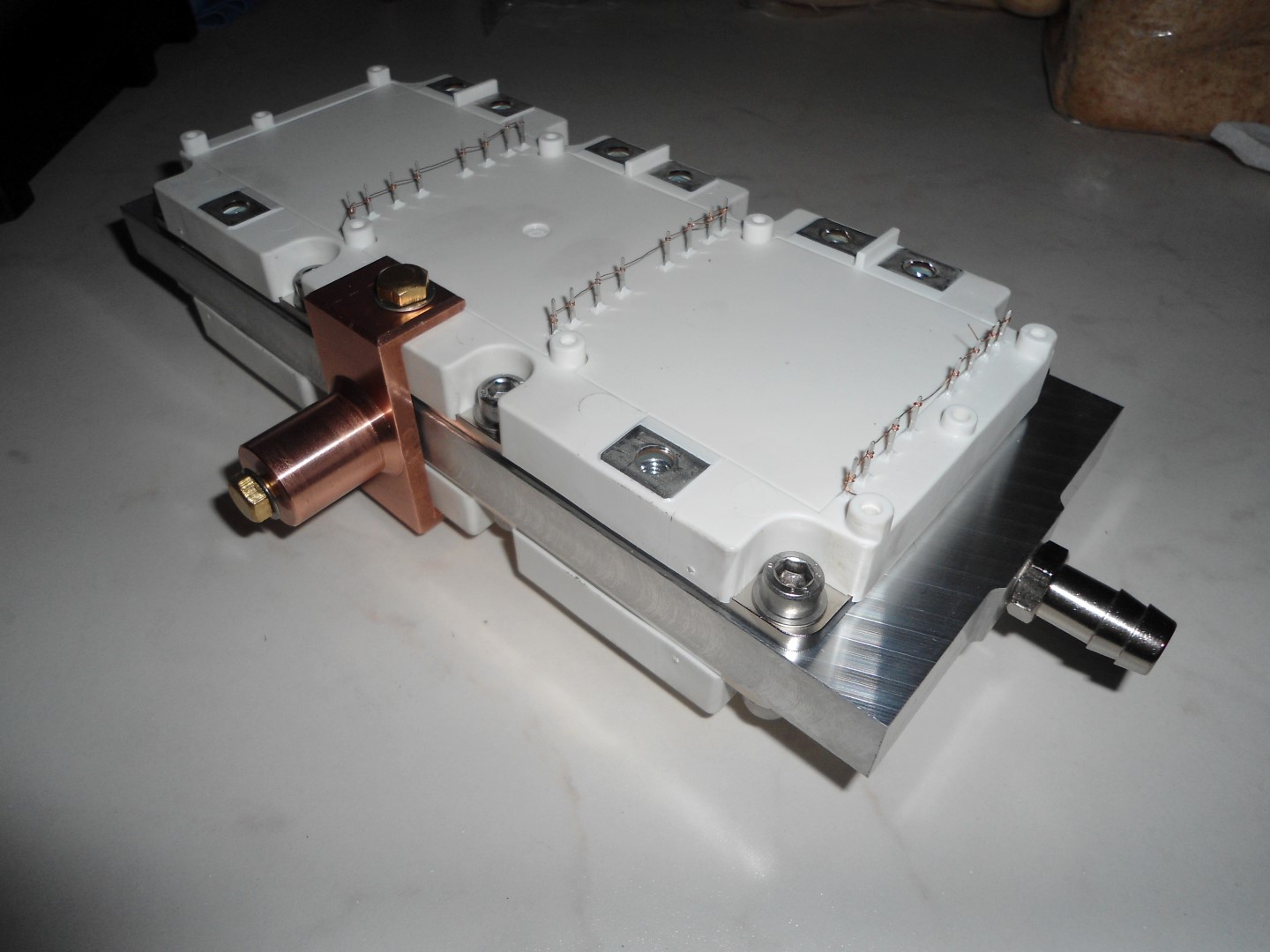

    It depends on the parameter. For a new design, you want the lowest values that affect the conduction and switching losses, so the forward voltage and switching time (related to gate charge) respectively. However when replacing a part you need to consider that the engineer will have matched the gate drive circuit to the particular IGBT, one would hope at least. Switching faster leads to more emi, so it's common to intentionally switch the devices more slowly (by increasing the gate series resistor) to reduce the emi to meet a specification. You could look at what gate resistors you have, versus the datasheet values - but bear in mind the datasheet isn't definitive. At best it's a good guideline, at worst it's a marketing document designed to make you buy the part.
    This sort of thing matters more with bigger devices, like these 900 Amp ones I've been playing with lately:
