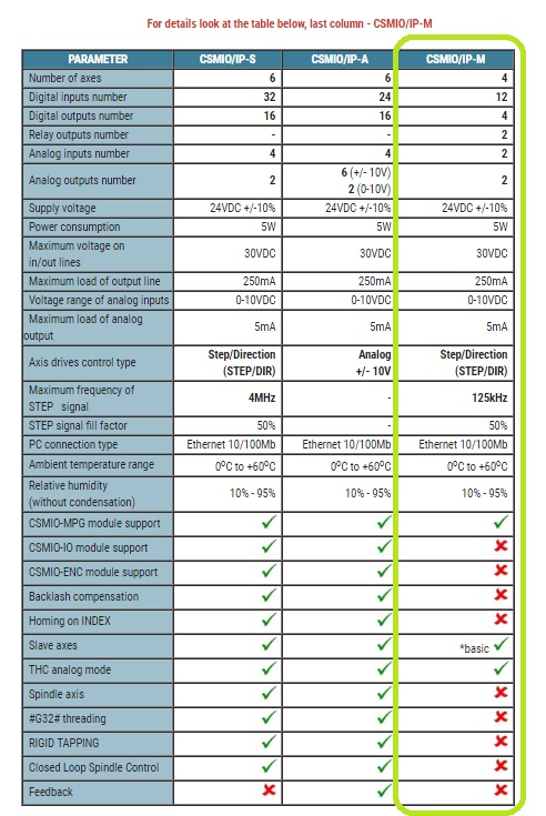

    i haven't compared the specs directly but for not a huge amount more you could have the CSMIO which also comes with direct pulse control and Ethernet unless I'm missing something.
    £400 plus ? ?
    John S -
    I was thinking of the CSMIO/IP-M at 229 EU (£198)
    http://www.cs-lab.eu/en/produkt-18,2...onnectors.html
    I might not be comparing like for like so here is the overview (last column):
